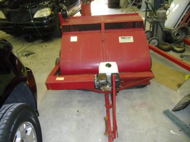

I just got a deal on a Smyth 52TB sweeper :D Found it on the local Craigslist. I wrote to the maker in Canada and this particular model is now discontinued but sold for over $4500 new. I got it for $600 delivered. I guess we all get lucky every now and then. I just need to lube it up and makeup a power cable for the electric dump option.
