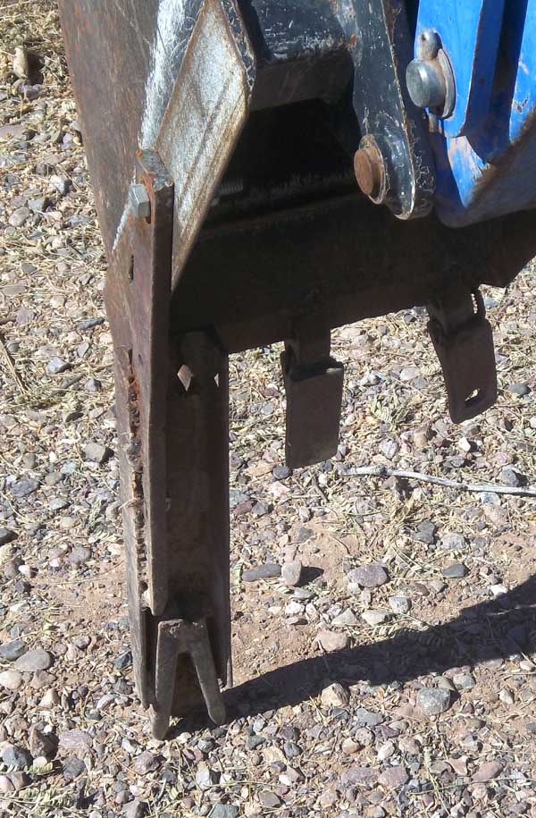

Down here in TN, anything underground means underrock. Here's what was needed for laying in my water line....
   / Laying Water pipe #8
yeiks.....and i thought i had it bad.

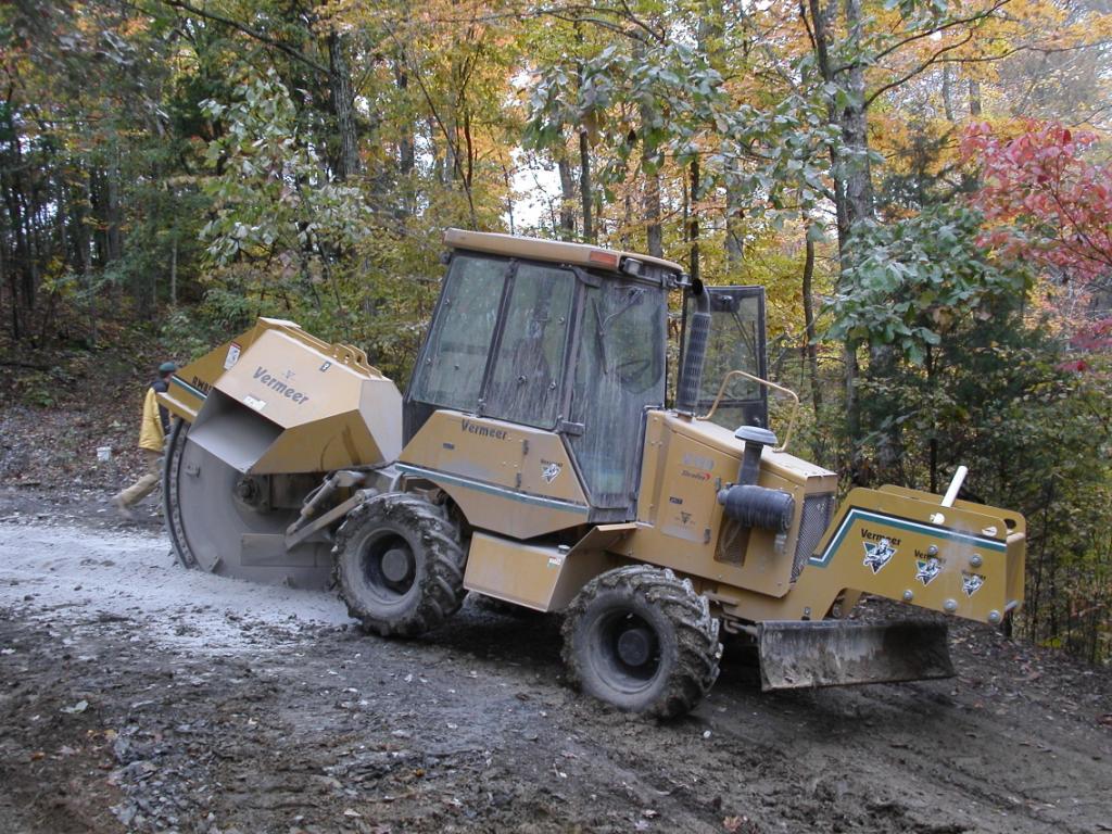

We bury our 1" line with a "ground saw" It cuts a 2" wide trench up to 13" deep and piles the lose dirt next to the ditch. If you have any roots to go through, the saw cuts them also.

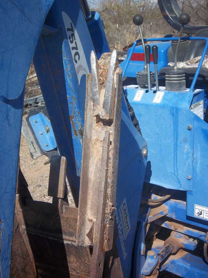

I use a home made "Pickle fork", easy to make could be used on a front end loader. I use mine on a back hoe. Its good for a little over 12" and it will work in rocks & cut roots if not too large. Yours could be made a little longer if need be.

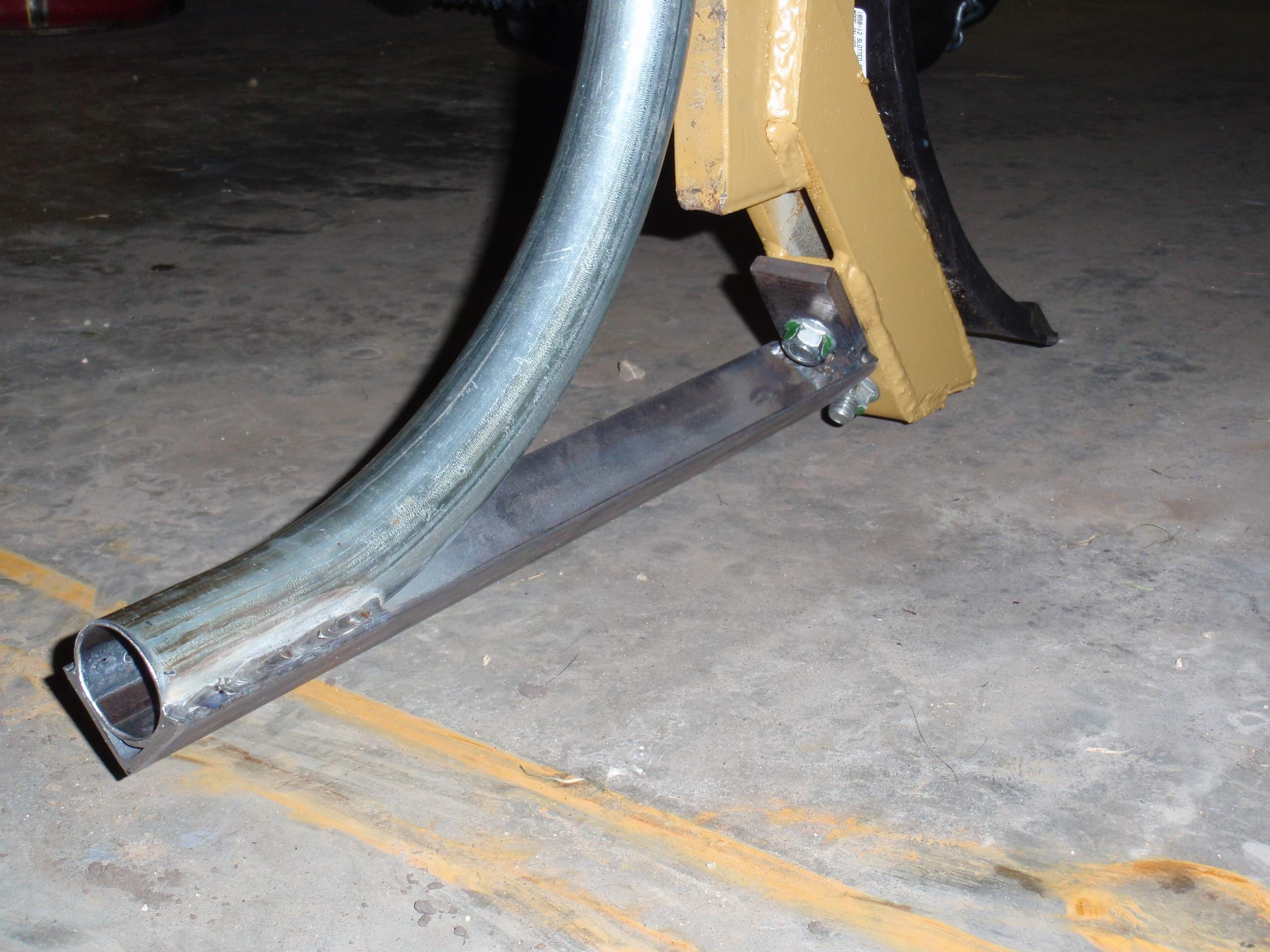

I used a pipe bender to make an attachment for continuous trenching with a subsoiler. It worked great for my 600' line to a field hydrant. I used 100psi 1" coil pipe and I get good flow to the hydrant. We put the sections of pipe together with the hose barb style couplings and ran them thru the subsoiler, then put the hose clamps on in the trench. I made a dry run cutting along the path to help the depth and make sure there were no surprises before I laid the pipe. The pics are of a borrowed subsoiler but I have also bolted the same attachment to a KK subsoiler with similar results. I put some Yellow 77 in the funnel to lube the pipe.

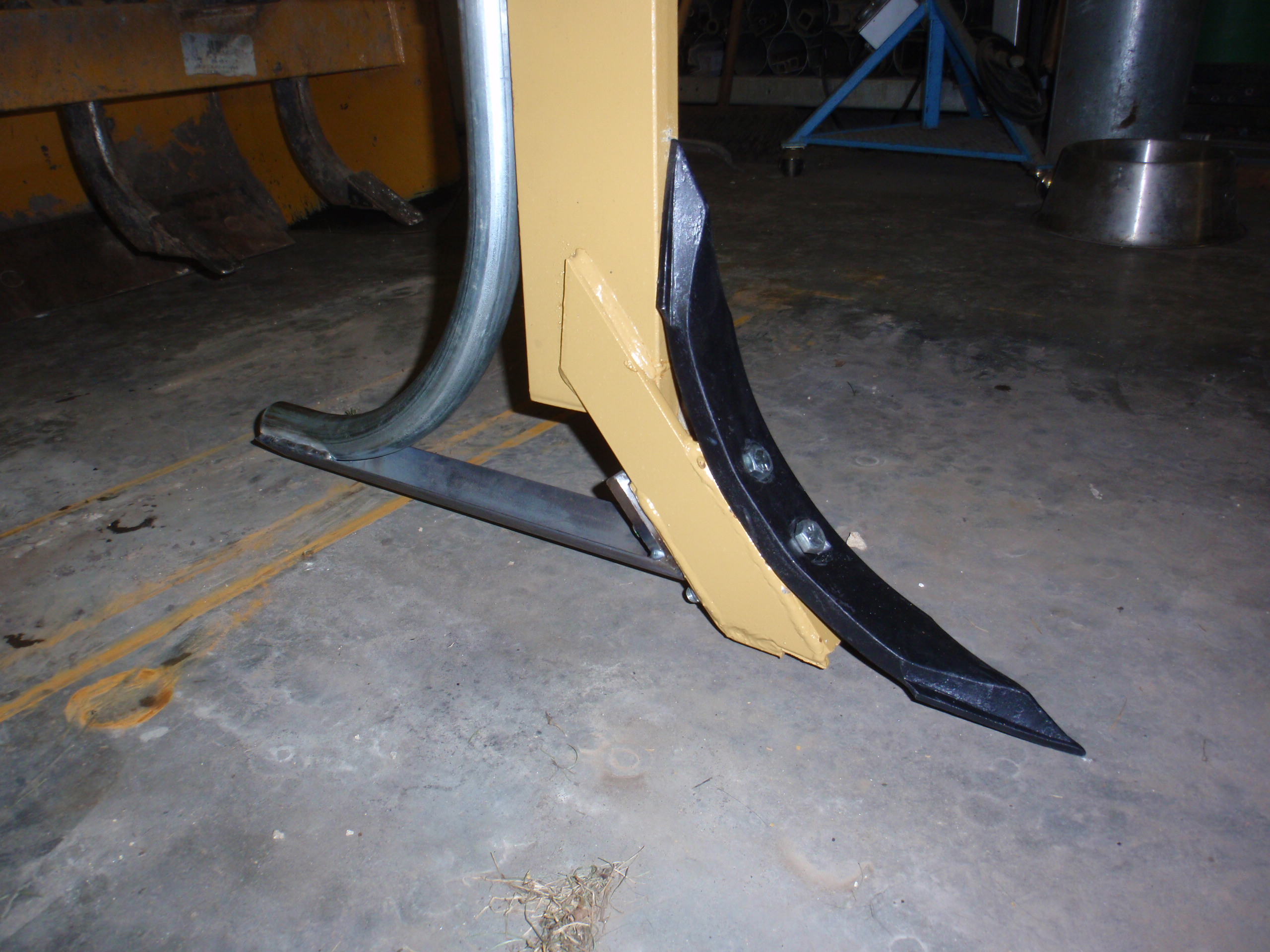

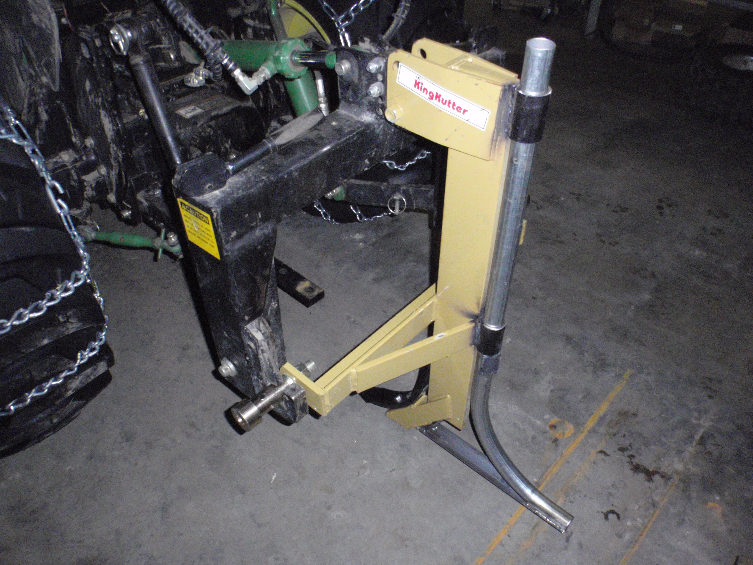

I built this. Haven't tried it yet. It started out life as a KK middlebuster. I added the tooth, and conduit, etc.
