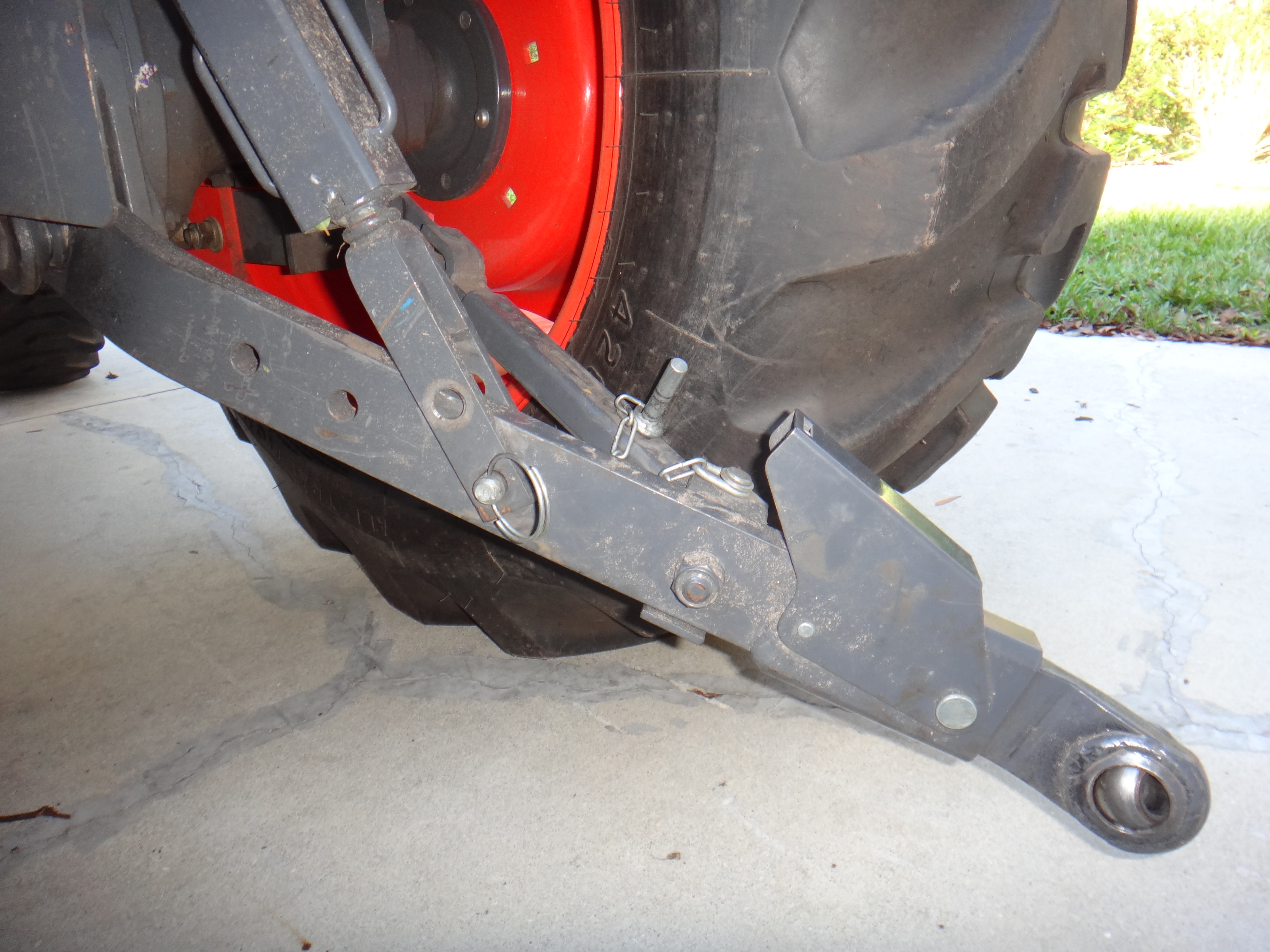

The BX series lacks the adjustment holes in the right and left Lifting Rod stirrups, which allow both a Box Blade and Landscape Rack to drop down an additional 3" to 5". These supplemental adjustment points phase in on the Kubota L series.
My first suggestion is to buy a Kubota 'L'.
My second suggestion is to buy a Ratchet Rake bucket attachment from the TBN store. This bucket attachment is useful whenever you would use a Box Blade or a Landscape Rake. Use the Ratchet Rake as optional implement weight when desired, secured with a couple ratchet straps or industrial strength cable ties. A 52" Ratchet Rake weighs 65 pounds.
Adding weight to BX implements only helps "some", because of the limits of the BX Three Point Hitch.
Kubota L3560 photos:
#1 Standard position for Lower Link, stirrup pin in UPPER adjustment hole. Note Lower Link angle.
#2 Optional position for Lower Link, stirrup pin in LOWER adjustment hole. Note Lower Link drop.
