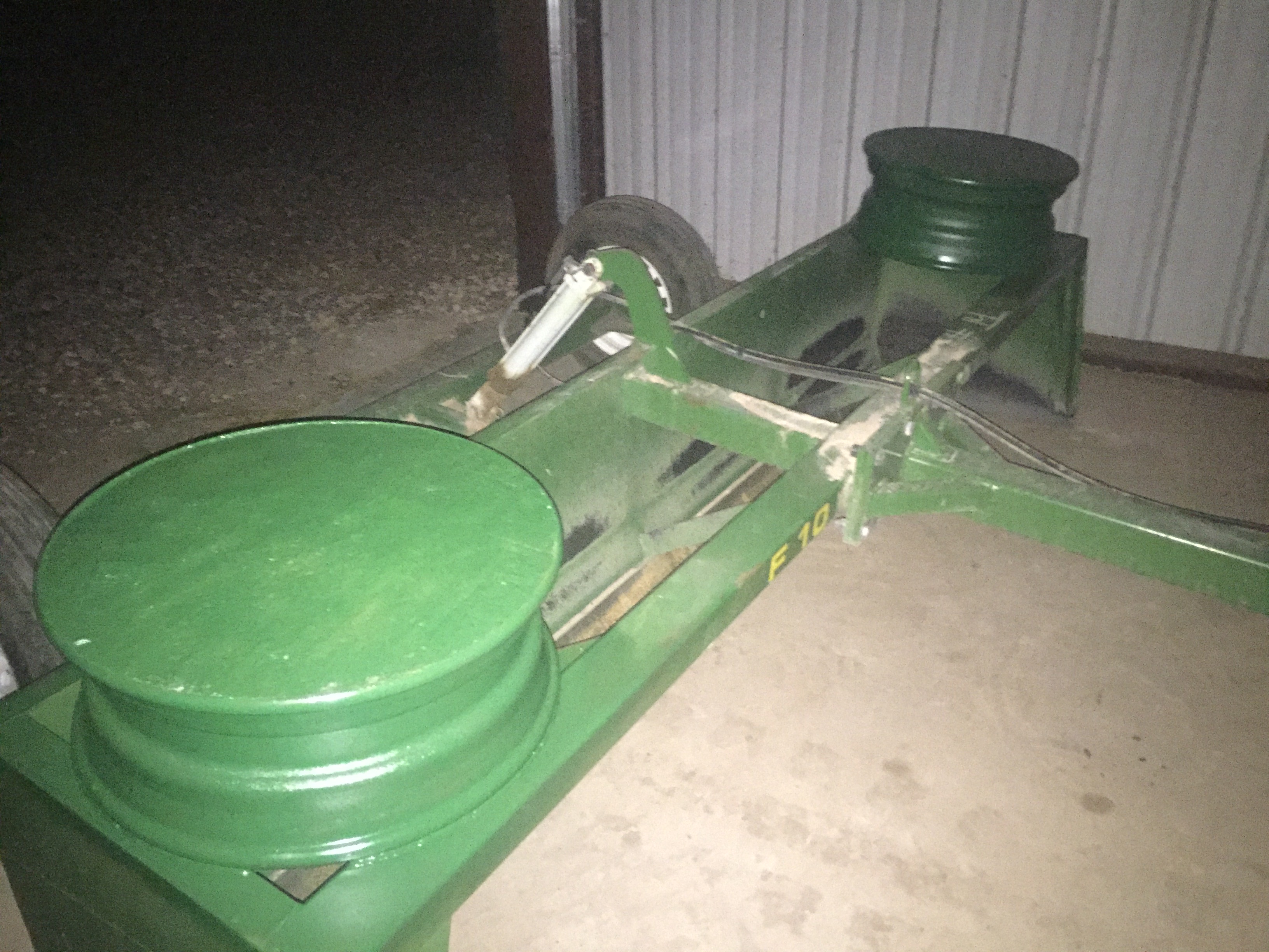

   / Lead shot to add weight to implements? #24
Here are the concrete wheel weights I added to my blade.

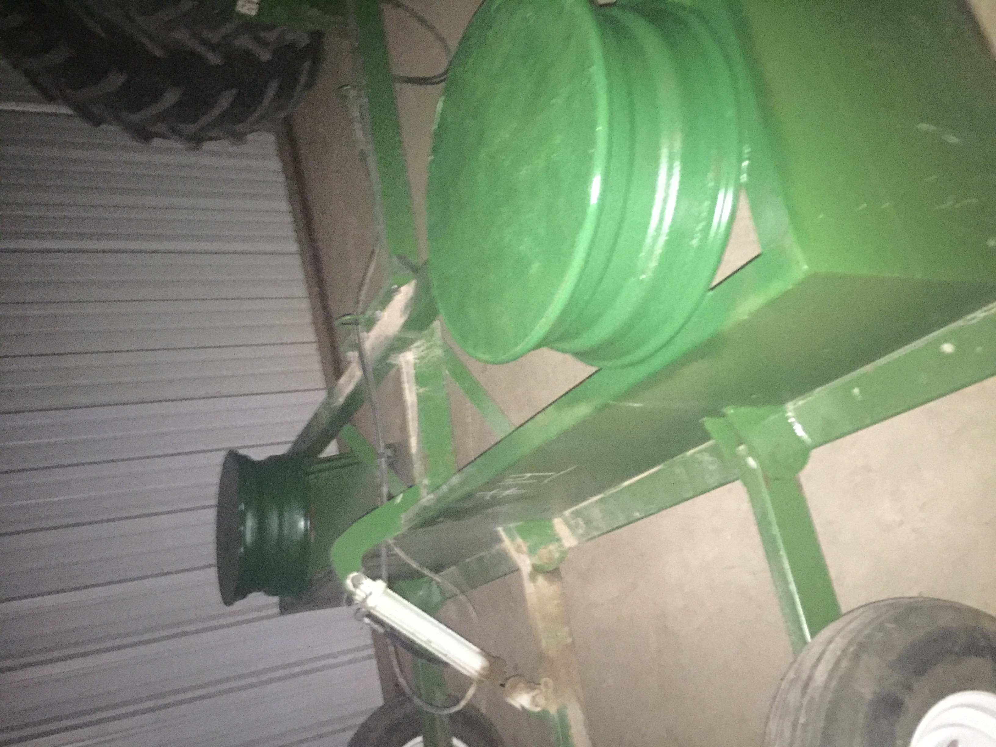

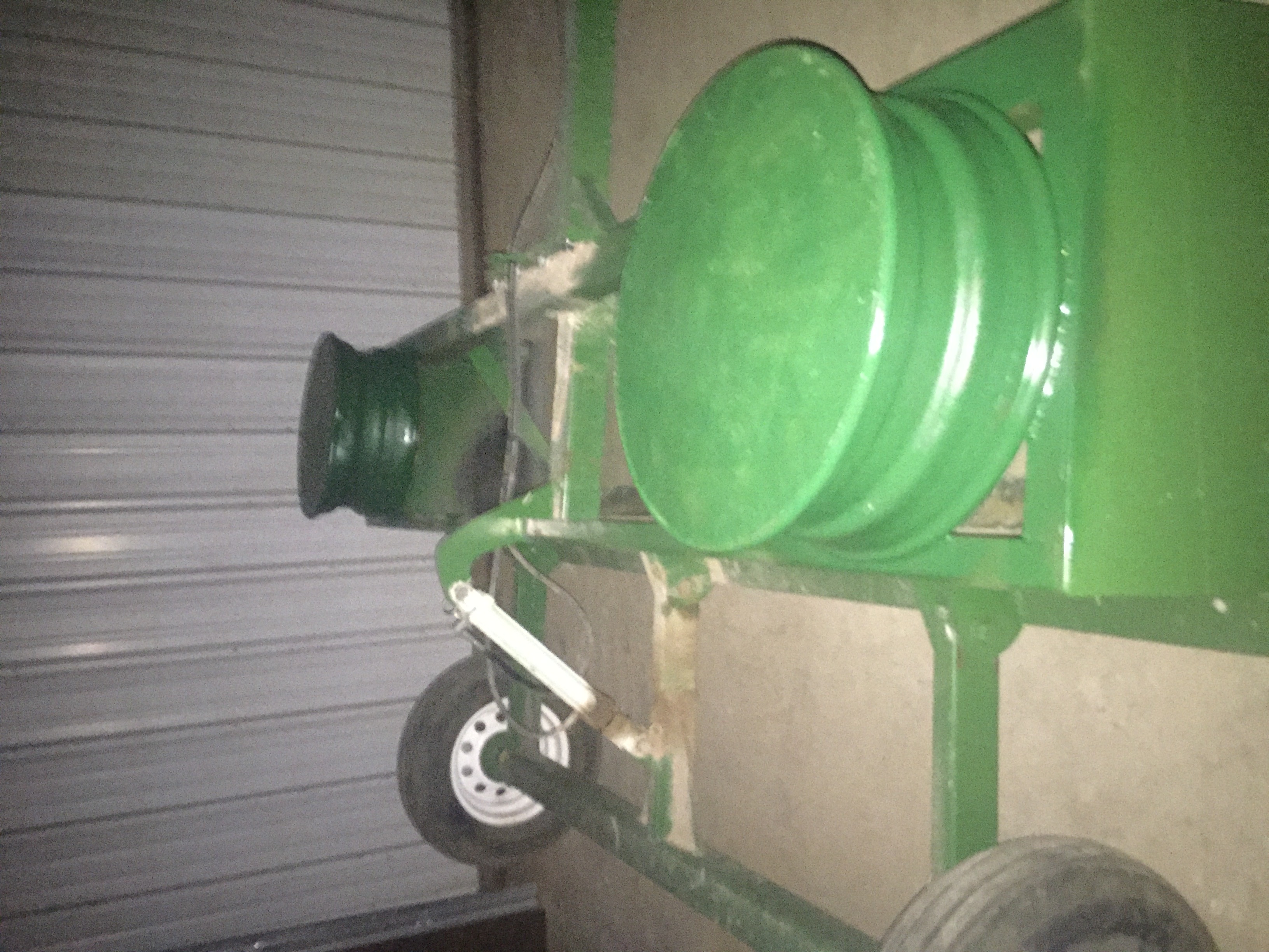

   / Lead shot to add weight to implements? #25
Couple more pics.
