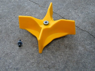

Last year I talked with the CR folks about the differences in the impeller on the standard unit vs. the commercial unit. They informed me that currently they are both the same. As I understand it the 2 impellers differed initially, but now they are using the same for both. I purchased one to try in my vac system even though it is not a CR. It was about $45 and is all composite material except for the inner portion of the hub that attaches to the engine shaft. I have not actually run it.

That is very interesting to note. Does that mean both units use the same impeller/power unit or do they still make two different sized blowers/impellers?
Could you provide the dimensions of the impeller (dia, width, hub shaft dia, length, keyway) ? I would be interested in trying one out as well.

As I understand it, both units use a common impeller. The dimensional data is:
Overall Diameter = 13 7/8 inches
Overall Width of Impeller = 4 1/2 inches
Steel hub extends an additional 1/2 inch beyond impeller back
Hub hole diameter = 1 inch
Keyway = 7/32 inch (not accessible from outside)
The key goes in first, the impeller is slid onto the engine shaft and is secured by a 3/8 SAE bolt 2 1/8 inches long. A 1 3/16 inch chrome plated washer 1/4 inch thick is used also.
I'm fairly confident that this impeller was designed to be used on virtually any engine that has an inch diameter shaft and is drilled in the end to accept a 3/8 inch SAE bolt.
As I said before, I haven't actually installed it yet--I will use it as a backup if I should have an accident and ruin my current steel impeller.
See attached photo here and in the reply.
JackIL
