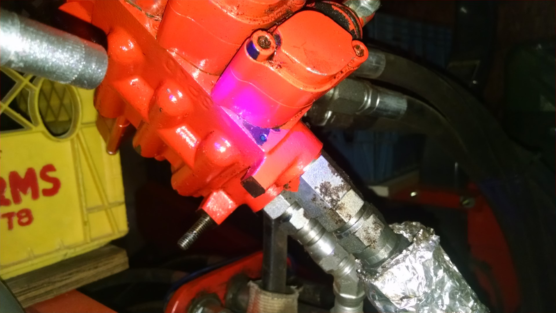

Found the Leaks!
The good news: It doesn't appear to be coming from a cracked housing or casting.
The bad news: Multiple leaks from different sources.
The dye worked great! I put in 3 oz in a 11.4 gallon system (requirements = 1oz/gallon) and it still worked great. I removed the valve from it's mount and hung it from the ROPS so I could clearly see the bottom. Started the tractor and warmed it up. After a couple minutes, I started cycling the 3ph with the EA land leveler (+750lbs) to get some pressure on the system. Nothing.
I then cycled the top link valve spool - nothing. I then cycled the tilt valve and the 3rd unused valve - leaks.
Here are two pics:

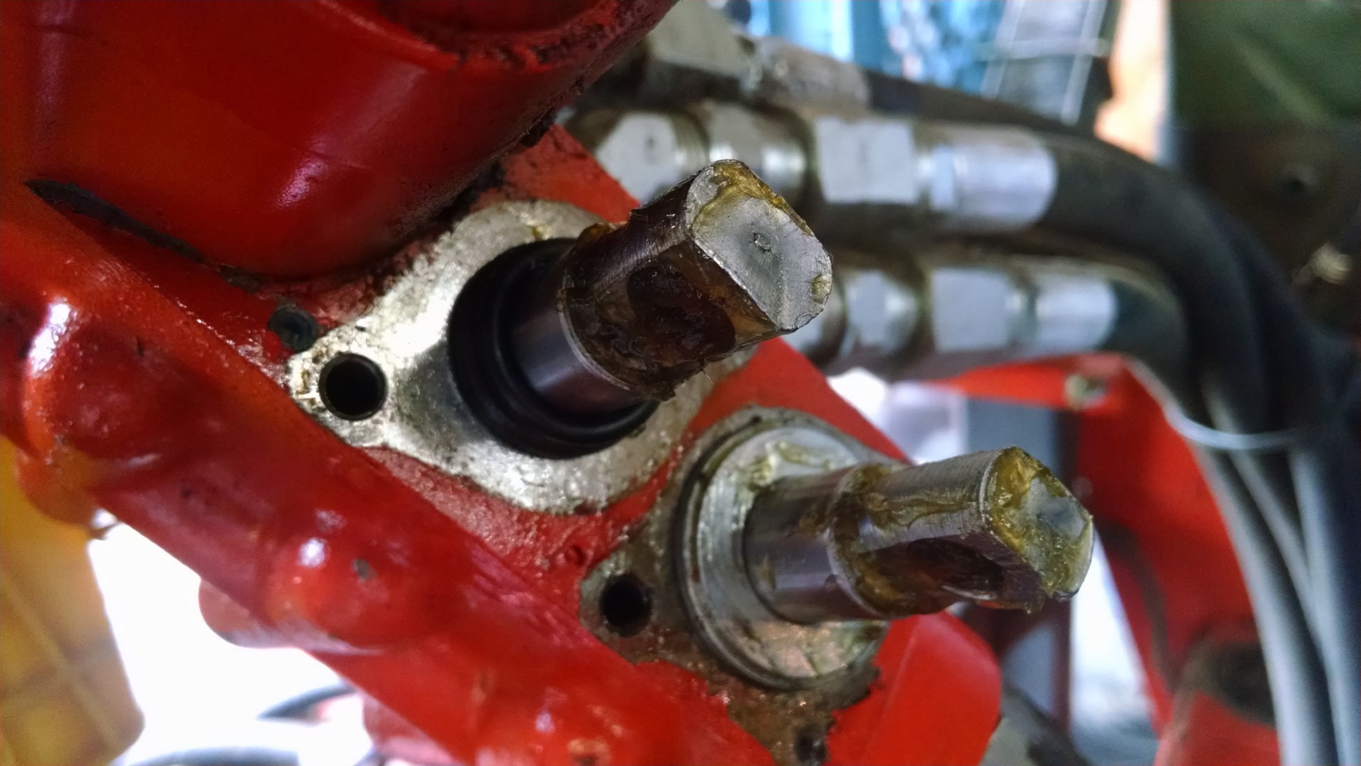

The leaks are coming from:
- The little black hole to the lower right of the 3rd valve spool (dead center of the first pic)
- The base of the 3rd spool (rightmost spool)
- The base of the 2nd (middle) valve spool
- The little hole at the lower right of the 1st valve (leftmost) spool barely visible under the paint.
I *assume* the little holes are hex head internal plugs? Perhaps as simple as removing, cleaning and adding sealant, then rethreading and tightening in the holes?
The spool bases: Are those sealed by the o-rings mentioned by the Bailey's Hydraulics guy?
Recommendations and suggestions for fixing?
Thanks!

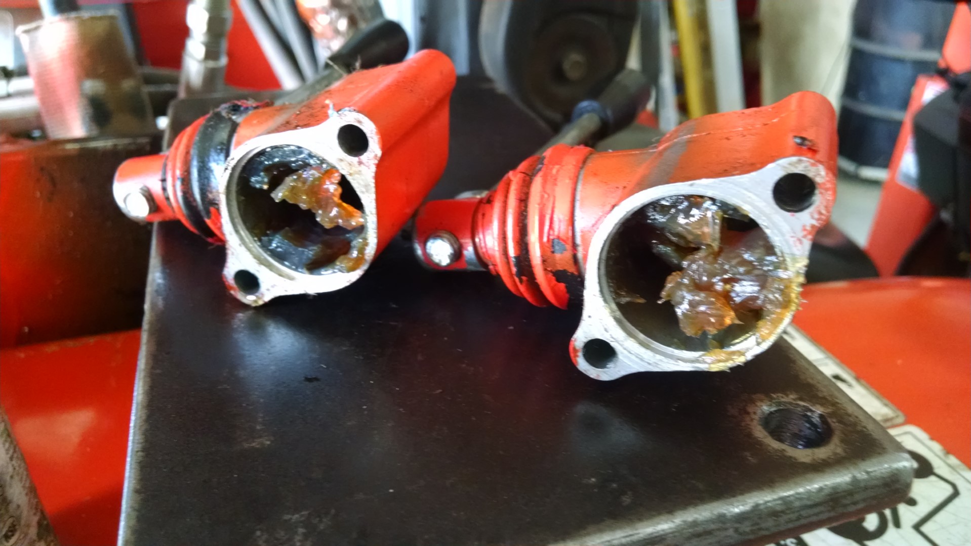

I took the covers off of spool #3 and #2 at the one end where the valve was leaking. No o-rings to be found. :(
IMG_20200603_154947965 (Large).jpgIMG_20200603_154935331 (Large).jpgIMG_20200603_154929380 (Large).jpg
Since those covers are just metal-to-metal contact with no provisions for sealing; the failed sealing must be at the other end of the valve spool. However, I'm not willing to go any further without some guidance.
The replacement o-rings I have from McMaster (208-Viton ID = 5/8") fit snugly over the shaft, so it looks like I have the correct o-rings.
What say the experts?
   / Leaking Chief/Bailey's 3 spool valve - how hard to fix? #15
Pull those washers out. The O-rings are hidden underneath that.
EDIT: Same applies for the opposite end of the spool.

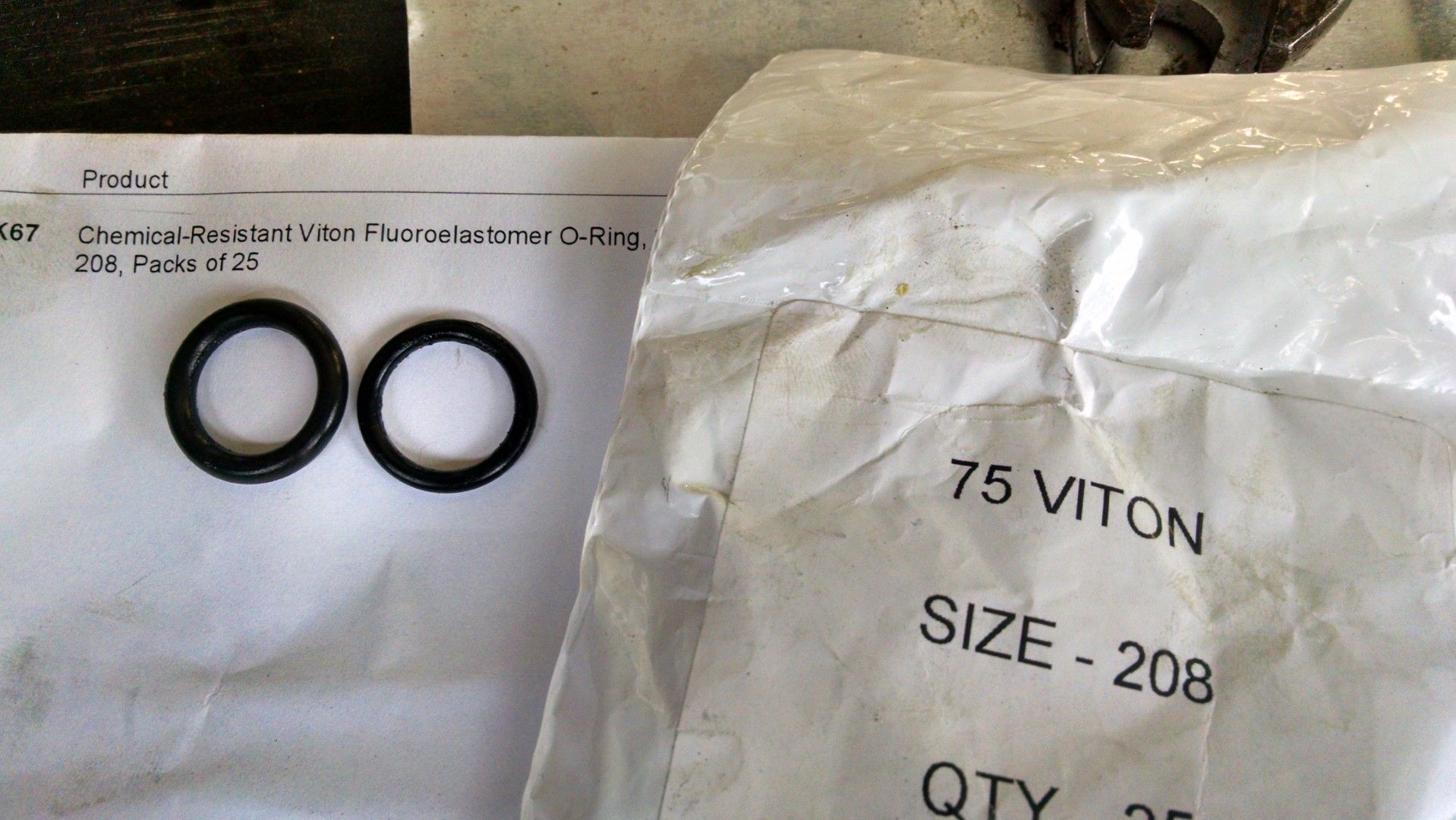

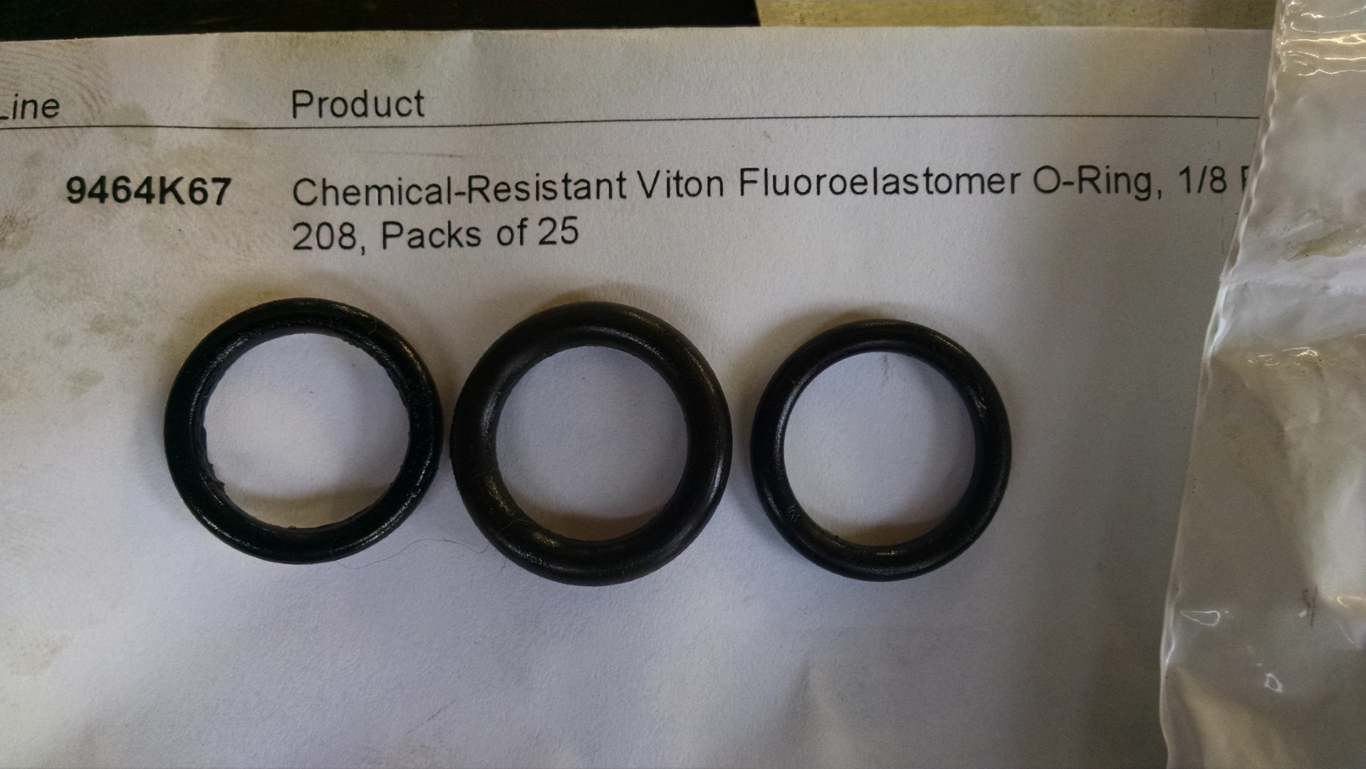

Now, the next issue: The o-rings that came out of the tractor vs. the ones McMaster sent me were both supposed to be size 208 (ID 5/8, OD 7/8). But they're not the same.
Smaller version is what came out of the valve; larger from McMaster.
IMG_20200603_171448246 (Large).jpgIMG_20200603_171246900 (Large).jpgIMG_20200603_171241117_HDR (Large).jpgIMG_20200603_171034165 (Large).jpgIMG_20200603_171027050 (Large).jpg
I *assume* there is no way that larger o-ring is going to shrink that much into it's assigned space, no matter how much I try to force it.
The good news: Once I go to town and get the right sized o-rings, this should be easy to put back together and hopefully it fixed my leak problems.
Thanks!
   / Leaking Chief/Bailey's 3 spool valve - how hard to fix? #19
Yes, that's the wrong cross section size. No way you could jam that in place.
On the other hand the old O-ring looks fine from what I can tell from the pictures.

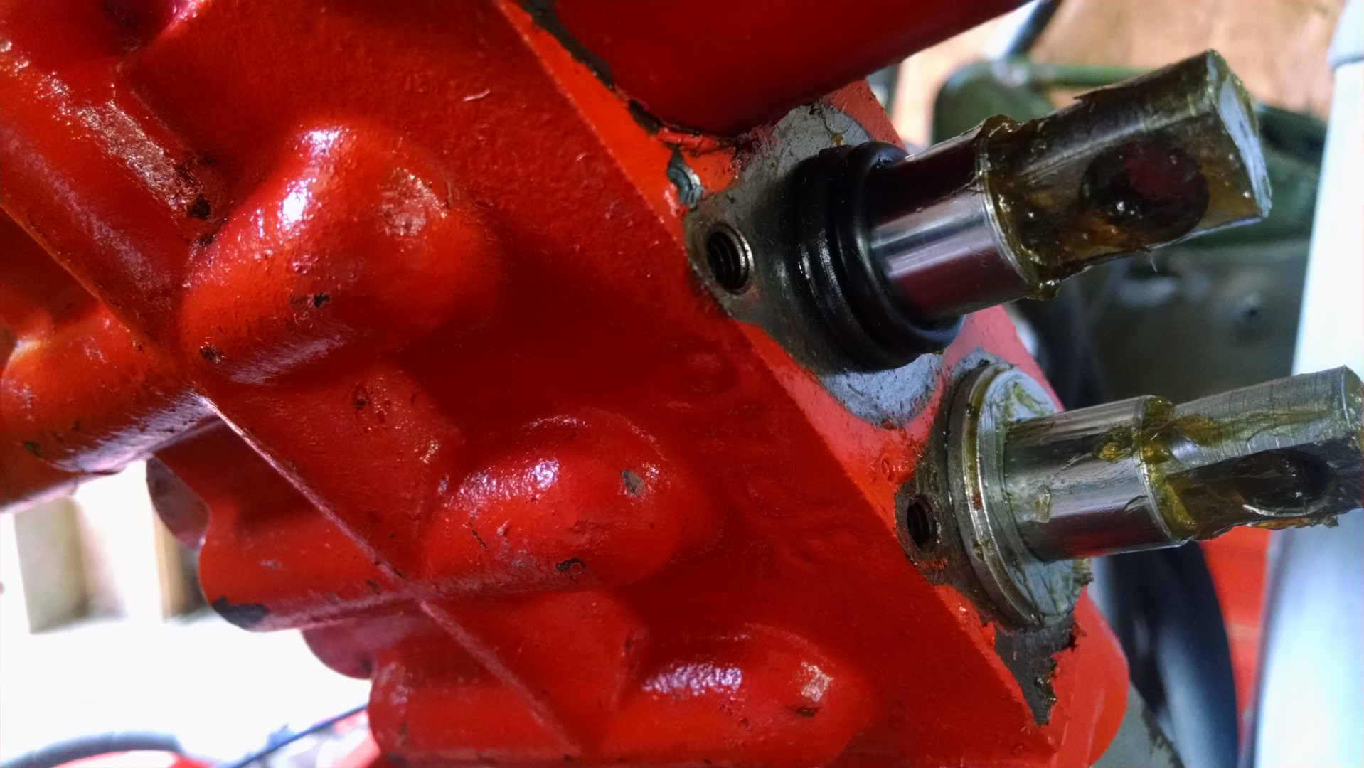

So ended going to three stores (O'Reillys, Autozone and Kings Hardware) to find some o-rings. The hardware store had the best selection. Bought two (all they had) #12 o-rings. Slightly smaller than the OEM valve rings, but thicker, like the McMaster rings; they were the closest size they had.
Installed them and the leaks have been reduced quite a bit. I haven't had a chance to really get the tractor hot yet though, so we'll see.
