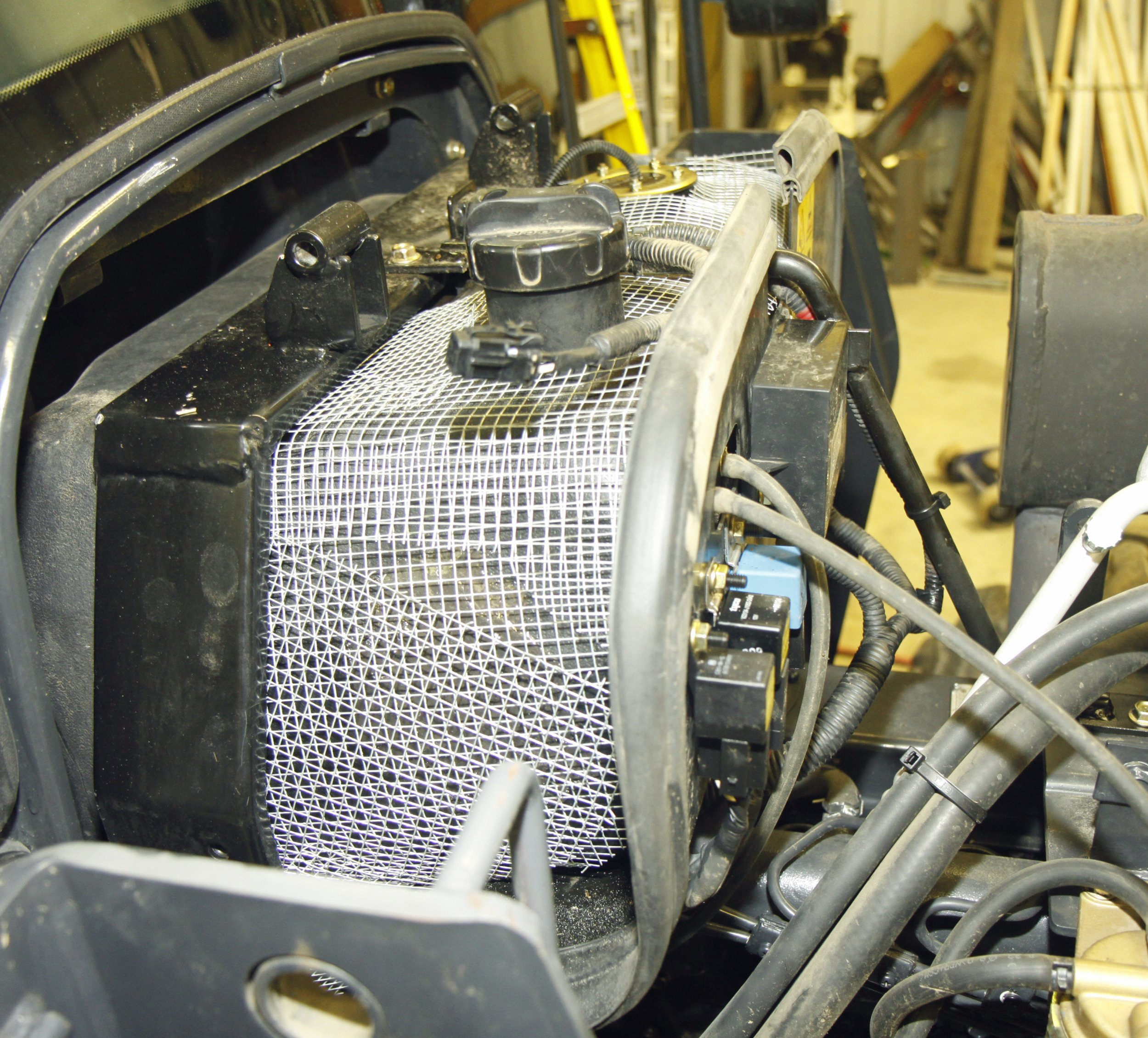

Its been a while sense I posted anything. I have about 680 hours on my TYM t353 and had to replace control module at around 400 hours my 2nd problem is leaking fuel tank has anyone else have problems this problem. Tractor has done a great job!
Ron
/ Leaking Fuel Tank #2
Your going to have to isolate the leak. Is it a plastic or metal tank? I had a leak on my plastic tank many years ago. Turned out some critter had chewed a hole thru the tank. You could see the teeth marks. I ended up repairing it with jbweld and surrounded tank with 1/4” steel mesh.
/ Leaking Fuel Tank
It is a plastic tank
/ Leaking Fuel Tank #4
some rodent chewed hole in mine

Mt TYM/cabelas 27hp had cracks around top gauge attachment where it was improperly sonic welded. Would leak if over 5 gallons was added. Cabelas replaced just before shutting down
