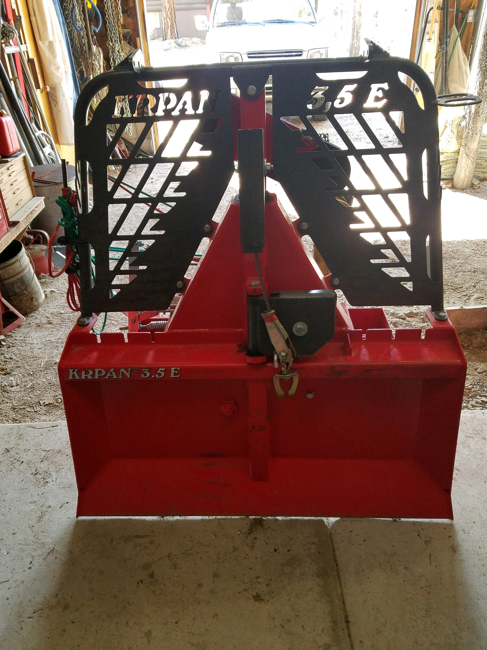

Slightly new topic: I have new Mahindra 5155 arriving next week to replace my 4550. I use it mostly for three thinning for fire protection and for firewood. Have received a new KRPAN logging winch very similar to the one I had for my 4550 but stronger. The old one is in the photos below to help with my question (it is no longer needed and is available).
Getting to the question: I am considering putting in a hydraulic top link controlled by the rear remotes but am concerned that it will extend by itself when the ~10,000 lb max pull of the logging winch goes mostly on the top link which is just below the chainsaw scabbard. Would appreciate any thoughts on that and what I could do to minimize that.
Thank you.

Top link with a pilot operated check valve will help keep the cylinder from drifting, also isolate any pressure spikes from the control valve.
