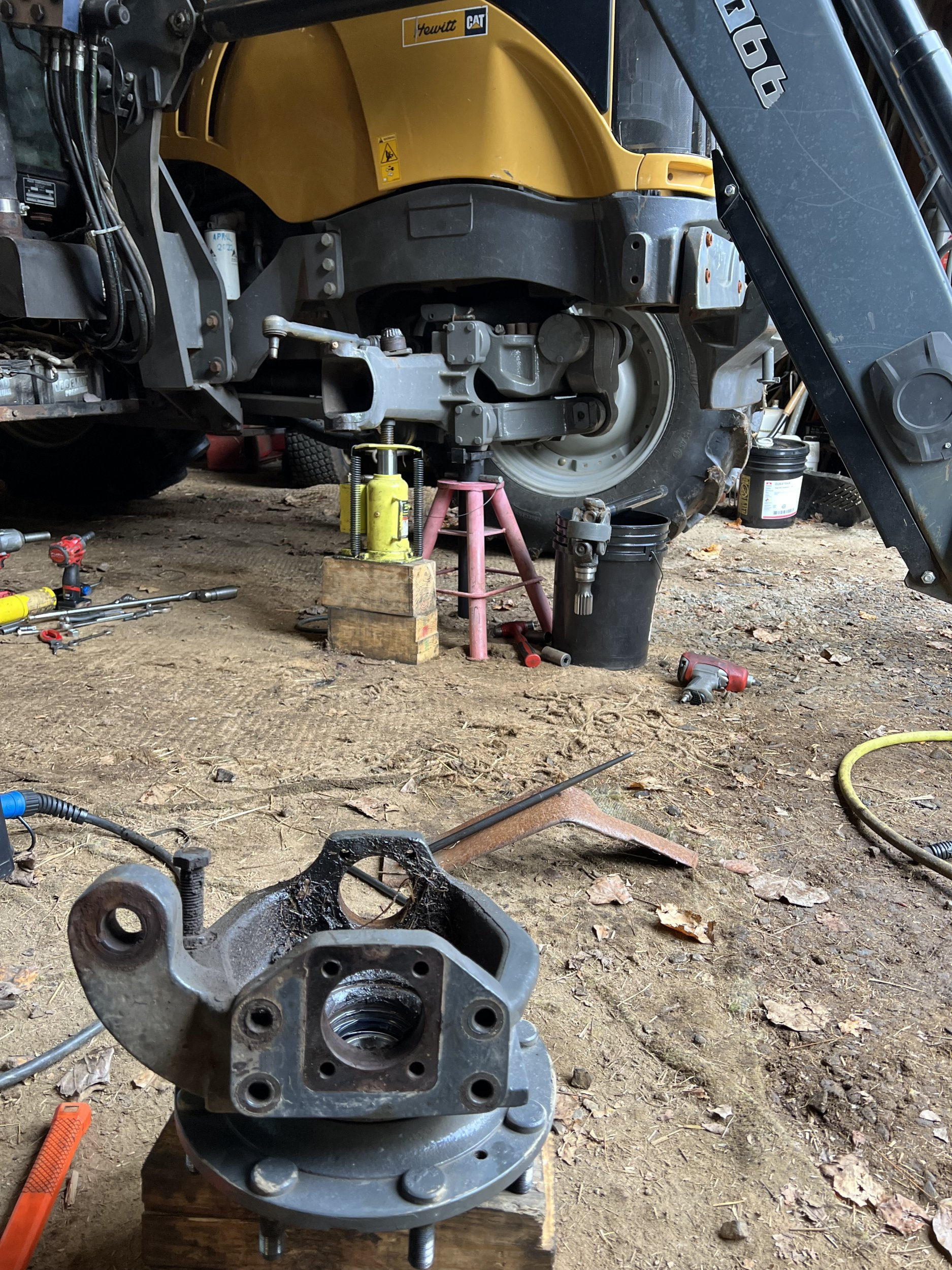

Leaks in general are the bane of my equipment owning existence. One axle seal drip can be VERY costly or time consuming (or both) to fix.
This one took a long time and the seals were not cheap, either. Getting king pin out was a real joy.
