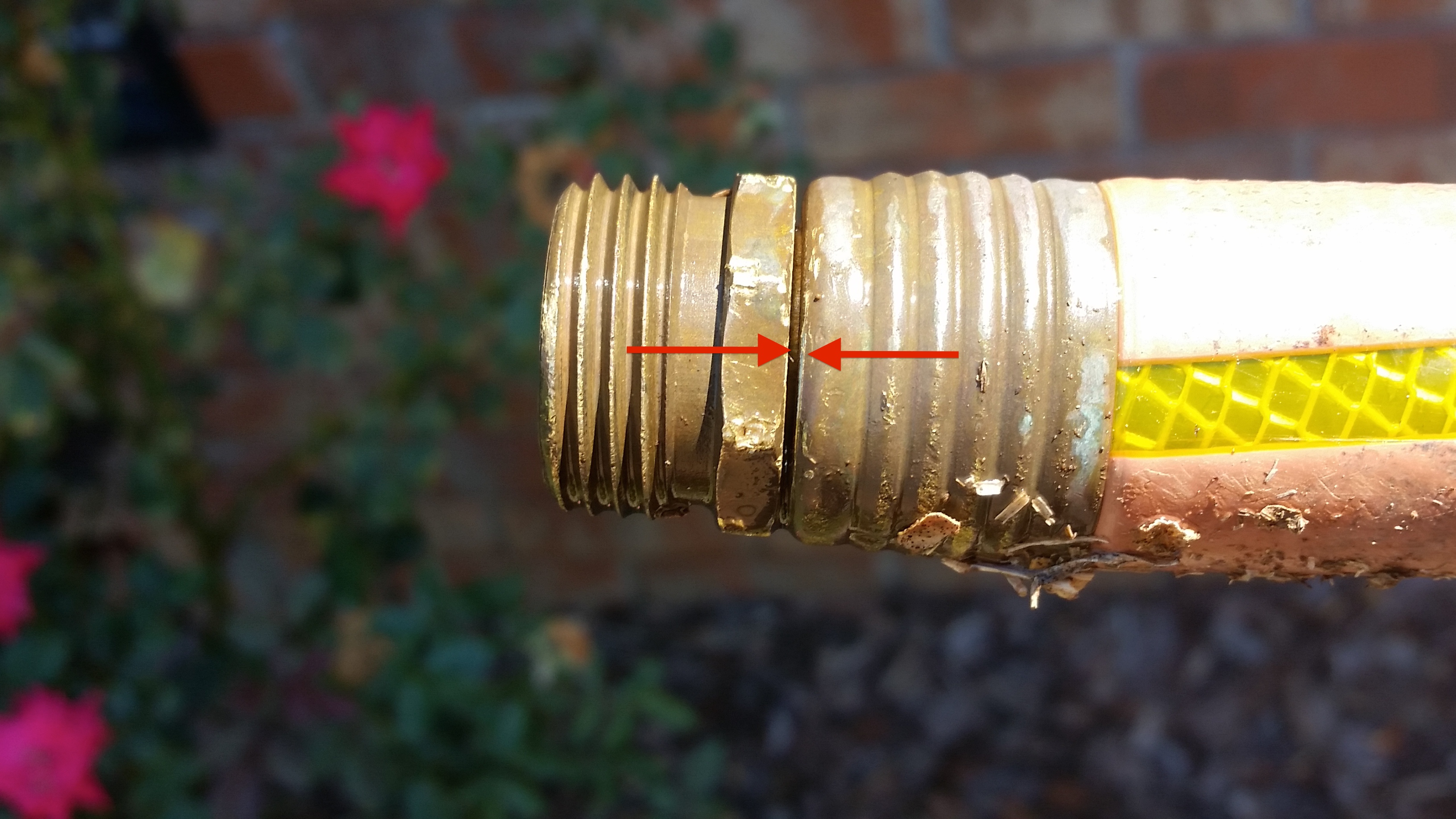

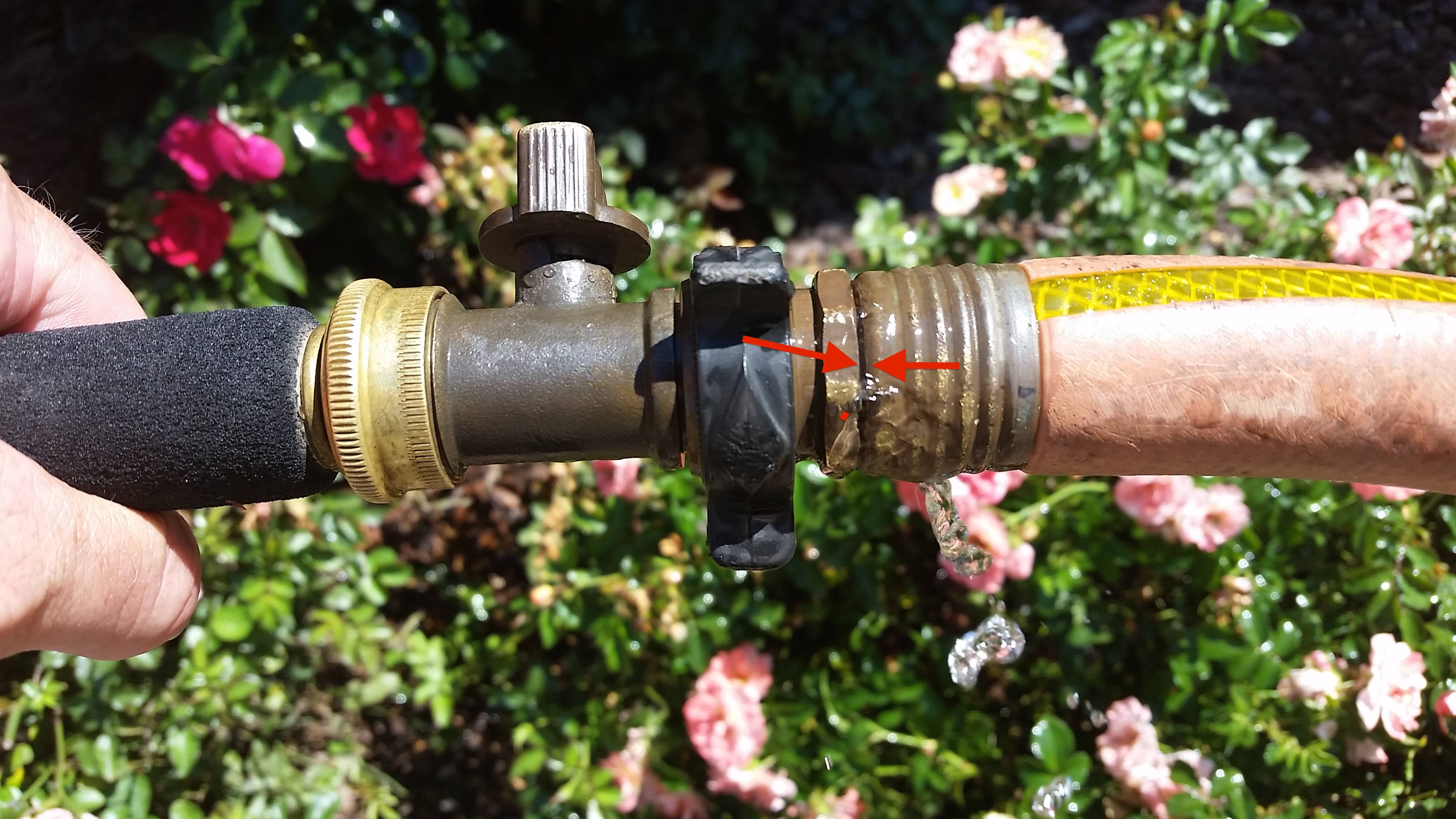

Is there ANY WAY to fix this? I twisted on the nut to no avail. Some times it gets worse, sometimes nothing changes. One thing it does not do is fix the leak. :laughing:
Look, I know lots of people have lots of real problems but if there is a way where I could put water on the beds without filling my shoes with water, that'd be great. :thumbsup:
In the past I've used lots of menders with varying degrees of success. I use 3/4" hoses. I've used these before httphttps://www.amazon.com/SOLID-Garden-Repair-Mender-Stainless/dp/B01M0Y1ZPW/ref=redir_mobile_desktop?_encoding=UTF8&dpID=61-S4NLhUQL&dpPl=1&psc=1&refRID=74HPCCMCWYR4P7989WBB&ref_=pd_aw_sim_86_1 and they work OK. The main problem I have with this mender is the nut on the hose clamp. It happily will shred your hand while using the hose. As I age, this will just get worse!
The plastic kind with a screw on each end, simply don't last.
OK, so this is the part where someone tells me of a magical fix for my hose. Bang it with a mini sledge? Weld it?
Does anyone have a recommendation for menders for 3/4" hose?
Forgot, here are the pics.. The arrows show where the leak is from.

These work better than the metal ones you crimp on and I only use the Gilmore ones, they come in other sizes as well.
Amazon.com : Gilmour Metal Male End Hose Mender 5/8in - 3/4in : Garden Hose Parts : Garden & Outdoor
Ritothebull, thanks for the tip. I don't know if I've used that connector before but in the past when a mender says it works on 5/8 and 3/4, the collar does not fully seat on the hose. I did see where people mentioned using hot water, I'll give it a shot. Someone else said that you can clamp the couplings together to seat the screws.
Have you used this on a 3/4 hose?

I have used them and their nylon ones as well, sometimes it may take a bit of work to strech the hose over them, if you put it in a vise than it's easier to push the hose on.
   / Leaky male hose end #9
Heat the end of the hose to be replaced in hot, hot water, it will go on.
