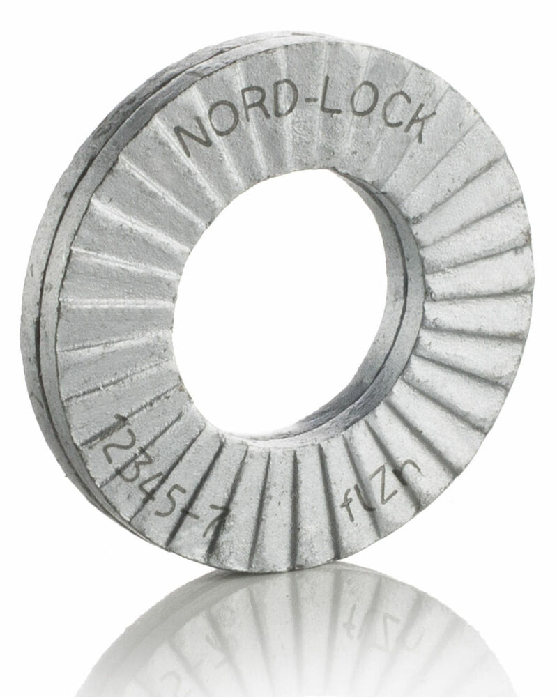

365ft-lbs. Yes. I finger tighten till snug, then hit the lug bolts with the impact on setting-1. Work my way in criss-cross fashion. Then hit them on setting-2 likewise. This gets it very close to that range.
IF these are not tightened enough, over time, they loosen and fall off. I wonder why I know about this? LOL. And they are not any certain bolt either. They are metric lug bolts. To keep them from coming off so easy as 365ft-lbs is a chore to reach, I improvised using Nord-Lock washers just under the bolt heads. This is like using lock-tite. ;)
