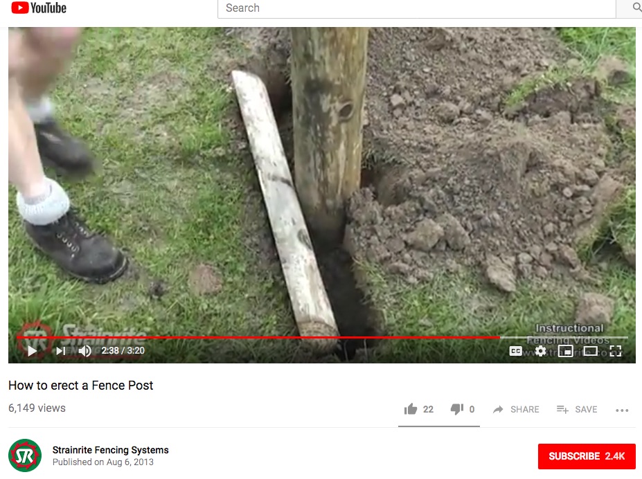

Maybe brace your corner brace posts and gate posts like this. Here is a screenshot of the partly finished installation.
Bruce
