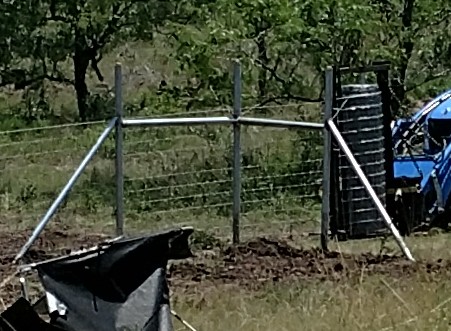

The original poster's problem is his corner post are not set deep enough.

I had exactly your problem on fence posts that I installed because I didn't know any better and did it wrong. I added the diagonal posts outside the H and it has held up well. They are welded to a 3' vertical piece that is mostly buried, set in about 3/4 yard of concrete and at a slight angle. I dug the hole for the brace post with the mini-ex first, set the brace post in concrete and once that cured, I pulled the post straight with the mini-ex and welded in the diagonal support.
