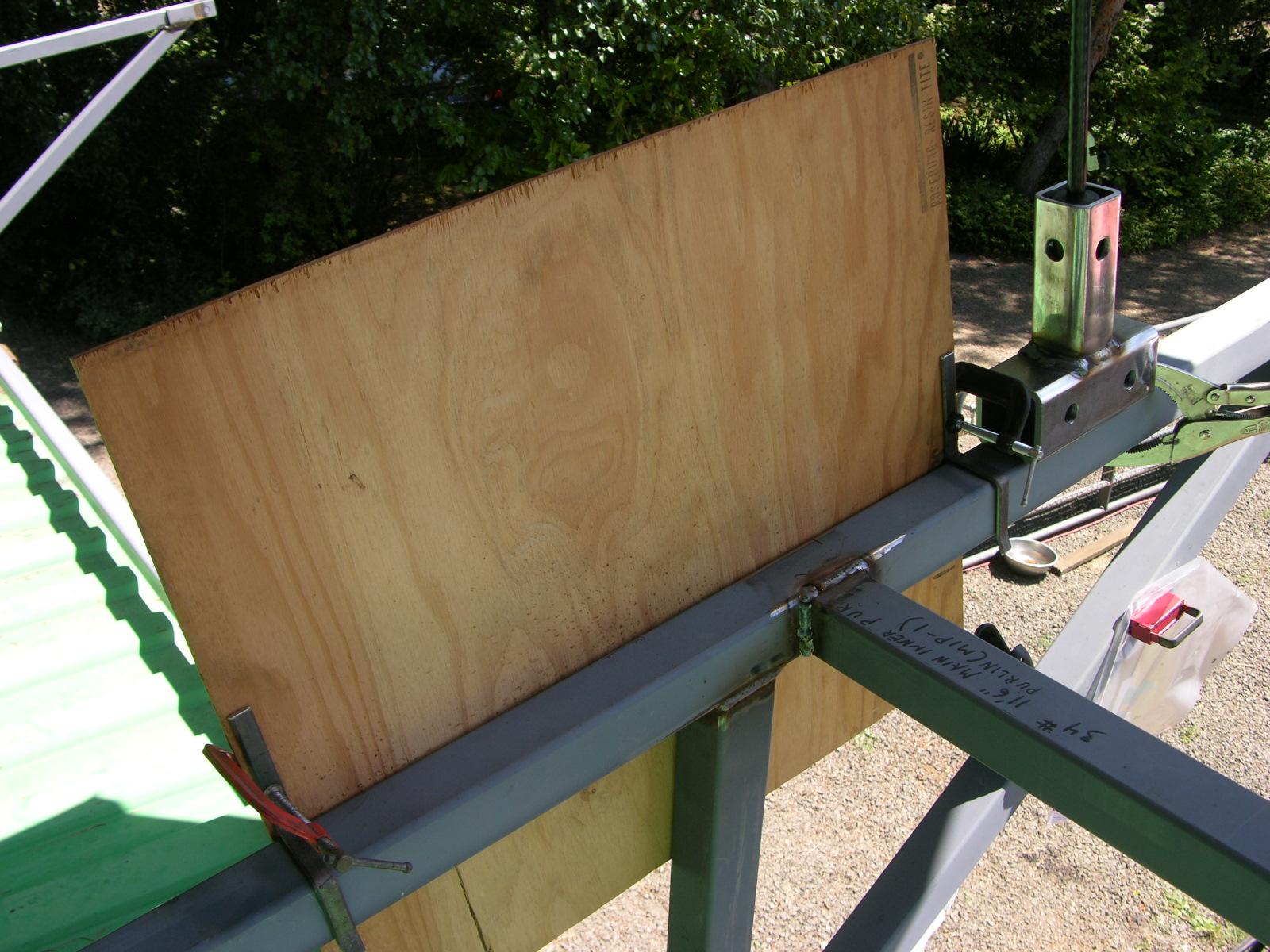

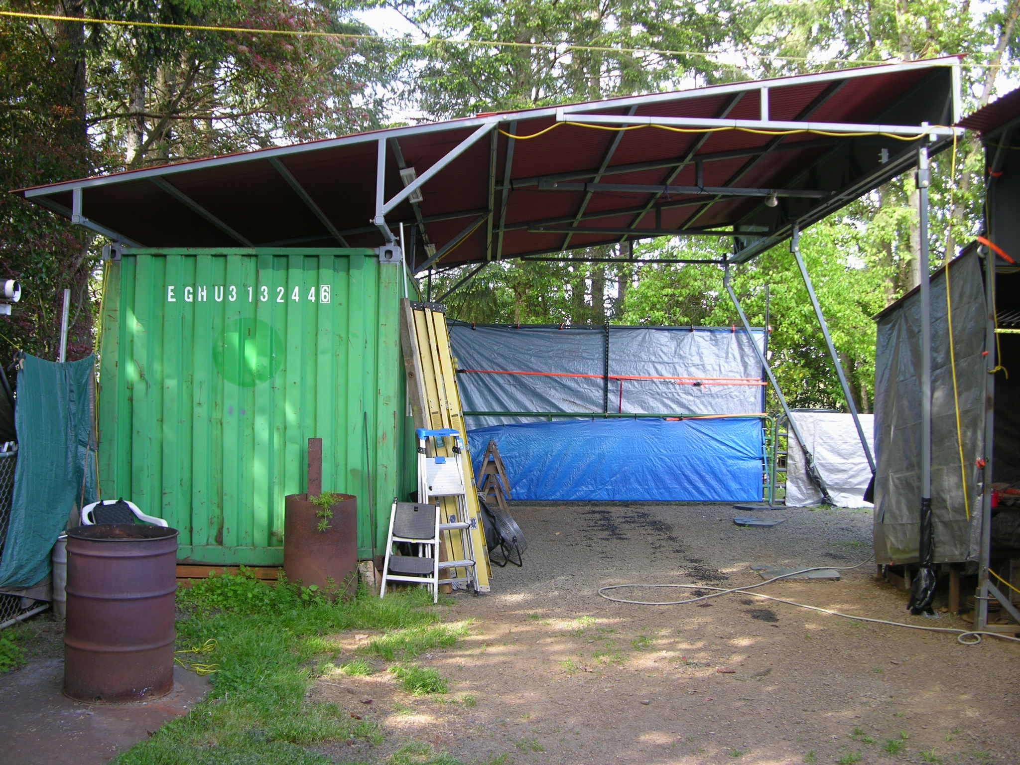

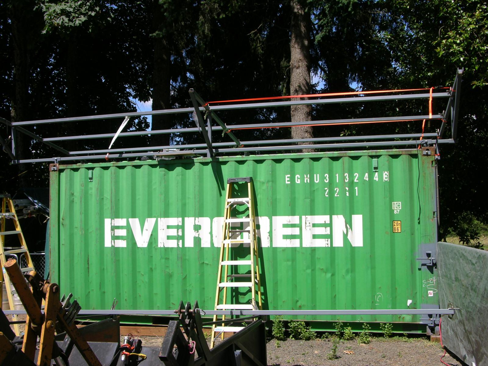

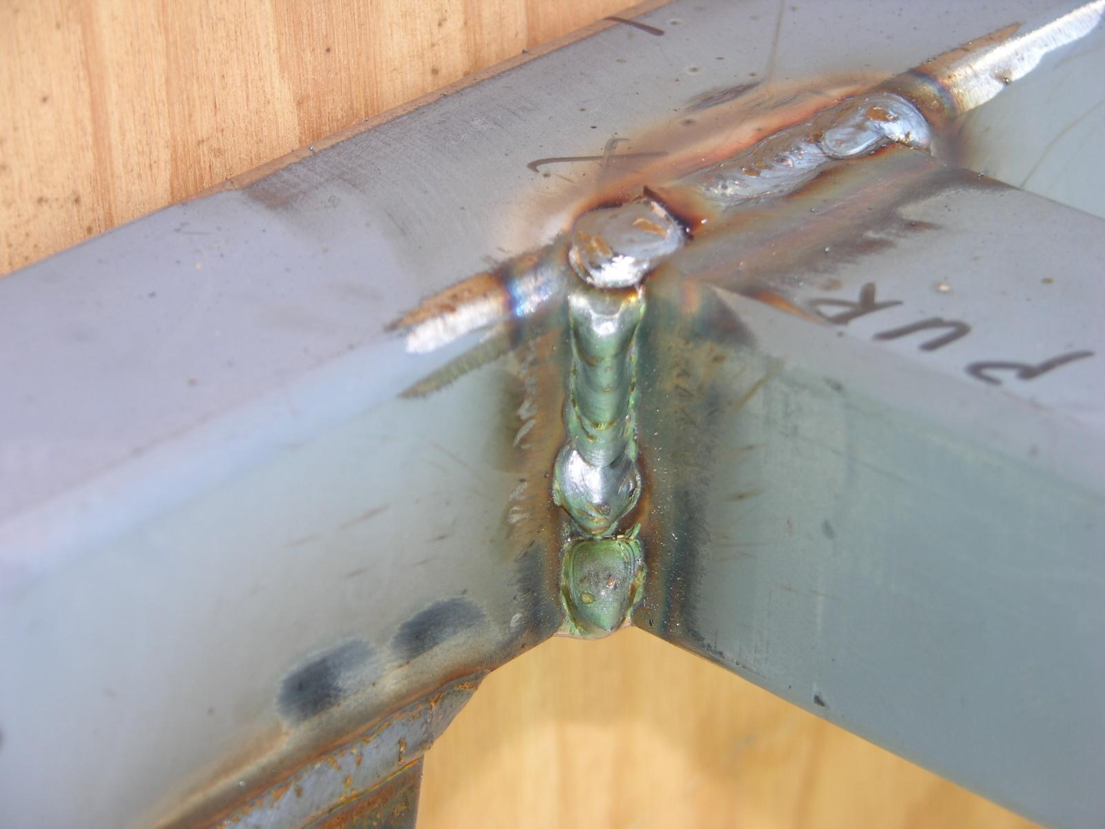

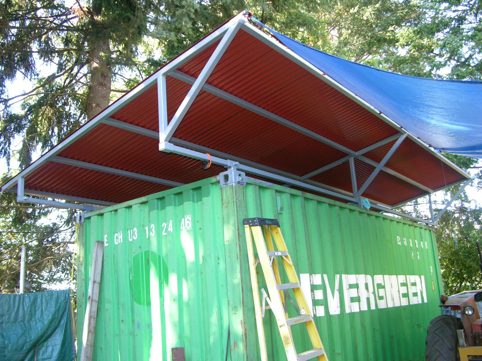

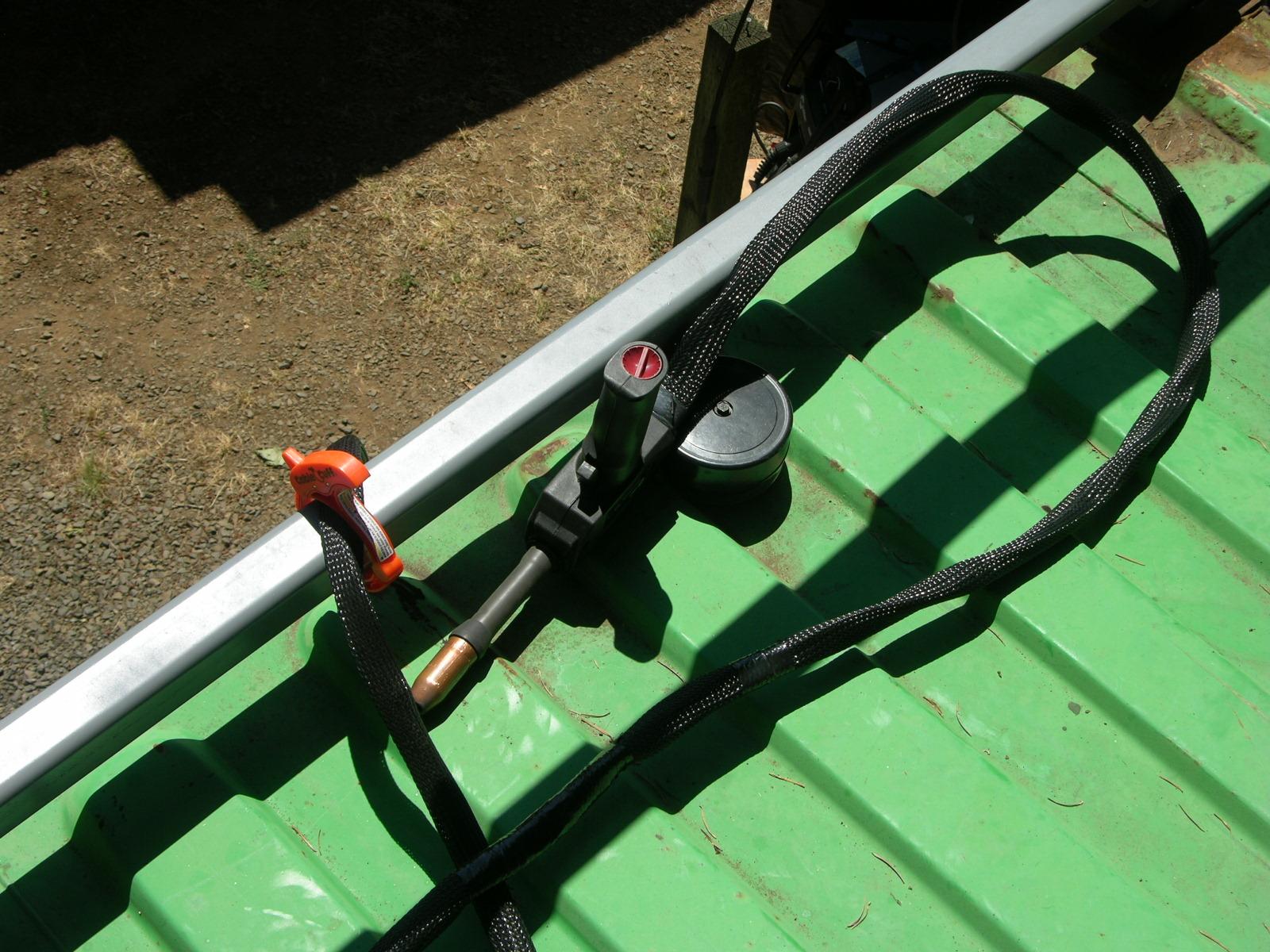

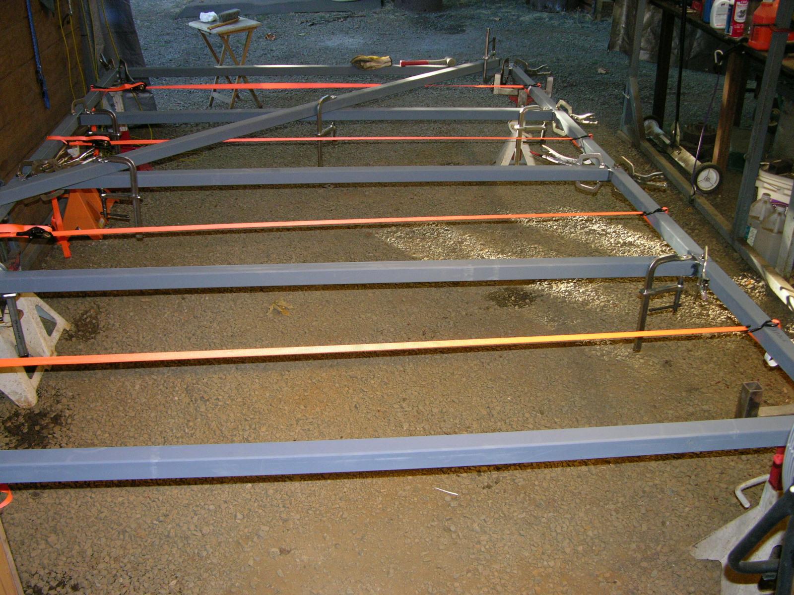

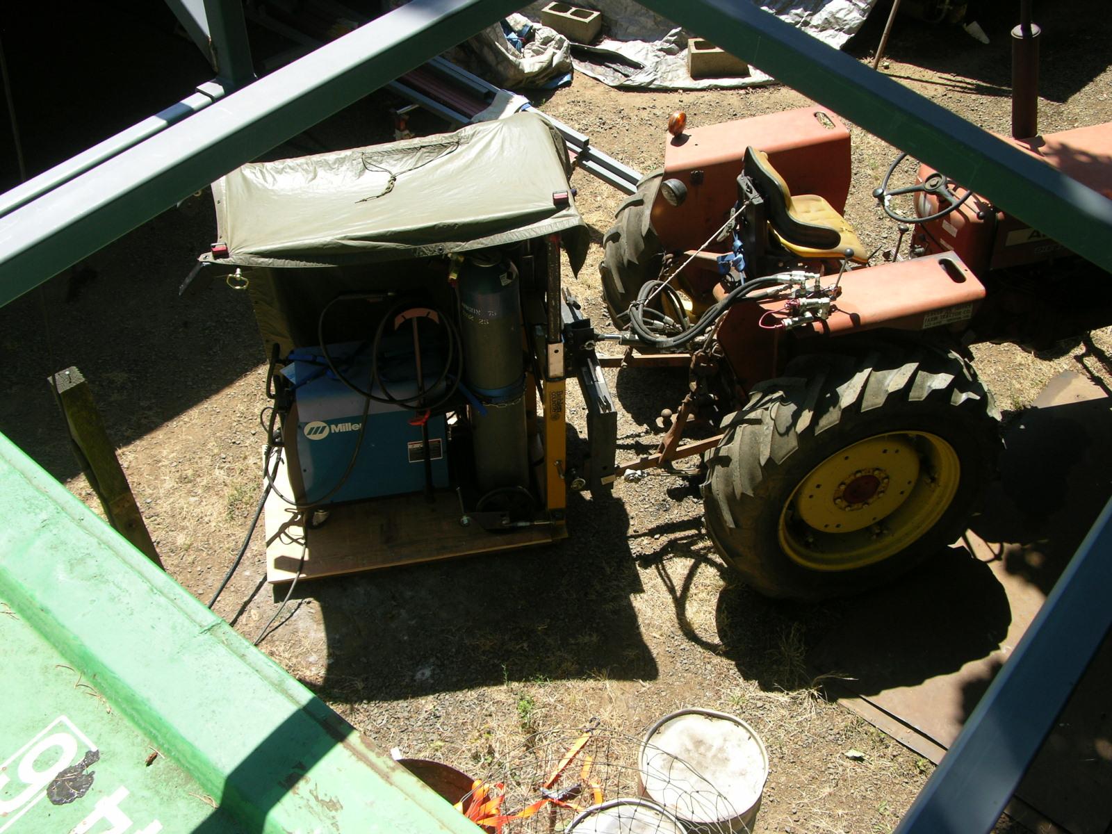

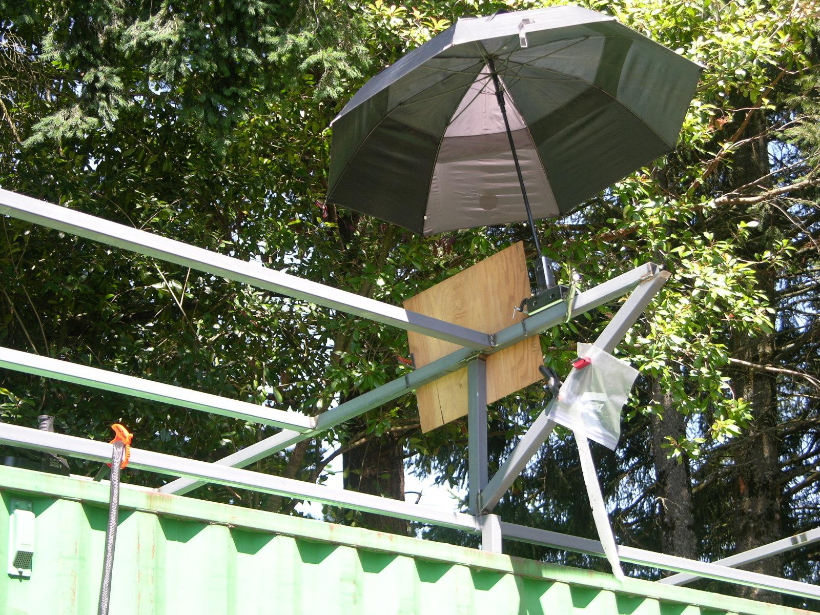

Dale, under most circumstances I'd have to agree; but I may NEVER weld aluminum. There are, however, times when a 30 foot reach can be handy - I got my MM252 with three tanks and a 30 foot spool gun on CL for less than HALF of retail (not hot, just laid off) - the MM252 had less than 5 lbs of wire run thru it and was a tiny bit dusty, kept in a nice shop, and the $1000 30A spool gun had NEVER even had a tip installed. Since I got it I've run about 150 lbs of .035 wire thru it, maybe 20# of that was 2# spools thru the 30A... Steve
One example of a few where I've needed the extra reach -
