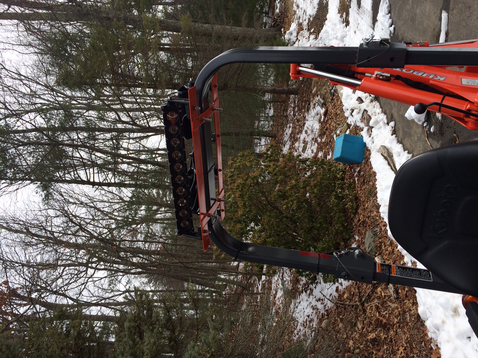

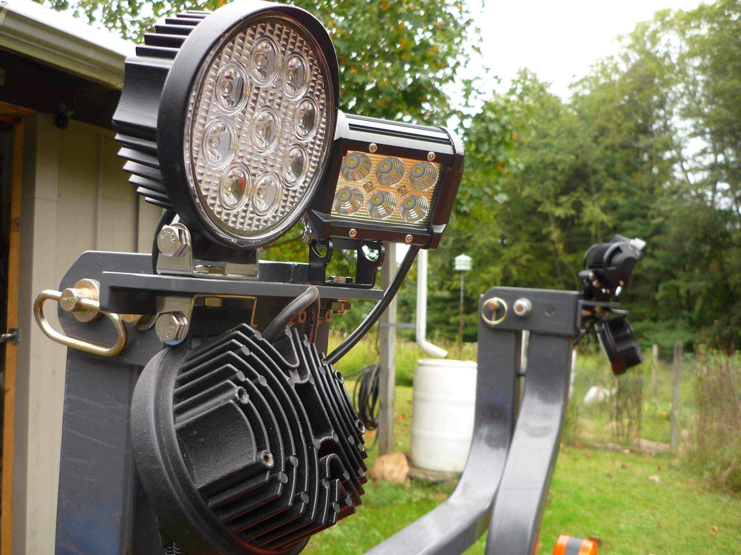

Over the years, I've tried many work light schemes. Magnet mounts, ROPS clamps both above and below the bar, all had their problems. The magnets would "creep" and sometimes fall off due to heavy vibration from the work I do. The ROPS clamps held ok but were subject to damage. I mow along a tree line and frequently take the tractor in the woods. It didn't seem to matter whether they were mounted above or below the bar, sooner or later a branch would get one.
Eventually, I made a simple bracket which is easily removable when working in the woods. It straddles the top of the ROPS and when necessary, I hold it in place with a hose clamp. The individually switched lights can swivel forward or reverse and are held further outboard which helps the glare. I tapped into the 4.5 amp work light circuit with a 2 pin connector for quick removal. The whole rig comes off in seconds.
It isn't pretty but I've used it on my last 3 Kubotas with no modification. Someday, I'll get around to giving it a coat of Kubota gray.

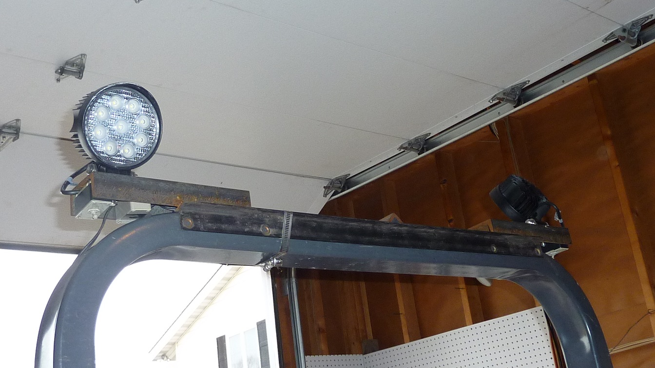

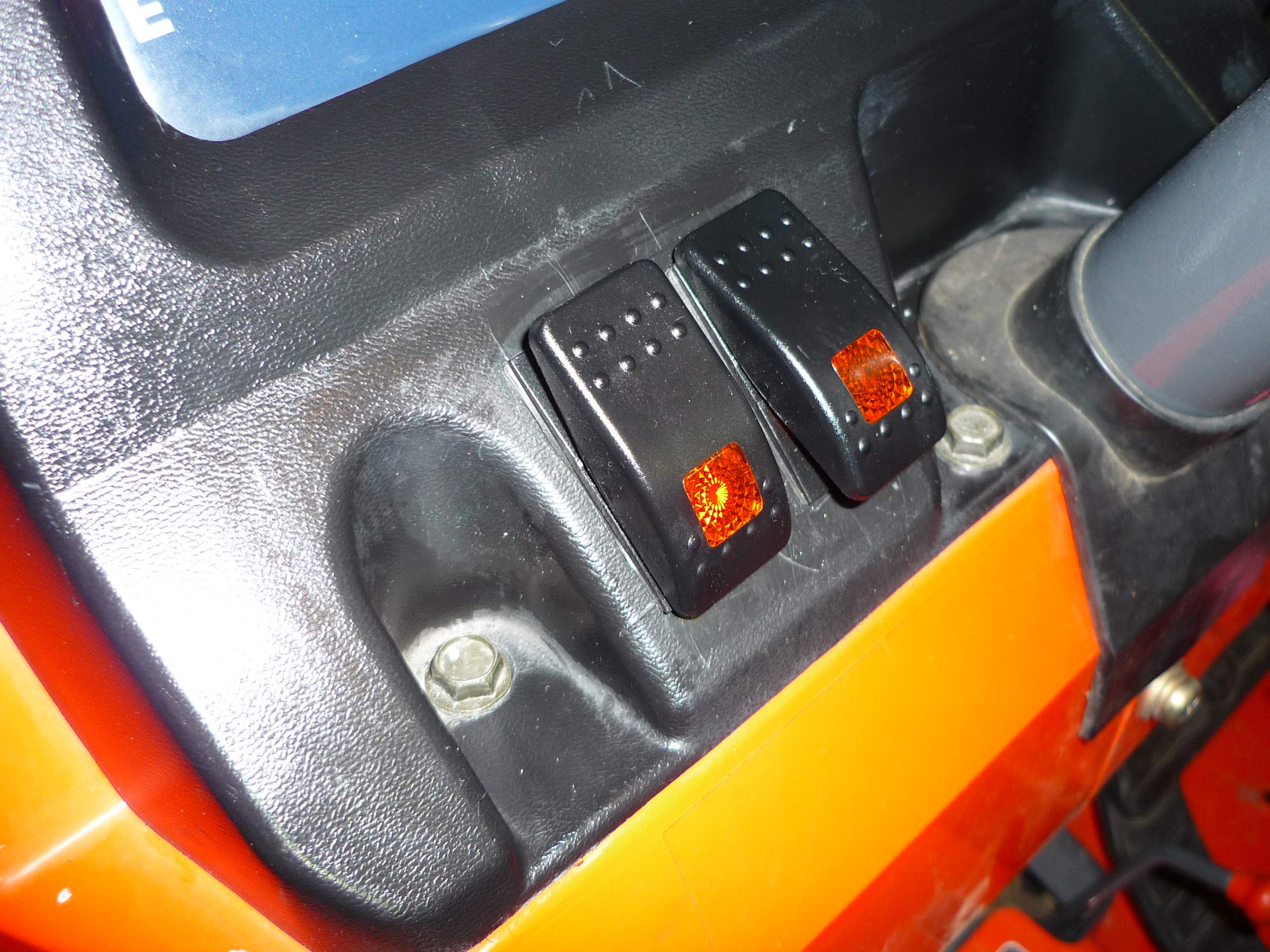

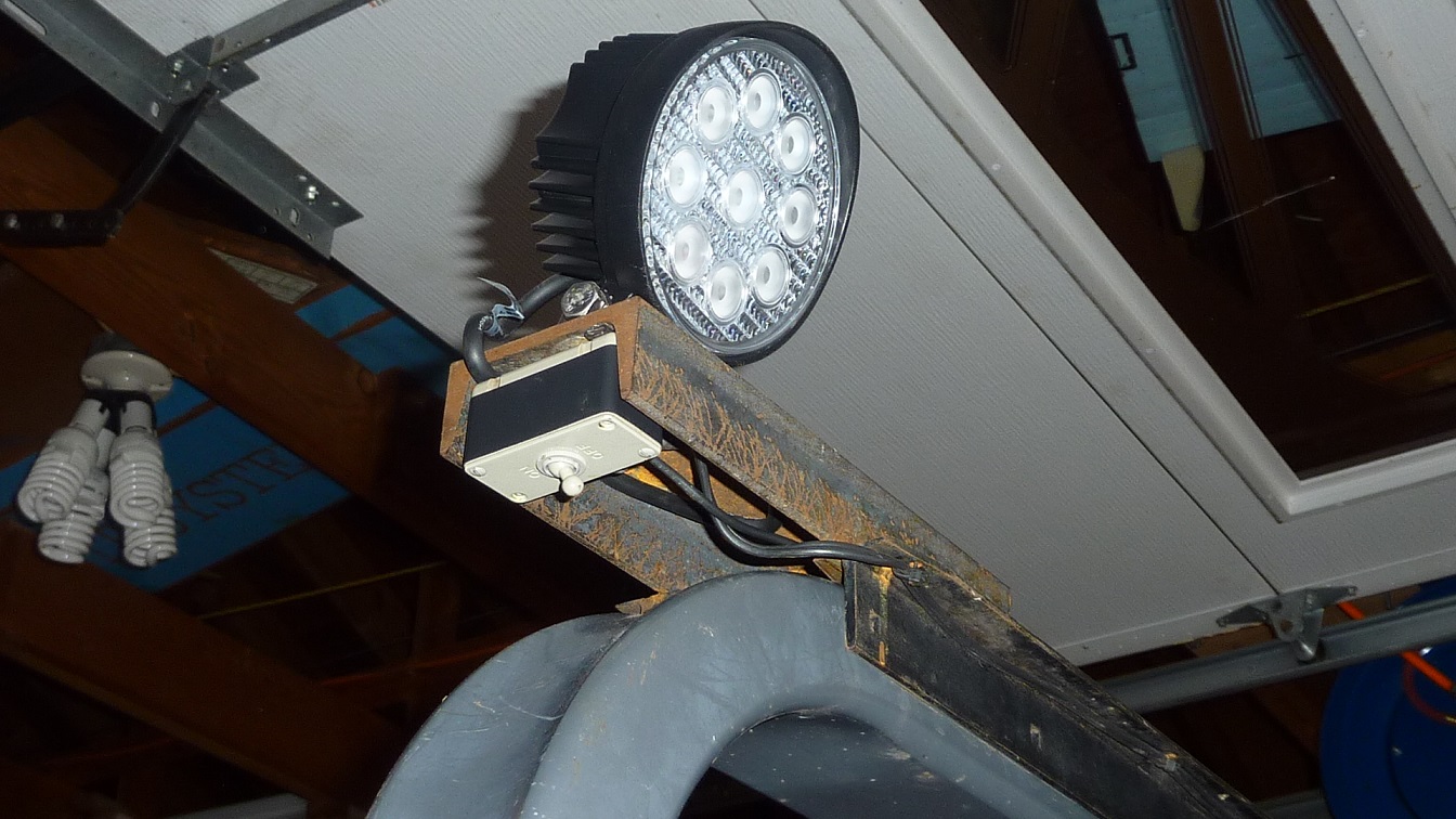

Yet another way to mount lights... (I checked into the Click-bond stuff- seems like a great system, but too pricey for my simple projects) I did use a relay for my lights, simply because a $2.50 relay is a simple way to insure you get all the light you pay for. I am happy with the light location, considering that I didn't want them sticking out where they would banged. ROPS still works as needed, of course. Waterproof, LED switches so if I use the rear lights backing into my dark barn on a sunny day I don't forget the lights are on- probably overkill. 27 W front and rear, 18 W side lights. (I snowplow, too often at night, and down a woody lane, so seeing what's along side me is useful.)

Looks good, varmint!
