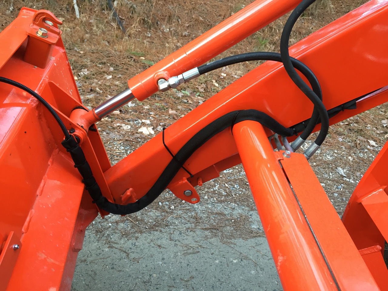

I route my wiring through air Brake tubing (common on fuel tankers). It will bend without kinking, protects the wire from kinking and can be attached to the ROPS with long cable ties.
Great idea. What diameter do you use? I'm thinking air brake tubing may be a better way to protect video camera cable than wire loom when I finally get around to installing my FEL bucket camera.
That would be interesting -- I have never seen air brake tubing. I used a combination of fuel hose and hydraulic sleeving (the black nylon stuff) to run camera wiring through the difficult parts of the FEL where there would be a lot of flex and abuse. Regular split-loom on either side of that section.
