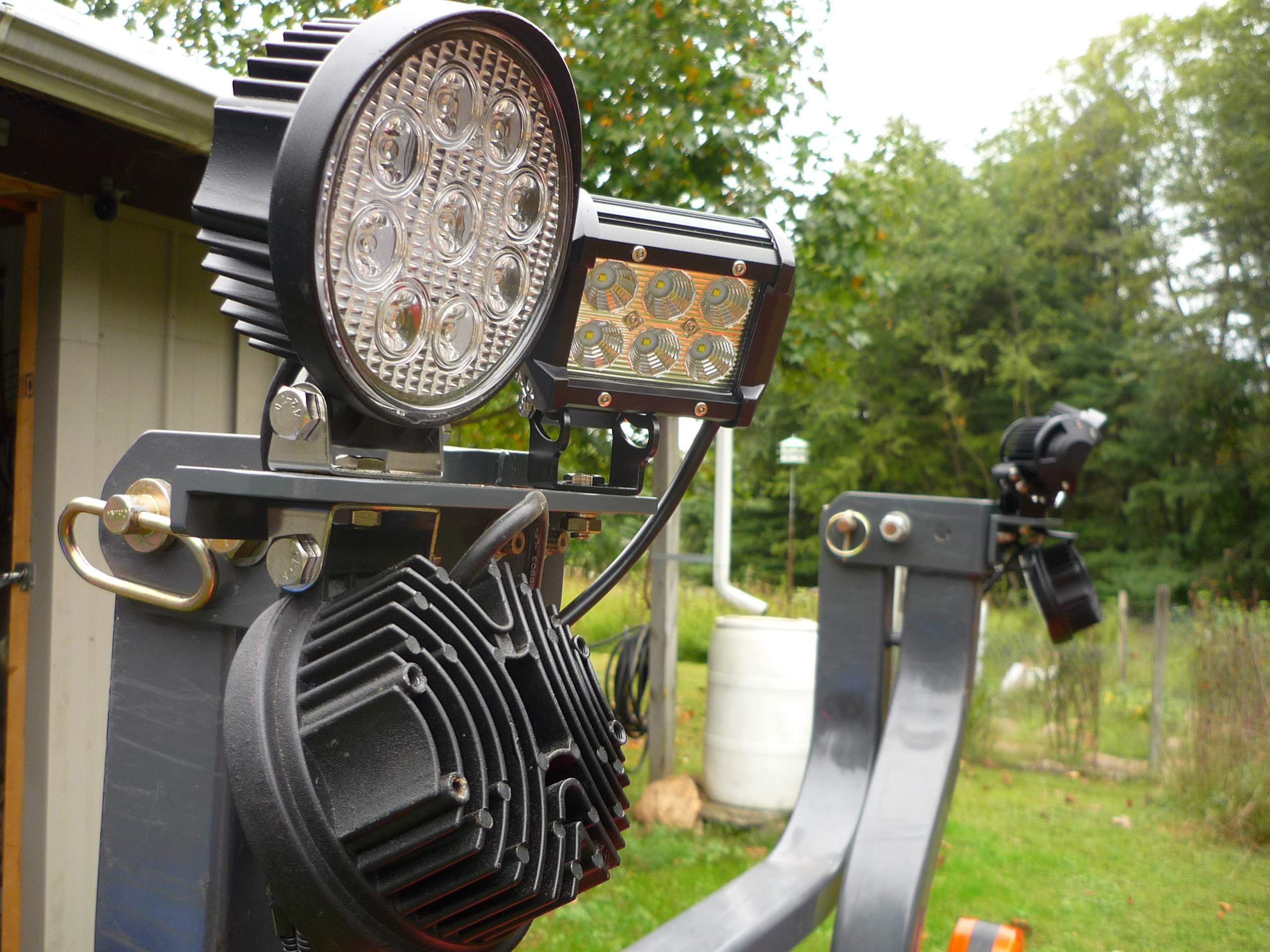

Great idea. What diameter do you use? I'm thinking air brake tubing may be a better way to protect video camera cable than wire loom when I finally get around to installing my FEL bucket camera.
Depends of number and size of wire. Have used 1/4 to 3/4 with good results. comes in green red and black colors depending on where you are running it

Nice, Varmint. I'm looking forward to hearing how you like the spots once you get them mounted. I'm assuming from your comment that you'll mount them pointed directly out to either side. Not sure I'll add side lights to my NX4510, but was thinking floods would illuminate a bit better immediately to the sides if I do.
Yup, I plan to mount them aimed a bit forward, but mostly down to the sides. I have one forward flood light, and one spot, but they are aimed directly forward, and in my case, downwards. There's still the problem of the loader or plow blocking light right down in front, but I don't have a solution for that. I just want light to see well in whatever situation I am in, and multiple LED's are low draw enough that I can do it without stressing the alternator or battery. The forward LED lights are so much more useful compared to the factory incandescent lights that it's sad.
