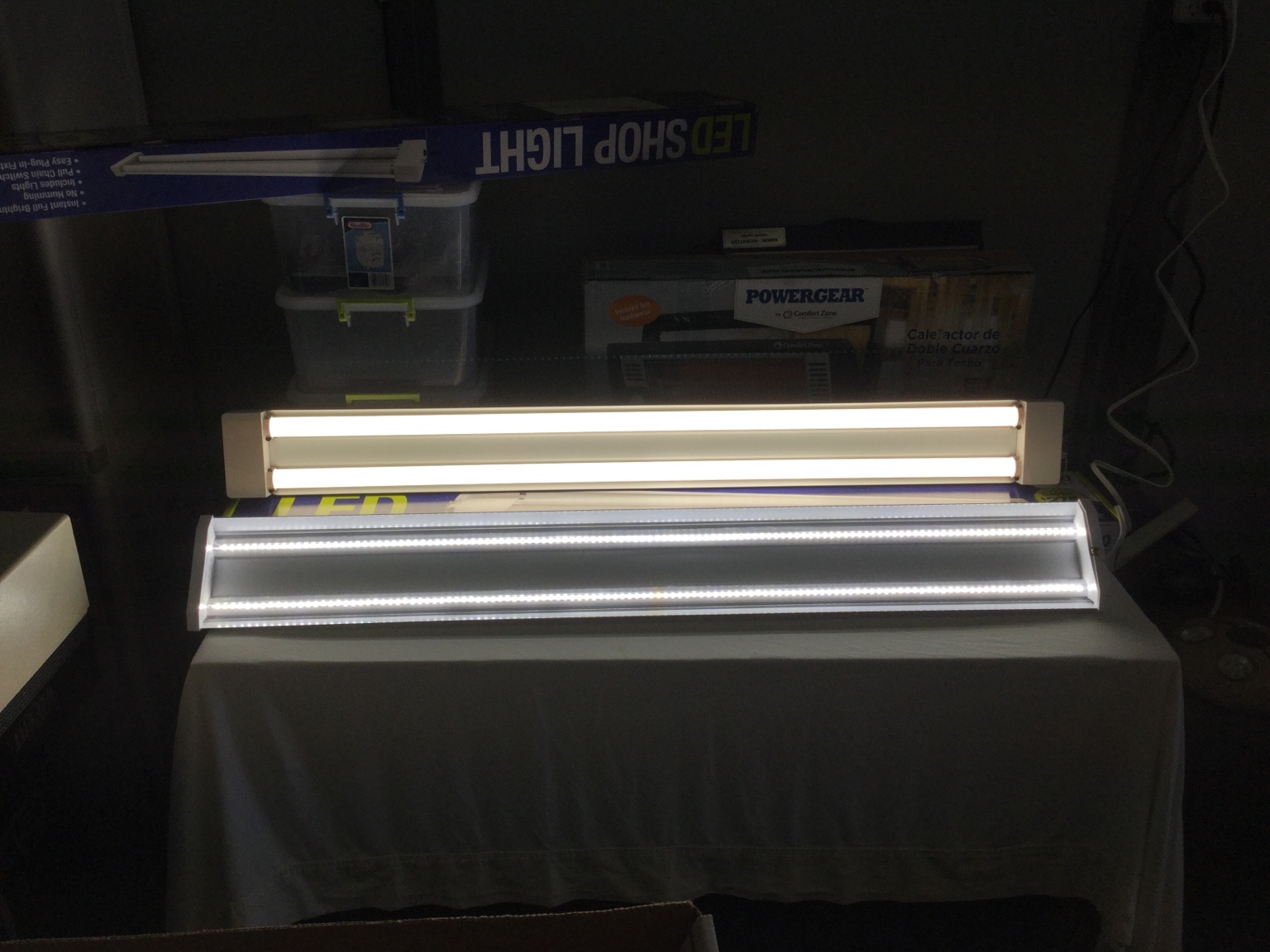

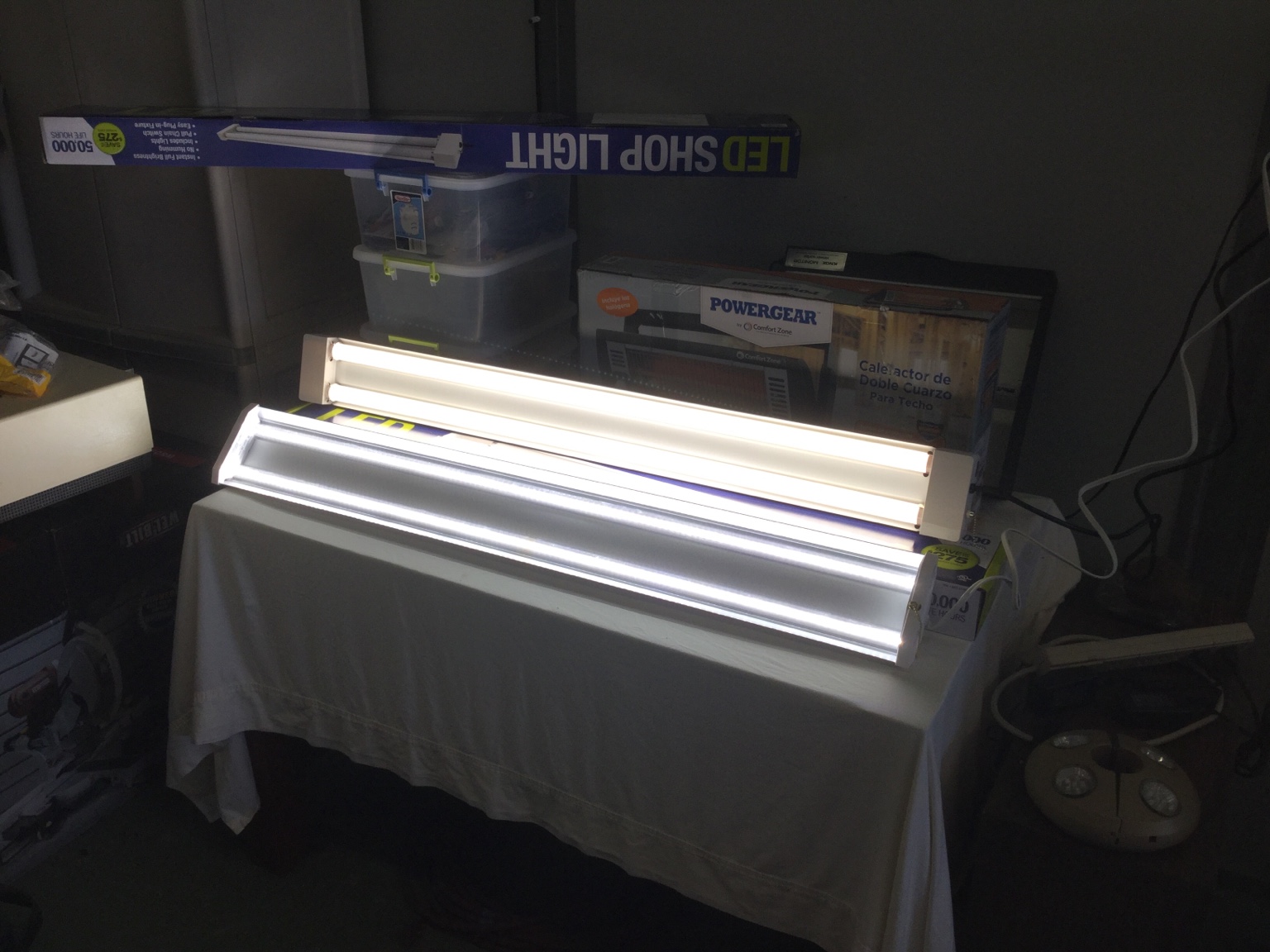

The 8' fluorescent lights, in my shop, are about 16' above the floor and hung on chains from ceiling so, replacing the 8' T12 tubes is a major PIA. I bought one of these online from Home Depot for a trial.
EnviroLite 8 ft. 4-Light White Industrial LED White Strip Light with T8 LED 5K Tubes-ST74T185 - The Home Depot
It works great and very bright. No interference to either AM or FM on shop radio either. I'm going to order 8 more for complete replacement of my overhead lights. If I do have to replace one of the LED tubes, in the future, it will still be easier than replacing the 8' tubes. With the fixtures being hung on chains you have to hold fixture with one hand and stab tube with the other, on a 14' step ladder.
I also bought one each of the 4' LED lights from Sam's Club and Costco for trial to install above specific work areas in my shop. Neither cause any radio interference. I prefer the light from Sam's as the LED tubes have frosted covers which, I believe, disperses the light better.
