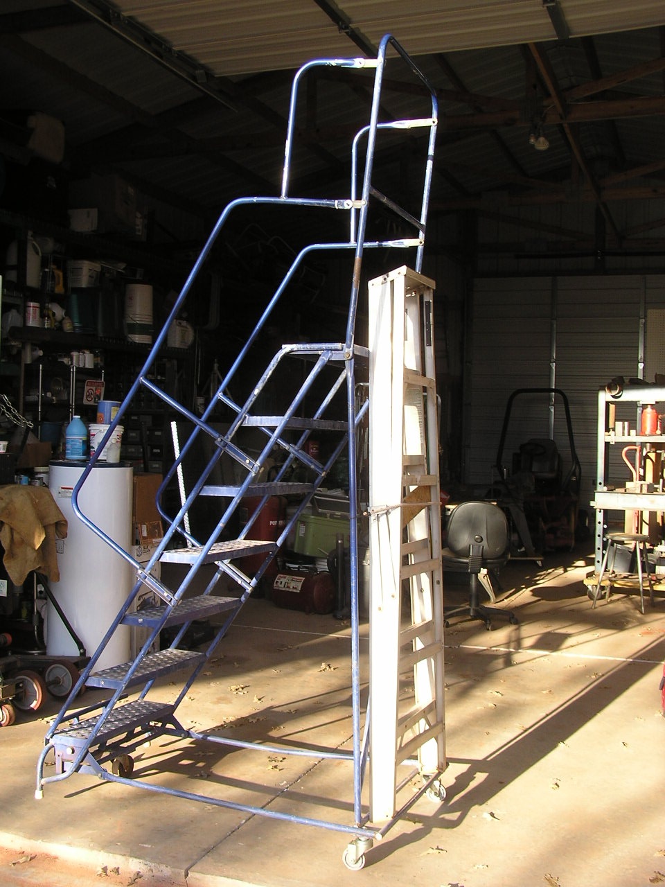

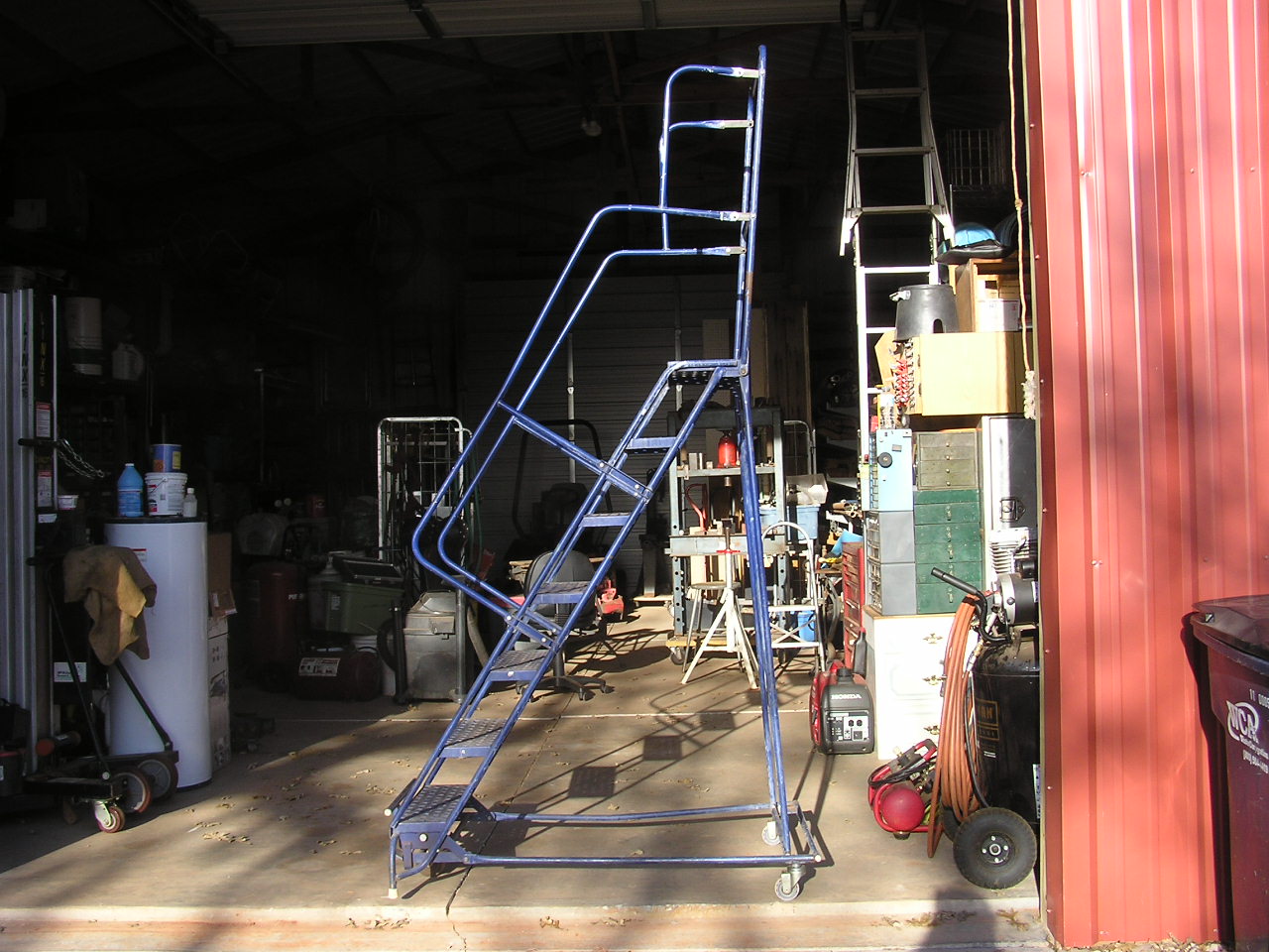

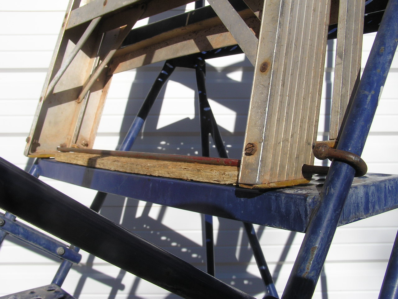

I bought a used rolling warehouse ladder, like the ones in the aisles at Home Depot, specifically for working on shop lights. I roll it up onto my 6' x 12' utility trailer, for extra height, and run tie down ratchet straps to all four corners for added stability.
I also have one that I found on craigslist. Decided it was a good place to store my 6' stepladder.
Then I realized I could combine them and be able to reach the overhead shop lights. :thumbsup:
