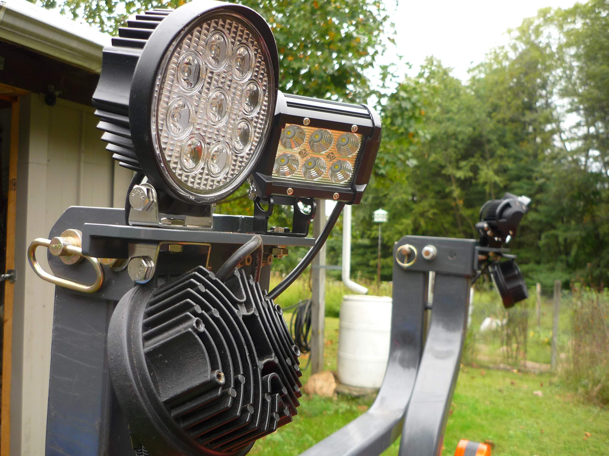

/ LED lights? #13
Pretty soon, LED lights will be "normal" and no longer a topic of discussion. Something new and better might come along. You can now buy 27W floods like mine for about $12 each, and 18W floods for maybe $8 if you are able to shop the internet. My only advice is to look for a US shipper, Cree LEDs, and Amazon sellers since you have more protection in case of an issue. eBay seems to have slightly better deals on average, though... I have never had a problem with the many LED lights I have purchased, and like others have already said, they are vibration proof, waterproof, amazingly well made considering their prices, don't burn out, and low current draw. What's not to like??
