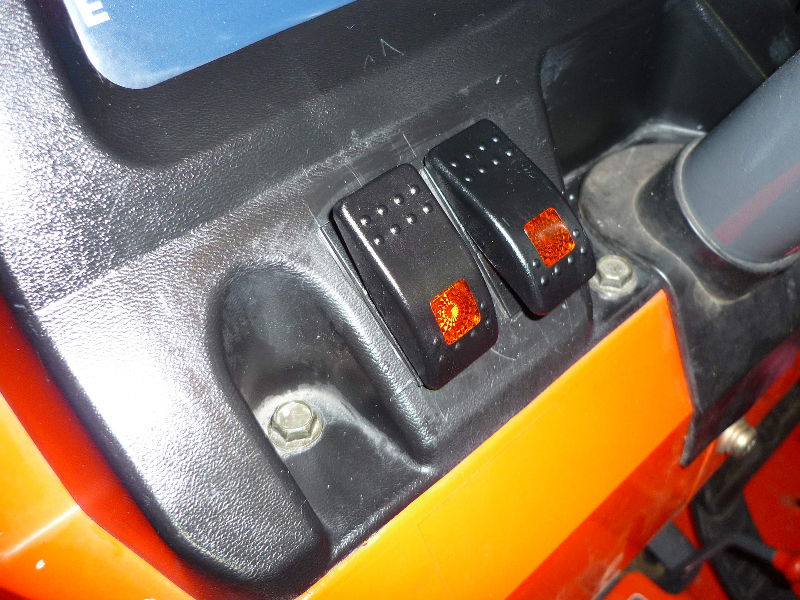

I bought carefully selected LED lights from eBay, usually cheap but not necessarily the cheapest, and have had zero issues with quality, construction or performance. Because they are so low cost, and draw so little current, it is easy to use a number of them, lighting as needed. FWIW, I have never had an issue using them in driven snow, either. About the only time I have used the lights is plowing snow at night. Light bars have gotten great reports, as well.
The waterproof switches are from eBay, and I imagine they all come from China, no matter whose you buy. You most likely won't be driving at high speeds, so seeing well beyond 50' isn't that important? Avoiding hotspots and shadows is important, though, which is where multiple lights help. You want to avoid having the light beams shine on you tractor's components, obviously, because that will distract from what you need to see.

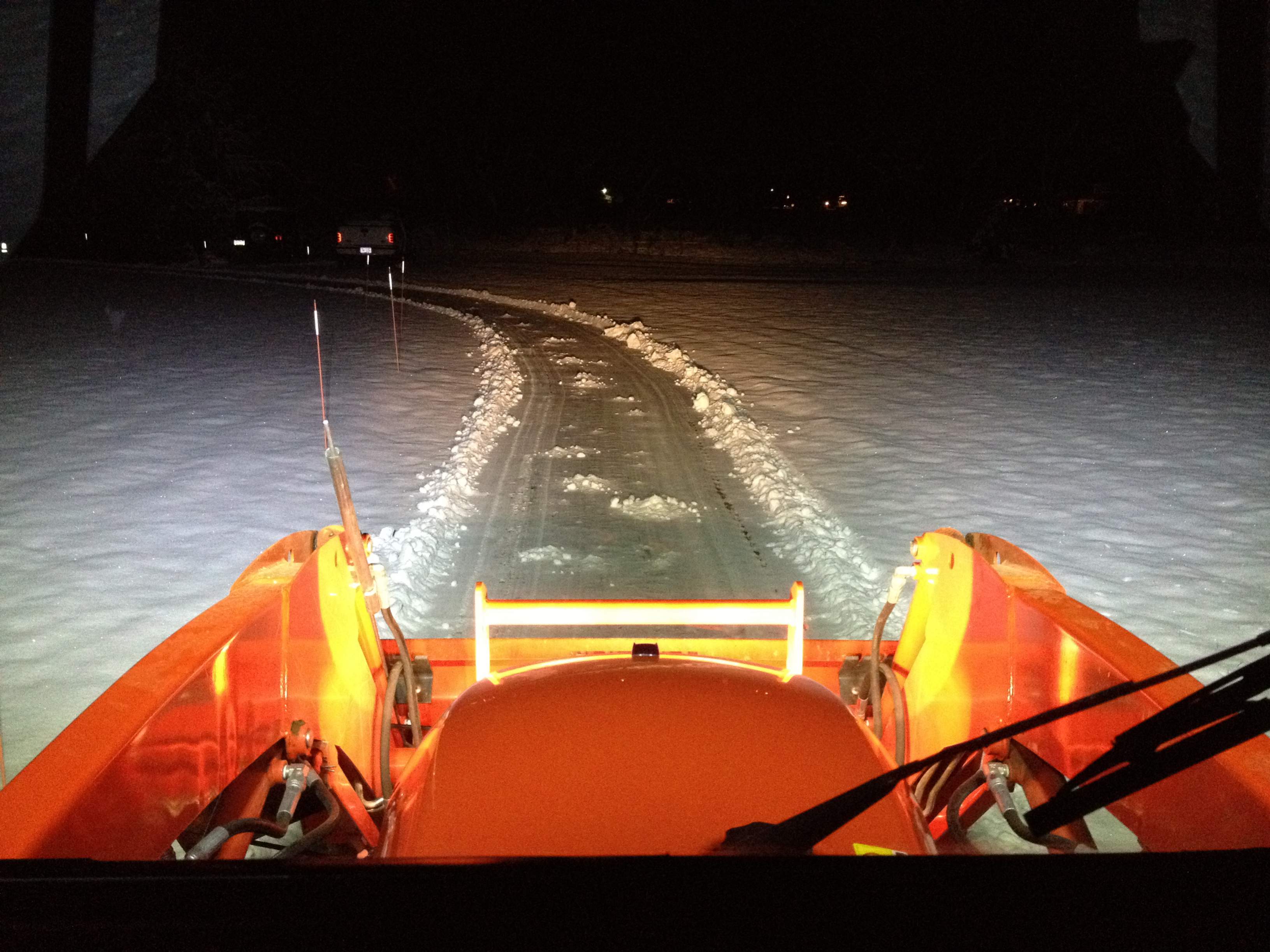

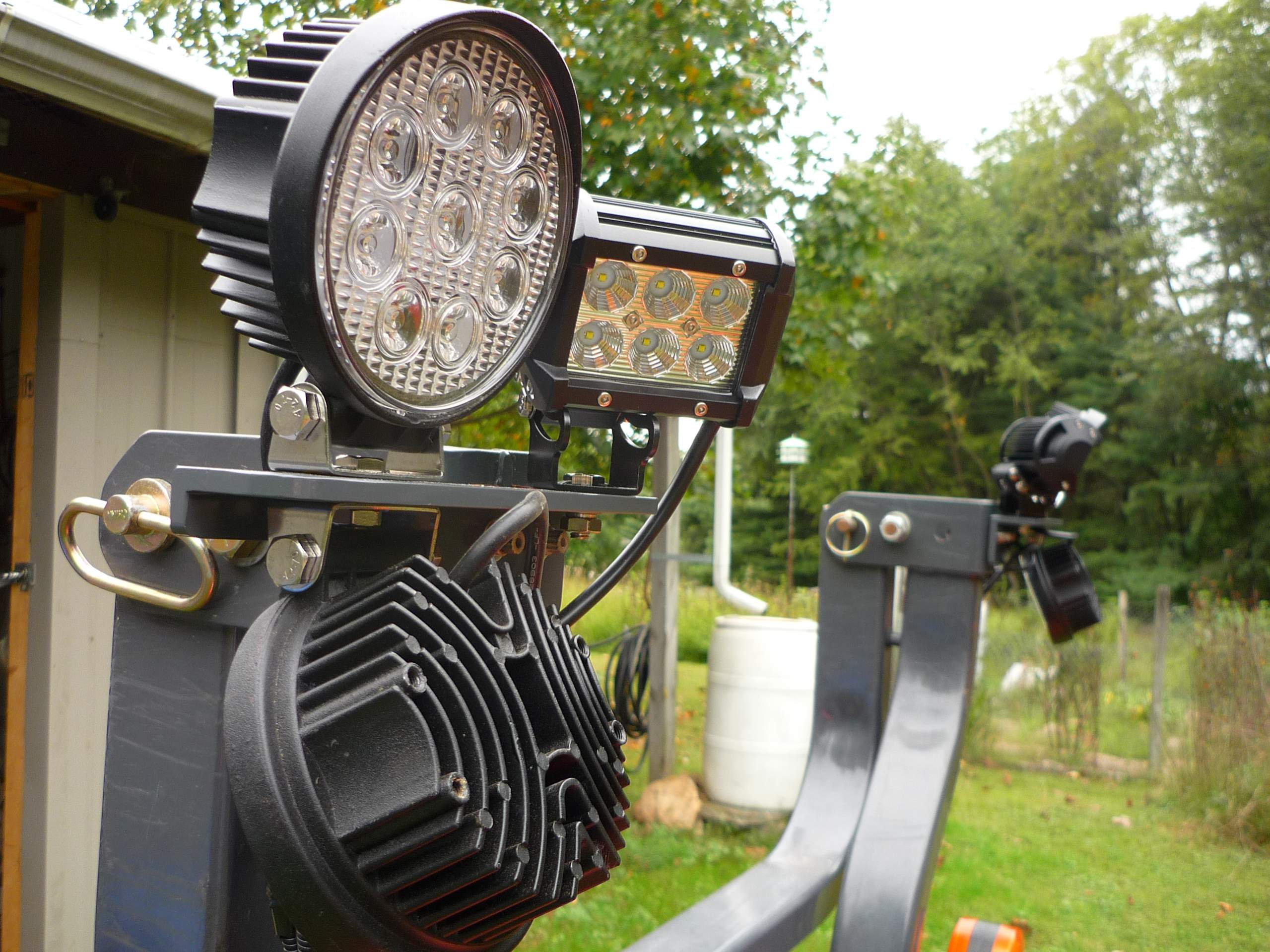

I get all my lighting at The Trailer Shoppe in Leola PA. All the work lights are flood pattern. Most are Maxxima and none have failed since I built the cab in 2012. My L3200 won't do 70 MPH, so there's no reason for spots. I want a wide pattern that does a good job of illuminating anything I need to see within maybe 50 feet or so. As I stated on another light discussion, the LED's don't seem to provide the definition that the old halogens did when it comes to seeing the cut/uncut grass at night. And again, they throw annoyingly bright light way beyond the lit area. I was standing on a hill about 25 yards away from the tractor for the second photo and it was unpleasant to look at the small sidelight (bright spot at rear of tractor). I believe this is common for LED's, since I noticed the same effect from aftermarket lights on many of the SUV's that local "offroad pretenders" seem to be going to.
The first, third and fourth pictures are a pretty accurate depiction of what it really looks like. There's no dark area in front or behind the tractor as the second picture would have you believe. The second picture doesn't do them justice - I'm guessing the sensor on my cell phone hastened the exposure to make it look darker around the tractor than it is in real life.
