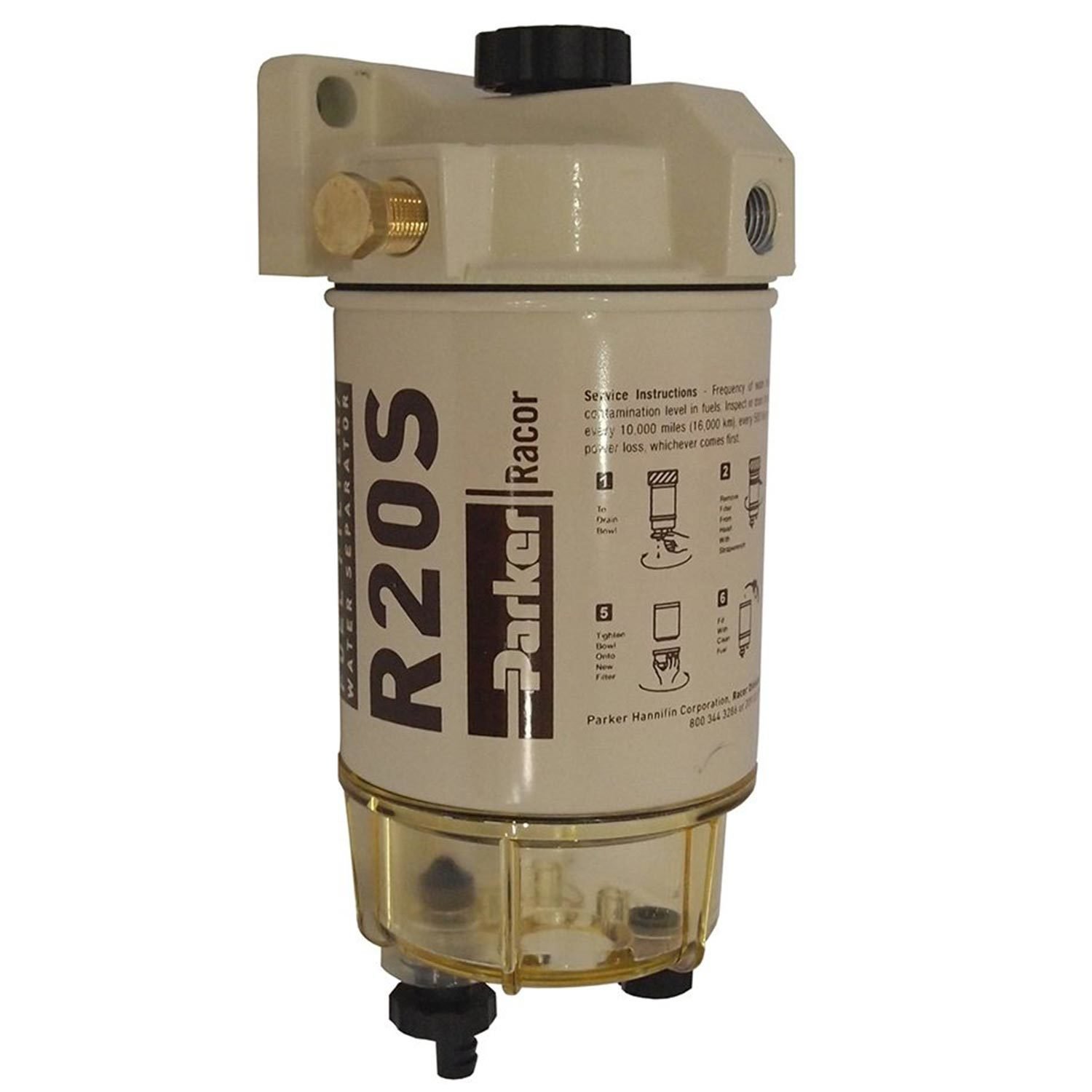

Basically what I bought but mine are Chineseum bases with Racor R12 filters. Primer pump for me is not necessary.
I find it interesting that they are all listed as a marine accessory.
Both mine are larger (power wise) than yours but the filters are rated at 30 gph and that is way more fuel than I consume at any given time.
