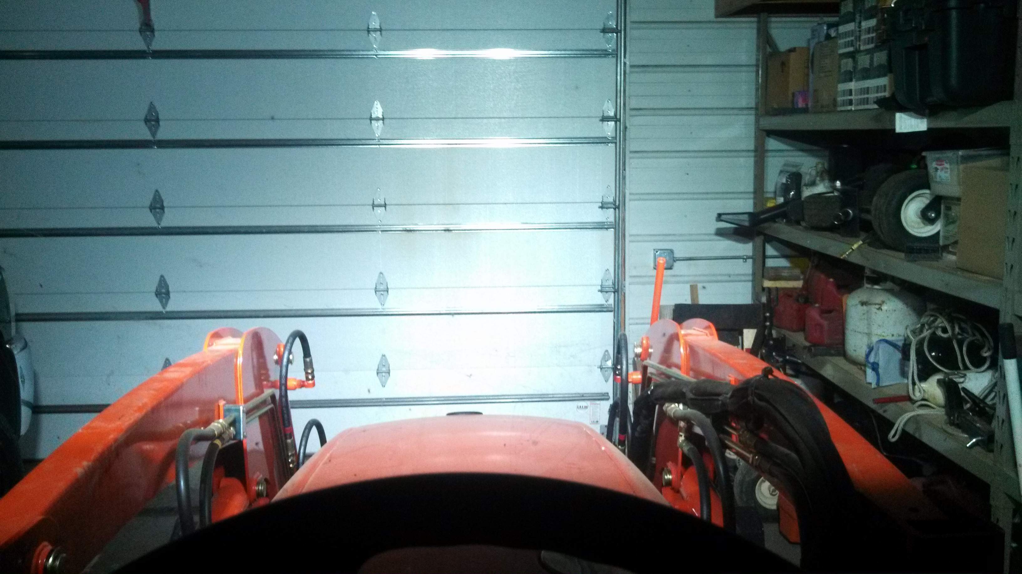

You guys inspired me to replace my lights with LED's as well. Here are some before & after shots while the tractor was parked in my dark garage.
IMG_20131015_091857_258.jpgIMG_20131015_105859_590.jpgIMG_20131015_091908_407.jpgIMG_20131015_105917_994.jpg
View attachment 341857View attachment 341858View attachment 341859View attachment 341860
Very nice, it makes a huge difference. So what did you change the lights to and where did you get them? I'm also pretty jealous that you can get your tractor in the garage. One of my doors is 1/4" to short, the other 1/2 to 3/4" to short.
/ Let there be light, lots and lots and lots of light! #29
They are the same as the ones coobie used, bought them on Ebay.
