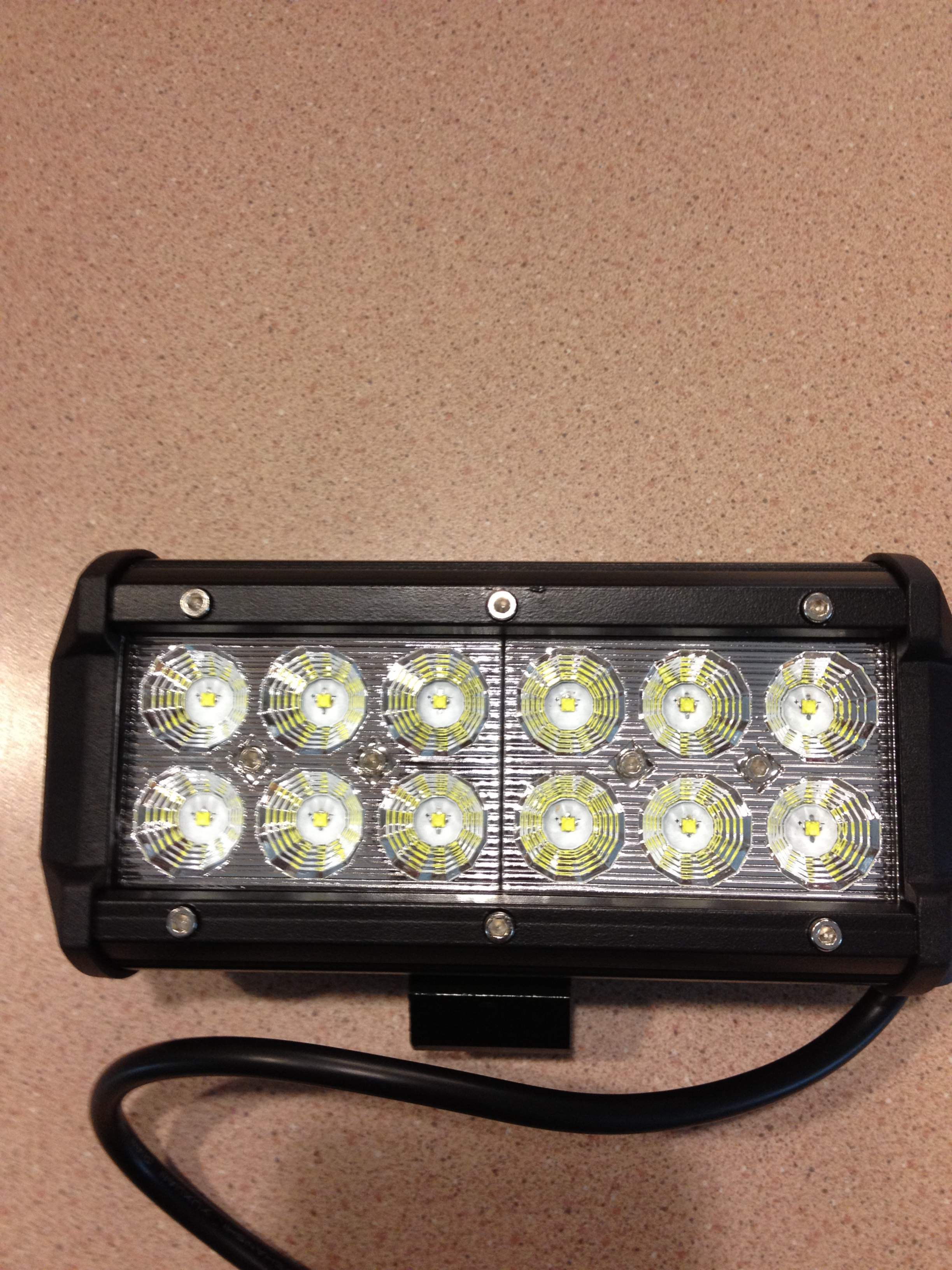

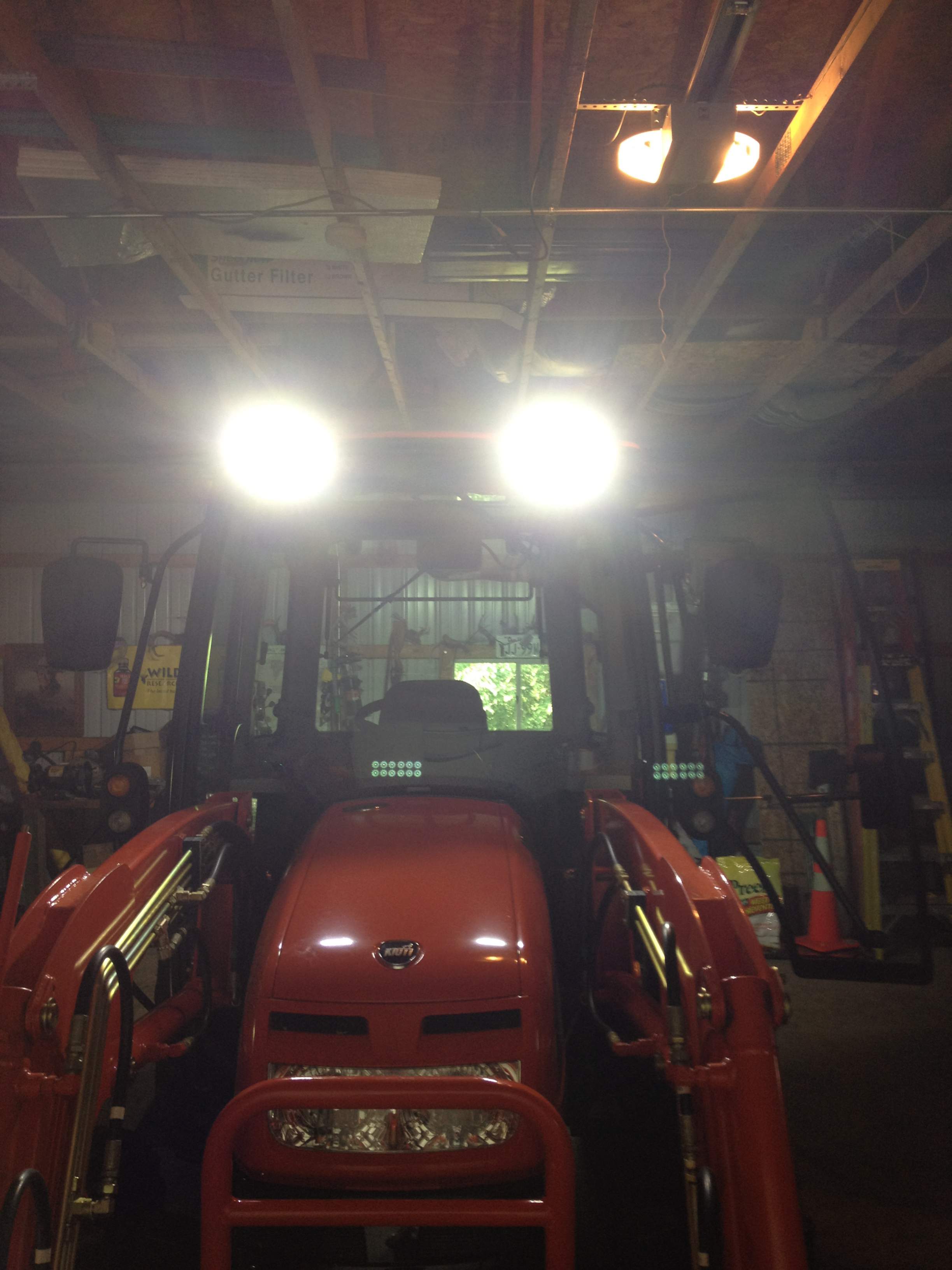

Kiotiken,
Did you have any problem, as far as electrical, running that many lights?? Hope not, really like to have that many lights!!!
No, none at all. 8 of the LEDs draw less current than the 4 factory lights did so its not an issue.

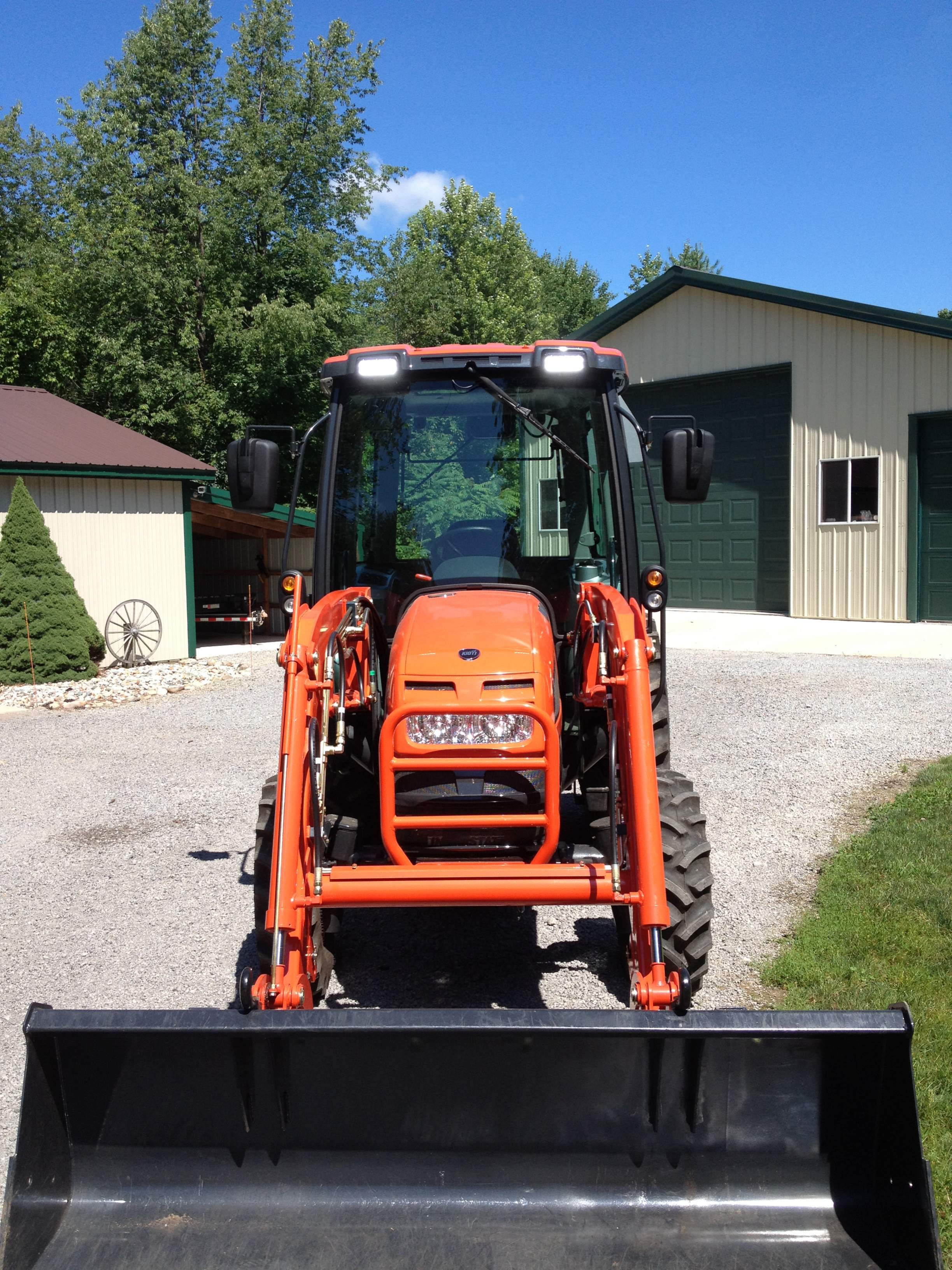

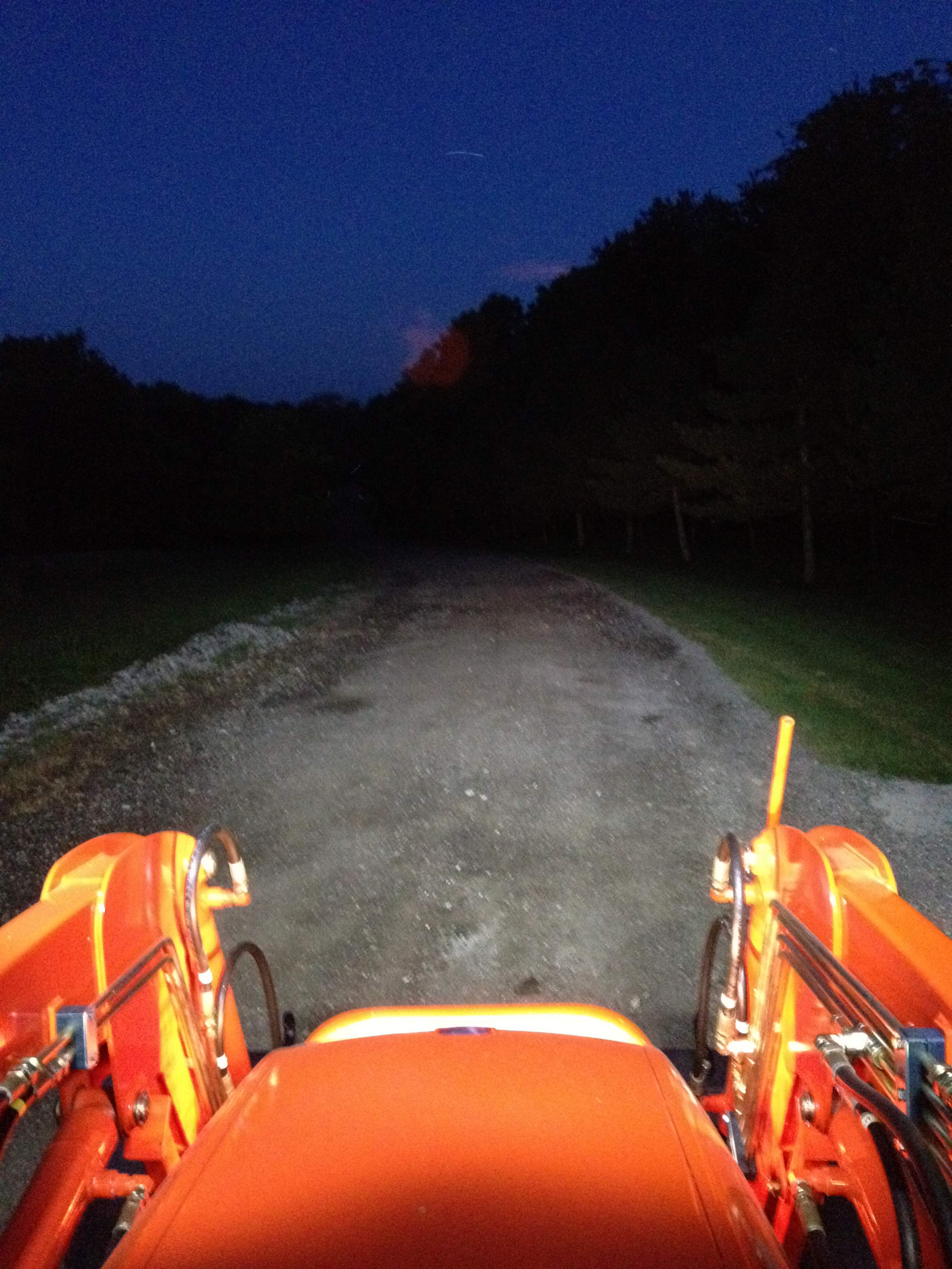

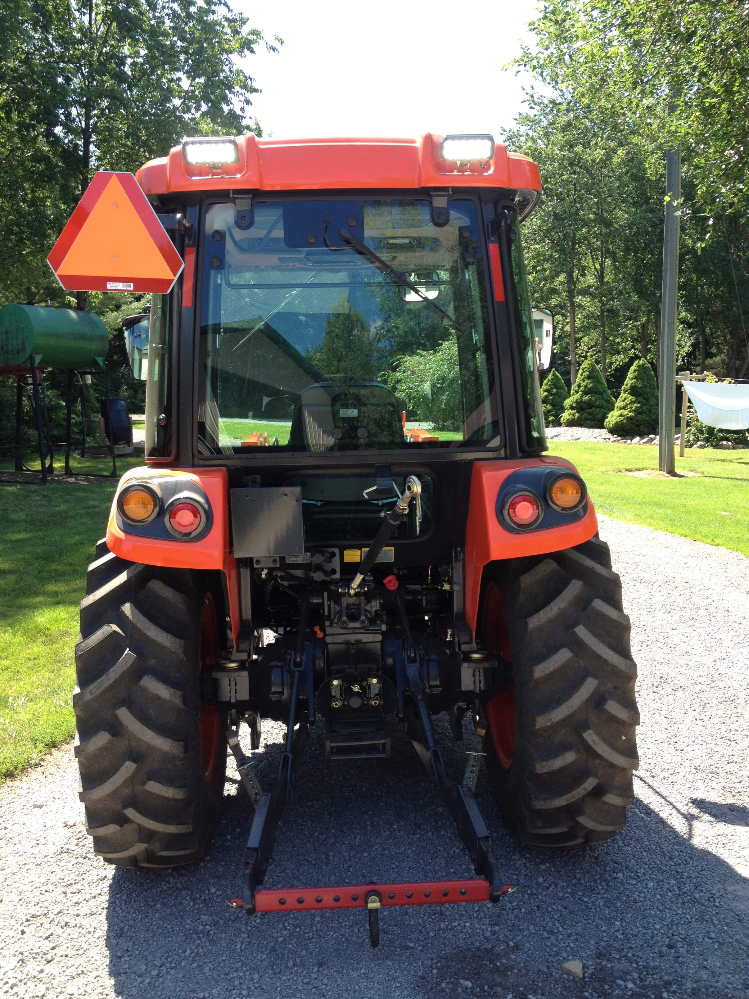

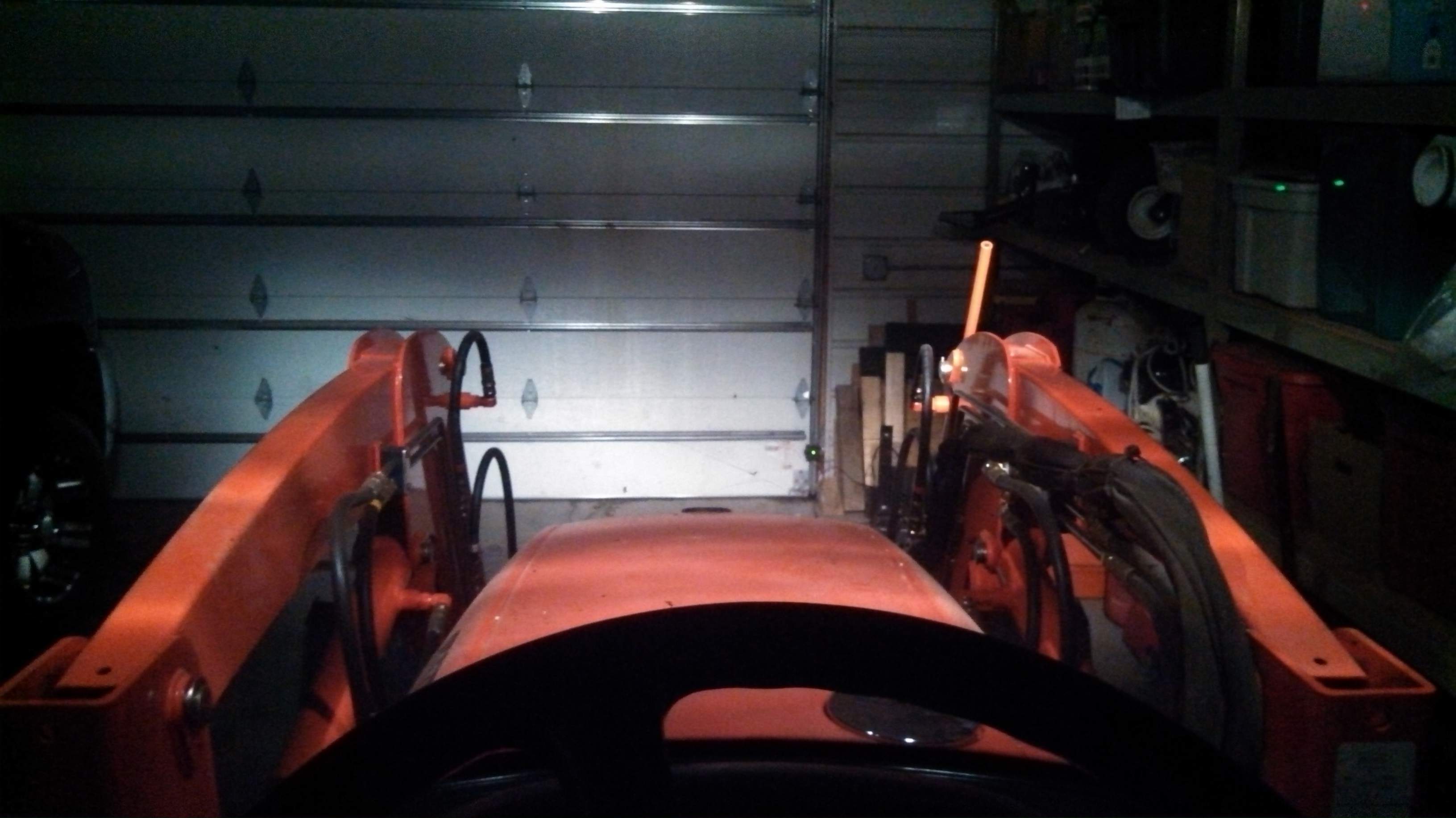

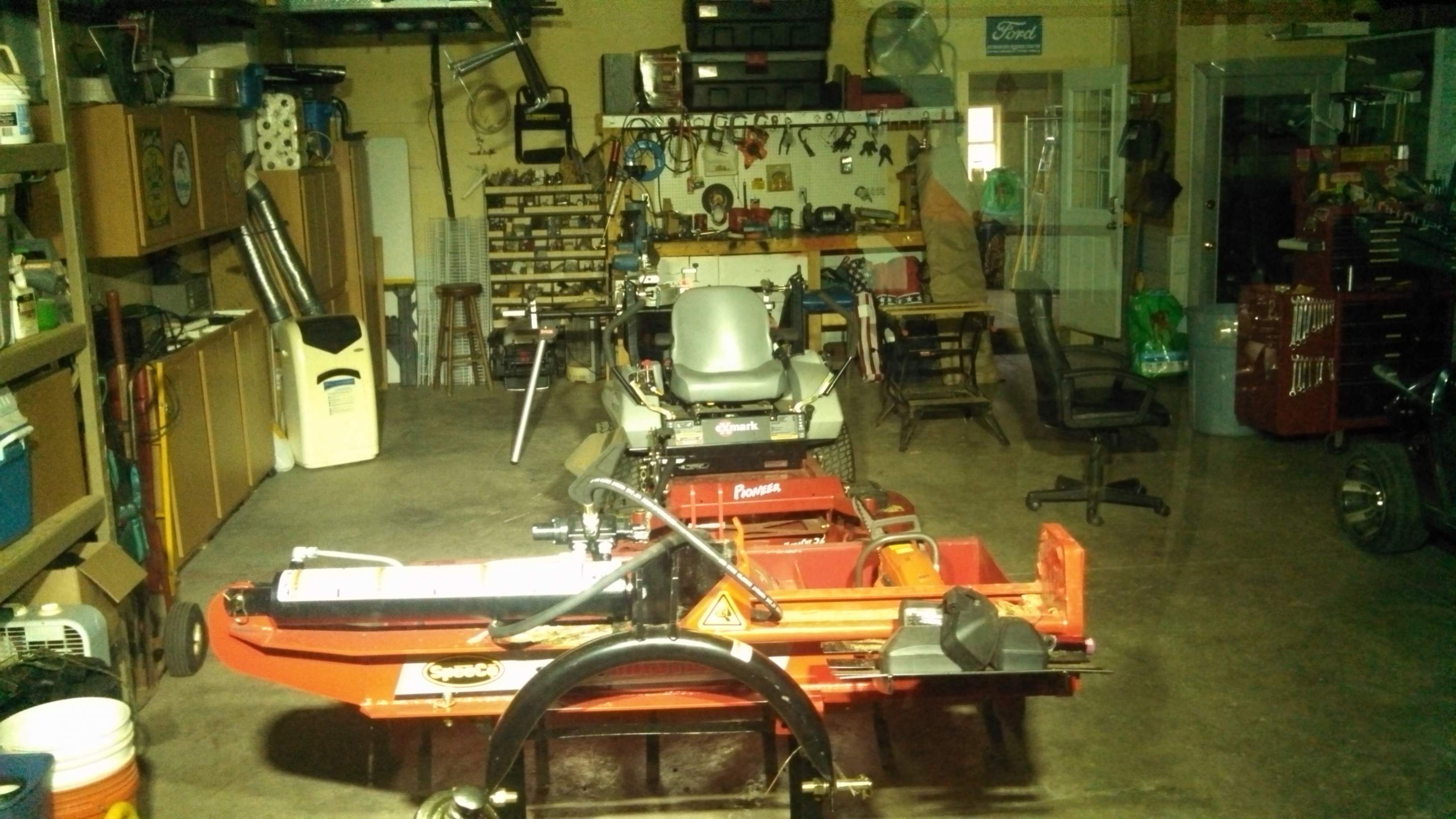

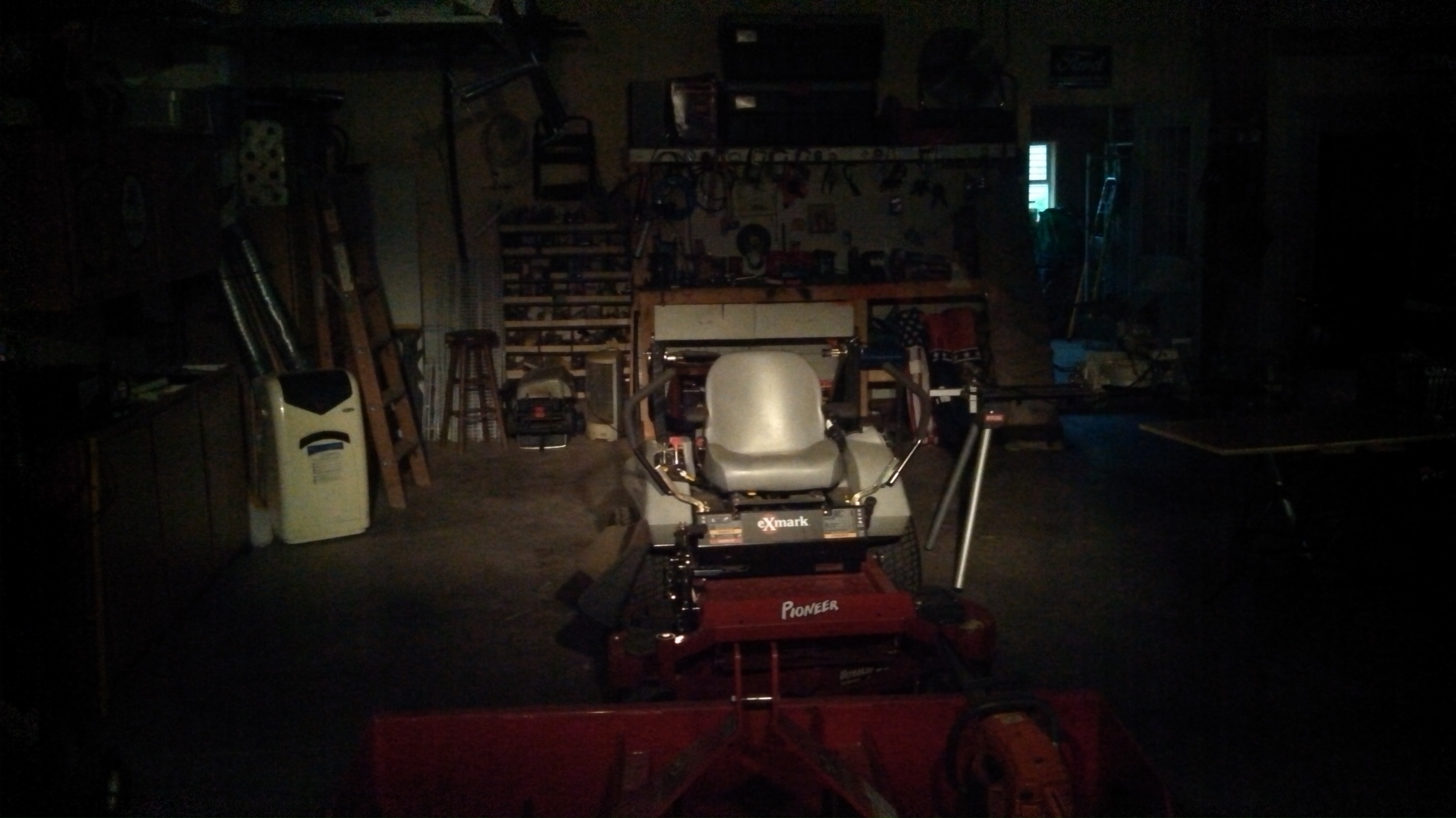

/ Let there be light, lots and lots and lots of light! #49
