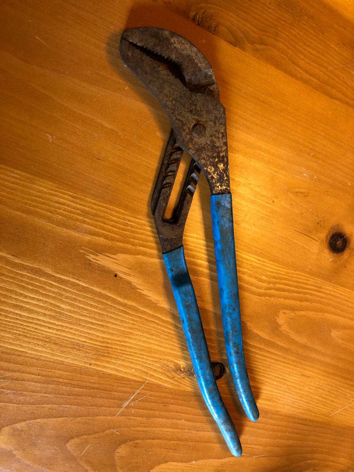

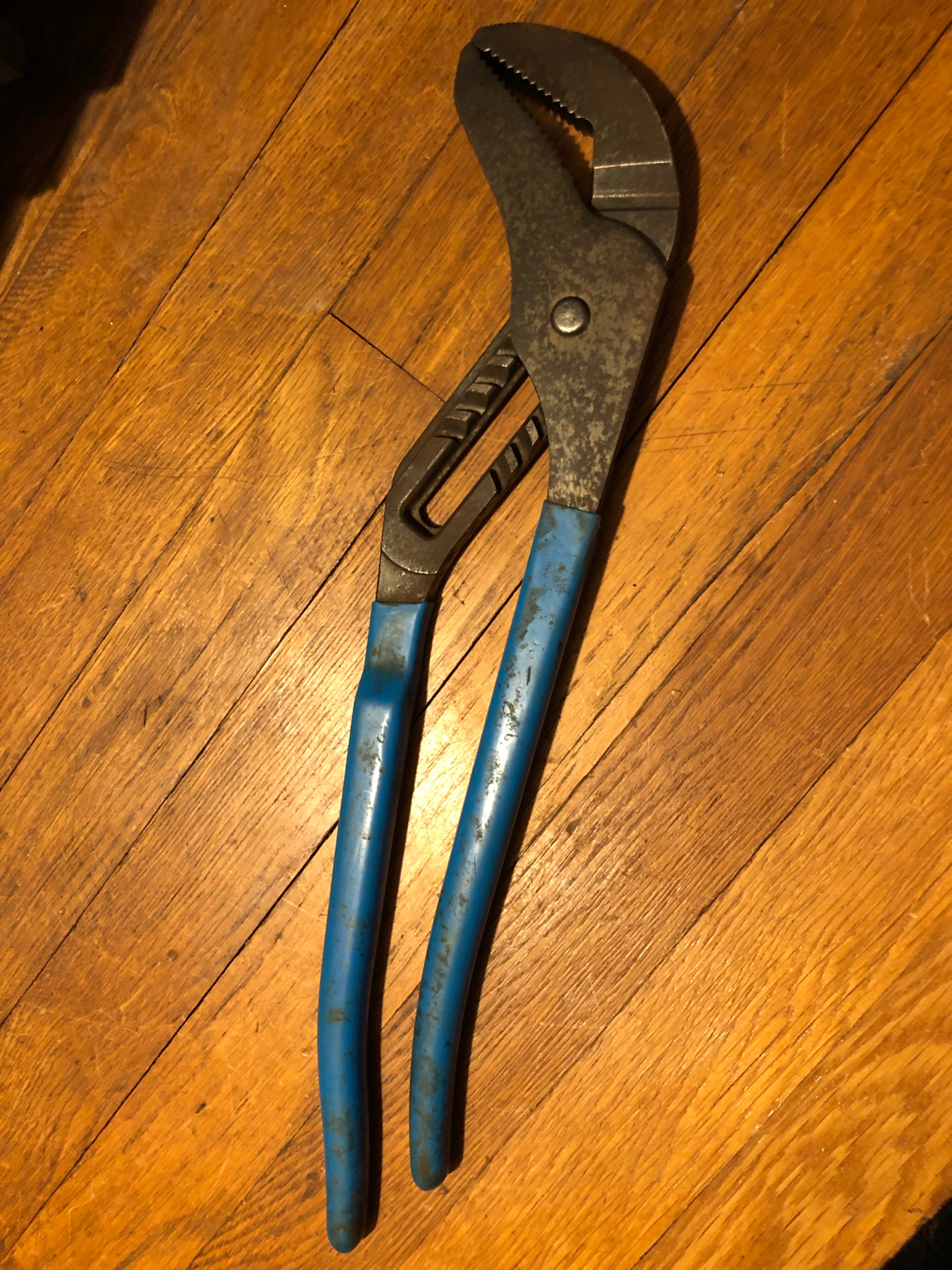

Nothing too special, Channellock 460, but a lady was putting out “FREE” things at the end of her driveway, I asked if she was really giving these away, her reply was, “yes, take em!” They were a lil bit crusty, but I’ve wire brushed and oiled them, good as new functionality.

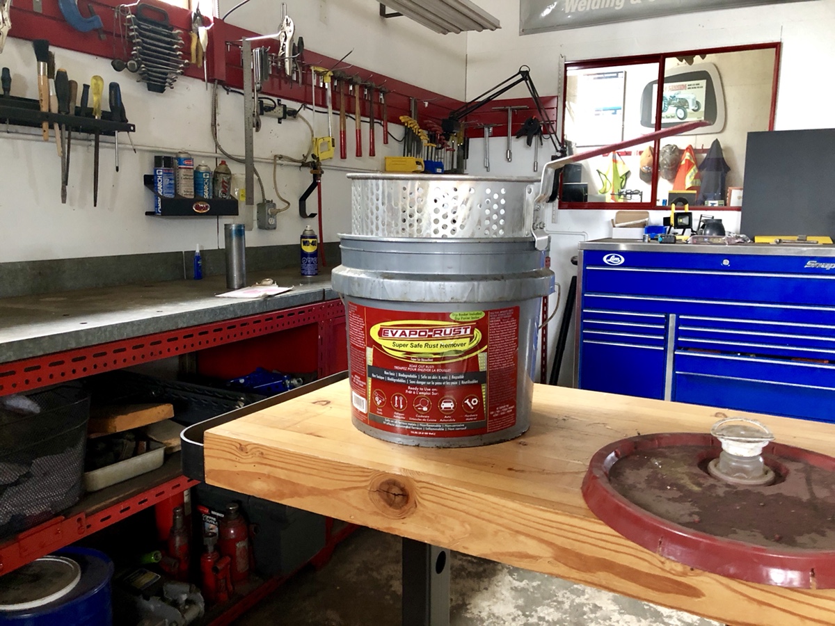

I’ve never tried that stuff.
This however works and is what I currently like using.

Evaporust is convenient for smaller parts and can be reused. Overnight soaking does the trick. Using a basket for soaking makes it easy.

But I've never used it on something with rubber handles like those channel locks. So what would you do? Cut off the handles and re-dip in that rubber stuff? Or just leave the handles on? I suppose they'd insulate from any electrolysis from happening anyway, wouldn't it?
