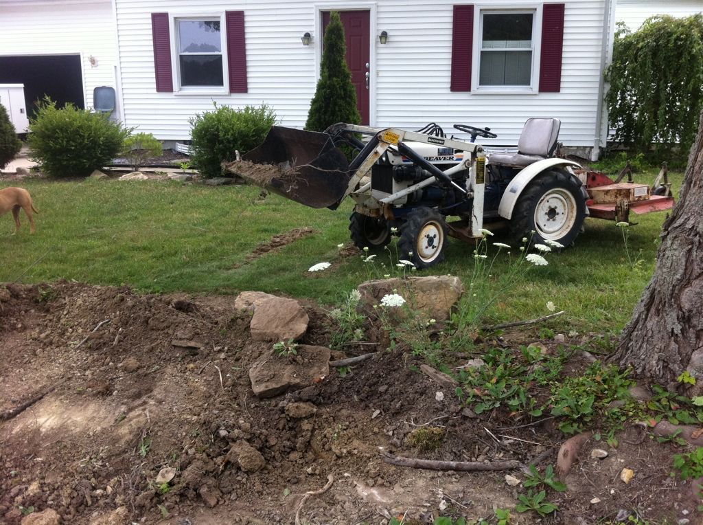

They don't make any tires that have the depth of tread the original Brigestones had.
some updated pics of my beavers...
and my newest addition....
