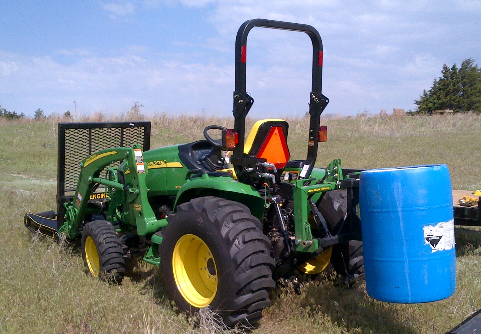

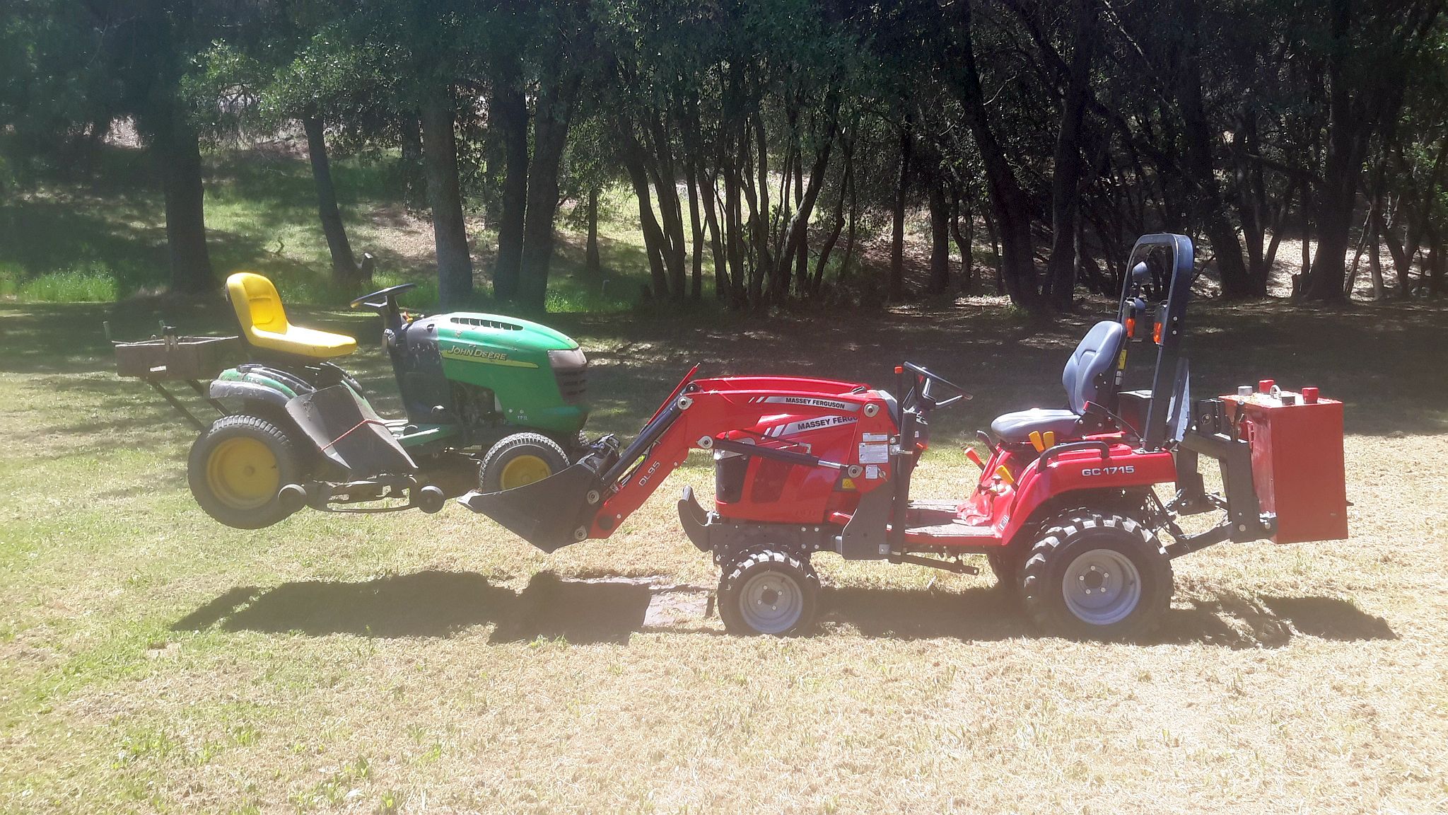

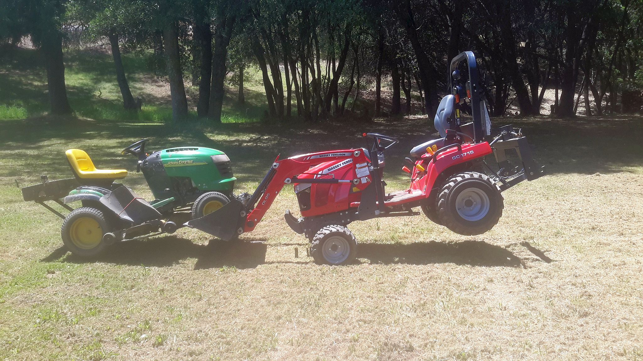

This is why ballast so is important....
NO ballast box...
About 500 pound ballast box...
Don't panic, these pic were staged under controlled conditions...
JD L120 weighs in at about 520 pounds according to JD...
Dale

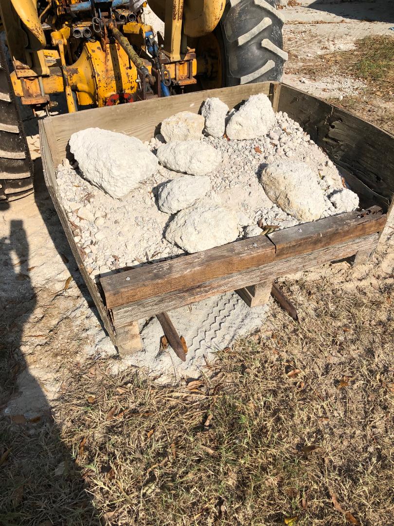

This is my ballast box. It is a 3' by 4' pallet box made of scrap treated lumber and plywood. It is carried on my rear pallet forks, which also come in handy for carrying other stuff like round bales, fence posts, etc.

Mine. About 1/2 ton
