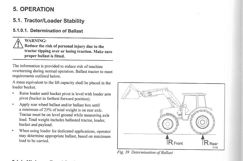

I have bombed around yard with the 500 lb ballast on tractor and bucket (FEL) empty and not had any steering problems or noticed front wheels off ground....
Also keep in mind FEL is not a "digging" tool its a scoop up and lift and dump tool...
Also this is what my NF manual says about determining size of ballast...

It would be nice to have a way to calculate the correct/best weight
The pivot point is the rear wheels.. the lever arm on a counterweight is so so so much shorter than it is to the loader pins.
If you wanted, measure from rear wheels to the loader pins. Measure from the rear wheels to the end of the 3pt arms. Divide one by the other (front/rear). Multiply that by your expected (max?) loader capacity.
I'd bet that you run out of 3pt capacity before reaching counterweight maxes. Mines like 1200# and is no issue on my L3940.

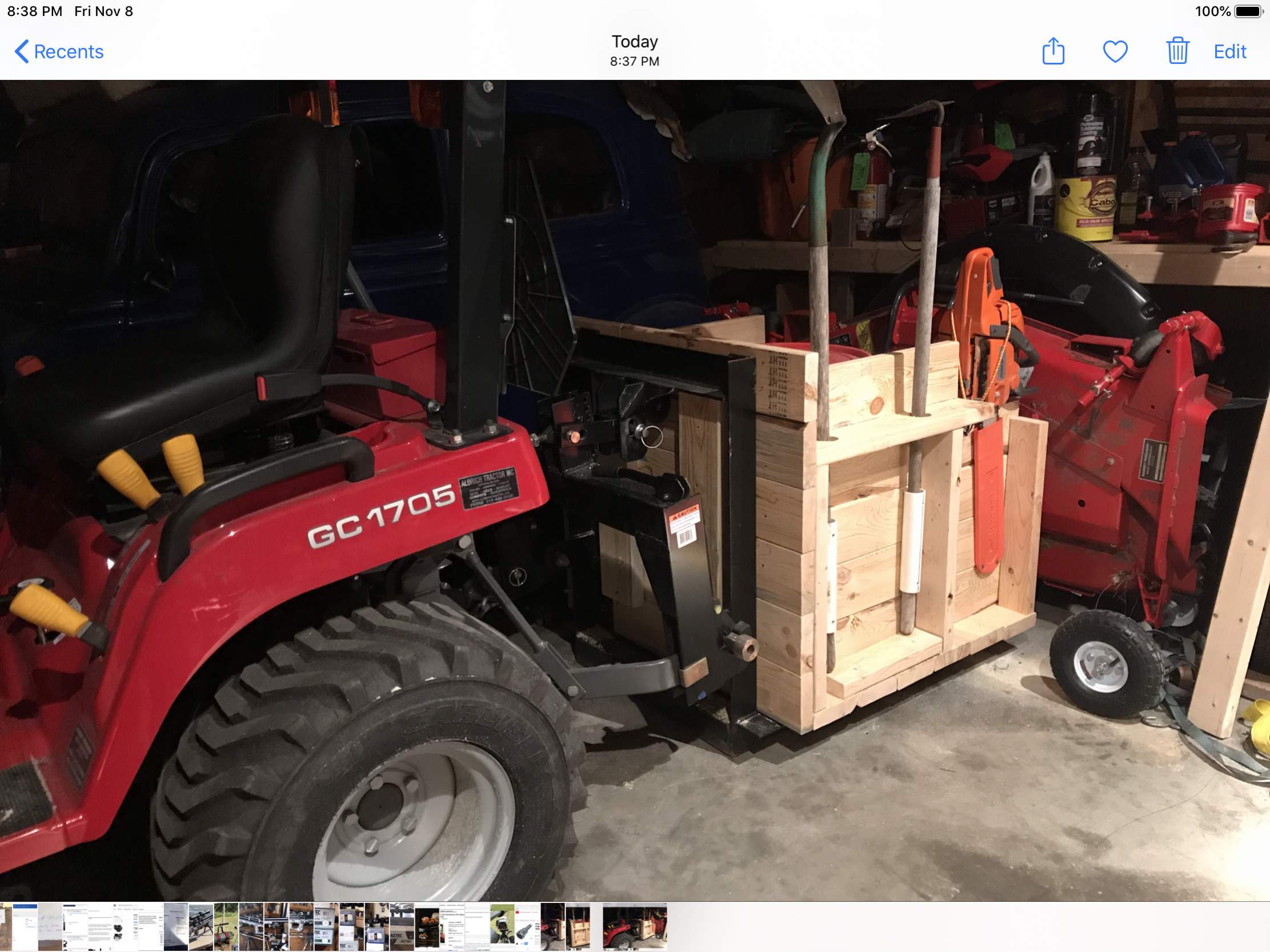

I ended up building this 3pt box that I can put a 30 gal barrel in filled with water or sand for extra ballast if needed.

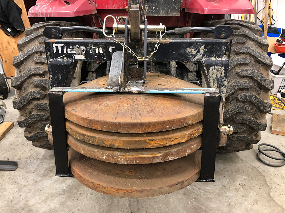

Here's the one I made for our 1526 tractor. Each iron disc is 200#. Bolted through a 26" drawbar with steel framework to hold it all in line. Needs some more paint and finish the brace on other side of the hook. At full down it clears level ground but needs to be raised for hills. Fits in really tight to the quick hitch which is great for clearance in tight spots. Couldn't fit all the weights on top of the drawbar so one had to go underneath. Tractor does much better with loads in the FEL bucket and forks.
   / Let's see some homemade 3 point ballast! #160
You are probably going to hate me but I would be tempted to just bolt the 26" bar to the top of all of those weights and not bother with the frame work. Then it's really easy to set on the ground to remove/reattach.
