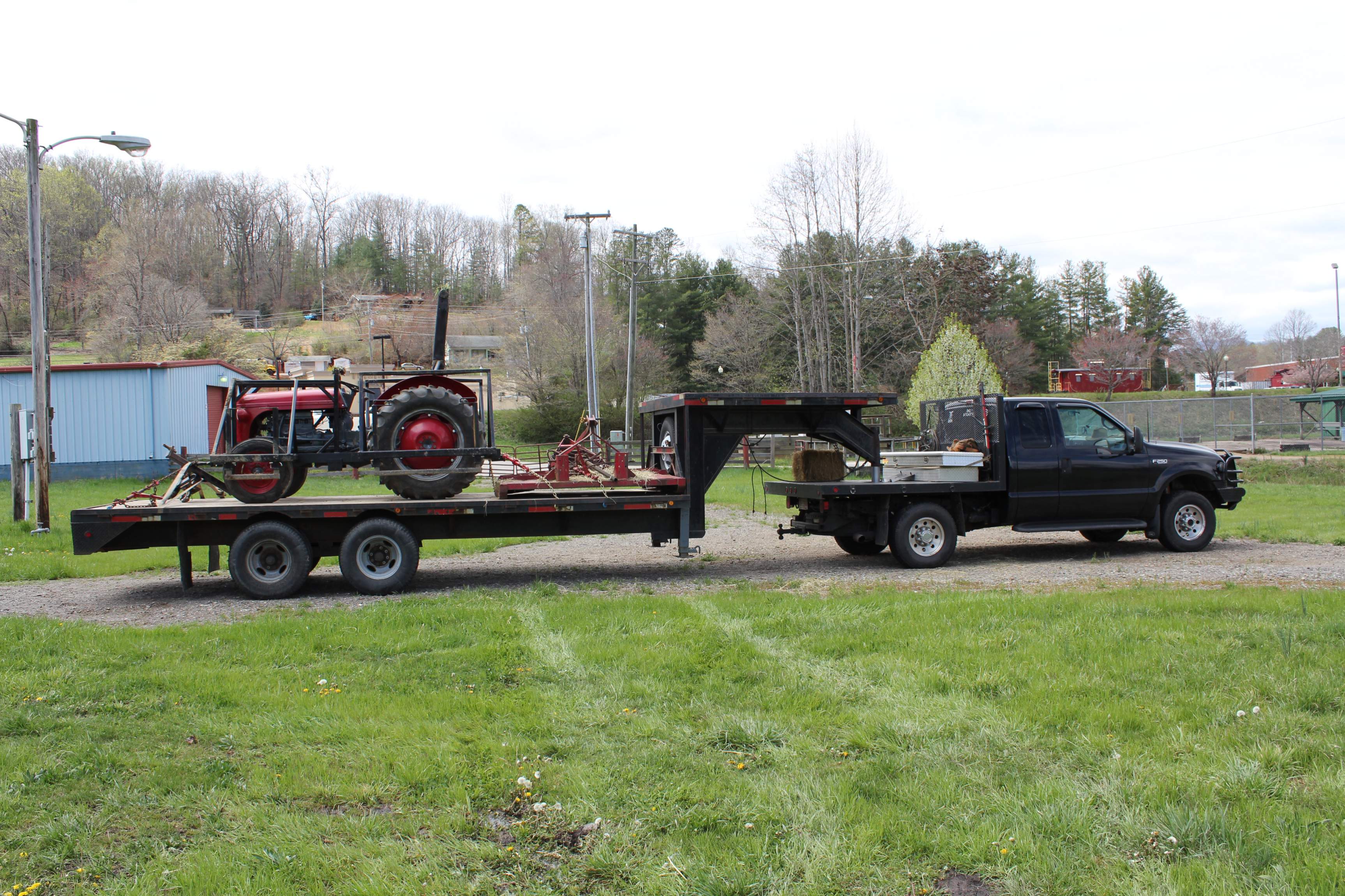

IMG_4592.jpgATTACH]IMG_4592.jpgOk, here is mine. 99 F250 SD V10, extended cab 4x4. Bed was replaced last year, old bed rusted too bad to fix when I repainted the cab. Added the Ranch Hand bumper at the same time. Bed is off an older truck cut down to about 7' from the 9' original. Frame is 3" channel, deck is about 1/8" plate. The headboard is just squared. The bed is a dump, goose neck ball frame mounted, accessible through a flip out of the way plate. Use rear air bags, on board compressor. Normally have stake sides, 18" high. Truck is my daily driver, love the dump for firewood, mulch, gravel. DO not think I would go back to a regular bed. Side note- Tractor is an old Ferguson that we use for rollover demos. The cage protects the tractor, we roll once with the roll bar up, dummy belted in like recommended, then we take the roll bar off and roll it again. First one dummy survives, second one-he gets squished. Very effective demo for farm programs, especially youth. We just pull the tractor over with another tractor. One of my retirement "jobs". Built by our local ag research station. The bush hog is used for PTO shaft demos, we wrap up a dummy around the shaft. again, very graphic, always get comments, especially with older farmers( I know someone who did that, here are some scars, had my shirt ripped off, ect.)

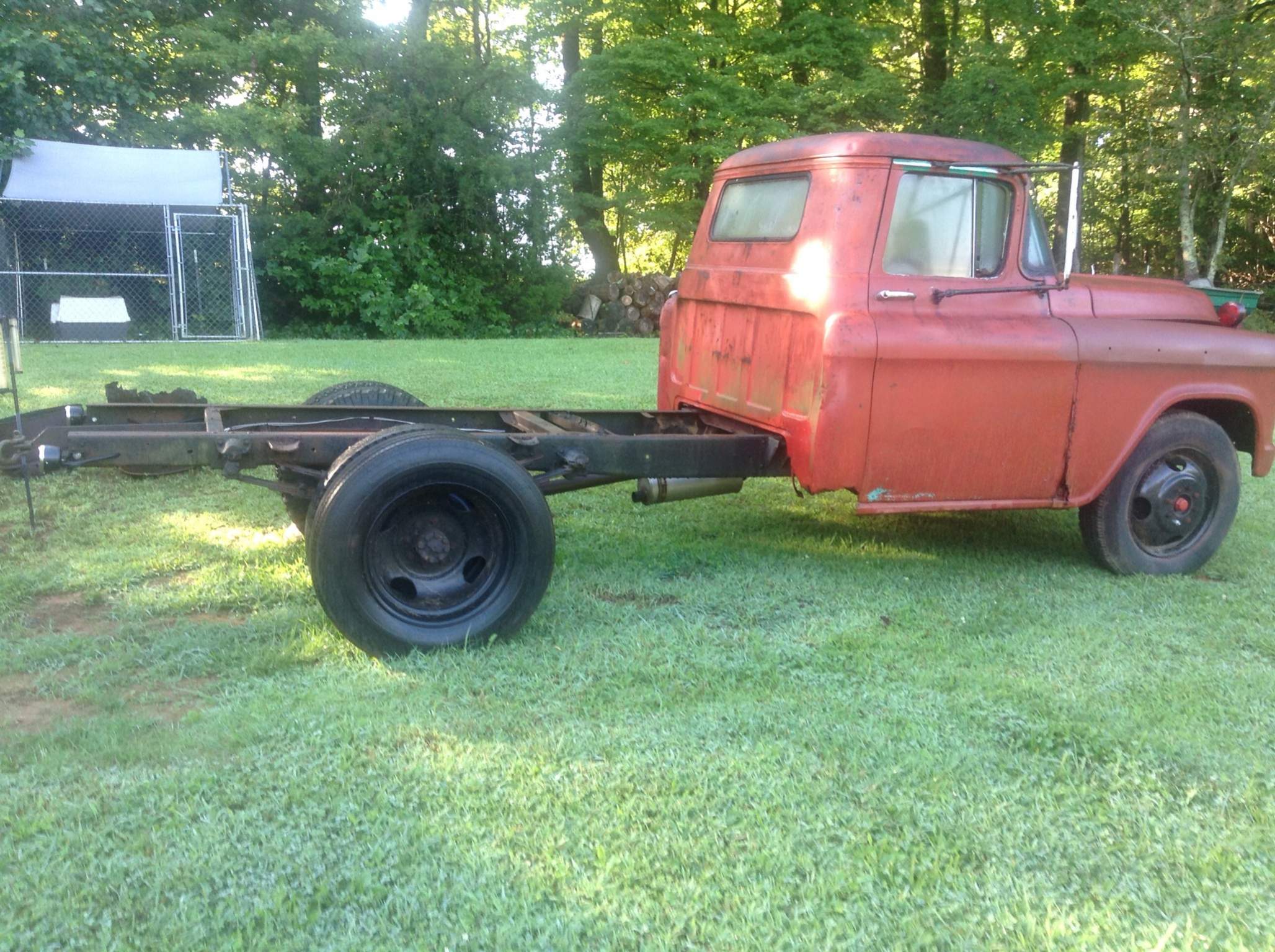

Hoping to get this road worthy as it would be a hoot to run to town in.
