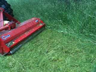

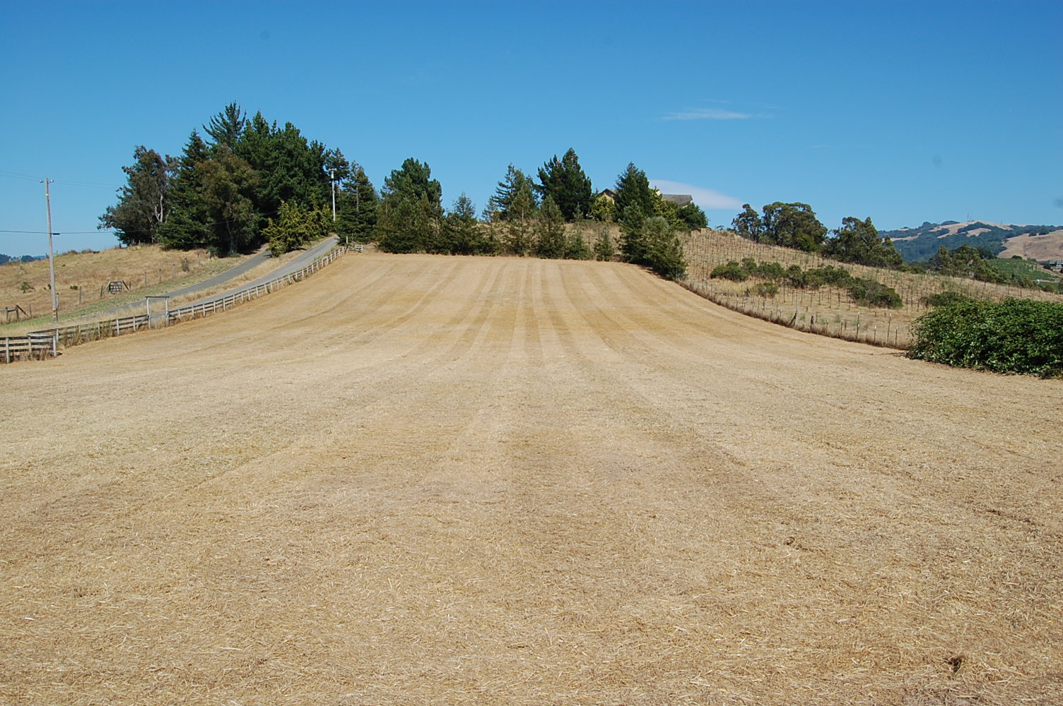

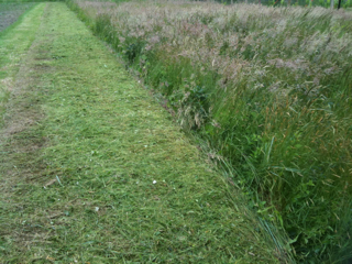

The Caroni should be fine for your acreage even with long intervals between mowing. It won't leave the land looking like a golf course but it is much better than what a bush hog does. I mow typically every 6-8 weeks and in some areas just once a year. Just don't mow when it is wet. I'll repost a few photos showing what it looks like below.

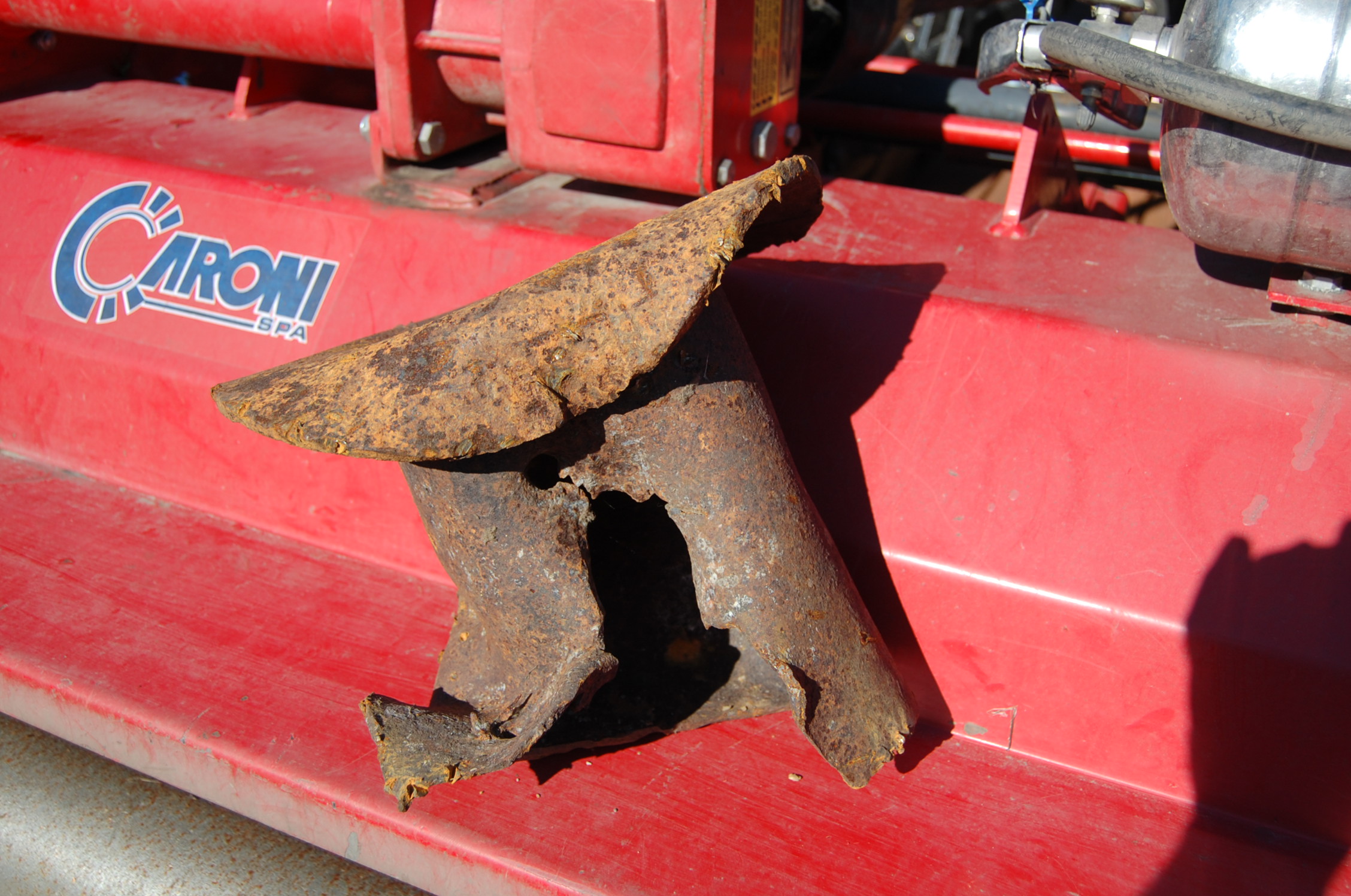

If you are used to maintenance free bush hogs you will need to readjust however. Greasing of bearings (2 minutes) each day and periodic replacement of drive belts (about $50 every few seasons) are routine maintenance requirements. Blade replacement intervals will depend on how many obstructions you hit. Some guys seem to go forever without needing blade maintenance when mowing pastures. Others, myself included, mow in rocky areas and I probably replace about one set of two blades and clevis every four or five acres mown. If you have read through the whole 1947 posts before yours, you are probably aware that the Caroni supplied clevises used to hold blades are not as durable as those sold by Flailmaster (but which require minor modification to fit).
Based on my experience, the Caroni will certainly fix your problem with clumping. I would probably still use the bush hog to do first cutting of the 10 acres of thicket even though the flail can do that work too simply to save on broken clevises/blades.
