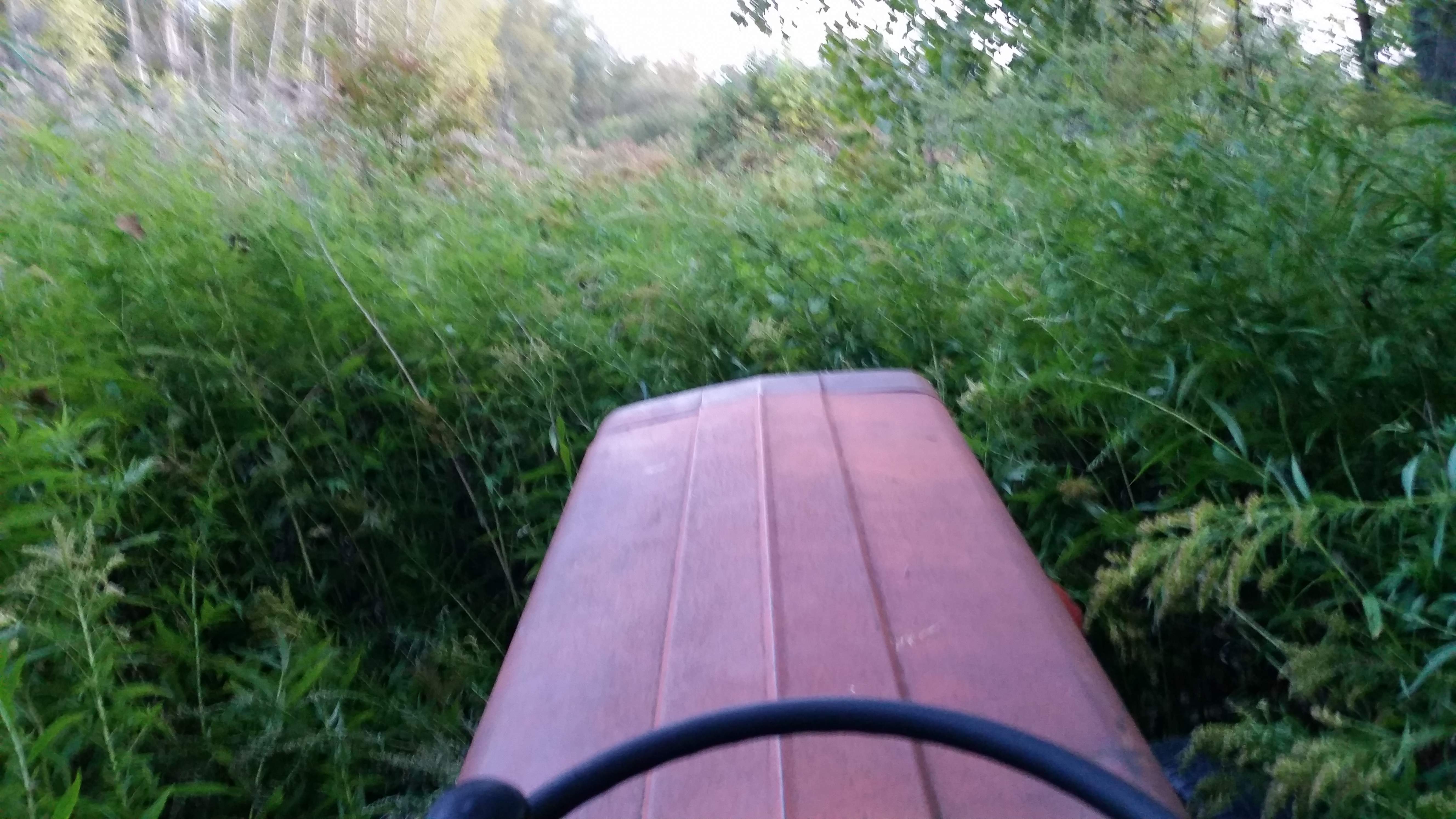

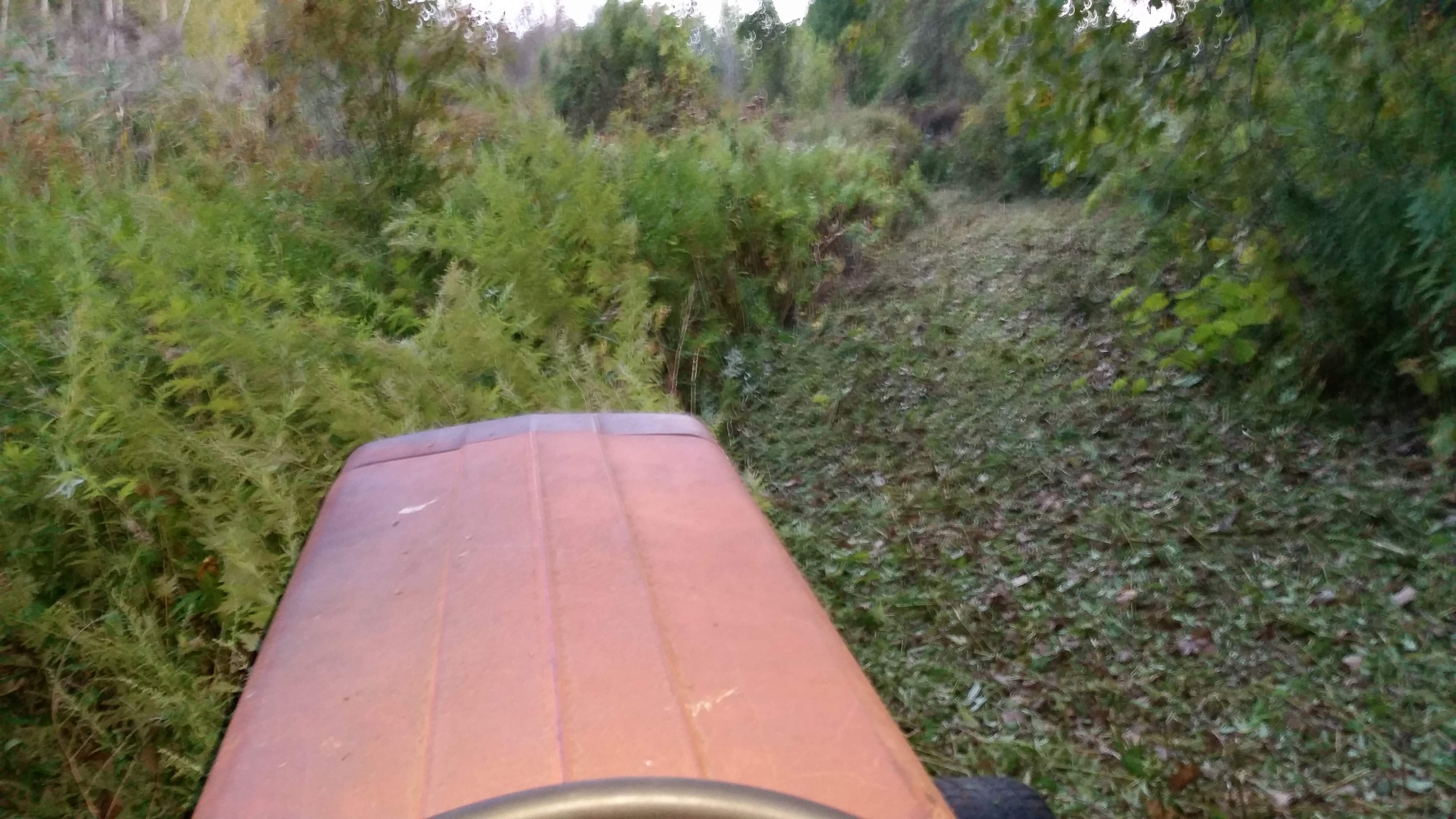

So with my mower and tractor together at last, I horsed the tractor around enough to get the hitch lined up and connected, and took a shot at clearing the jungle. I had been told by more than one person that this tractor wasn't powerful enough for this flail, so I was wondering how this would work out - would I be happy enough with it, or would I end up selling and getting a brush hog with the proceeds? I plunged headlong into the weeds (some well over my head when I'm on foot) and realized I'd forgotten to lower the mower, so I dropped it down, and went ahead a few seconds and looked back - and was shocked at the clear path that lay behind me! This thing was amazing! After all the struggles I've had doing the same sort of "clearing" with a Cub Cadet 123 garden tractor with oversize 44" deck, and with a John Deere 425AWS with a 48" deck, and a John Deere 48" walk behind "yellow deck" commercial mower, with all the clogging, backing up and taking another push at it I was used to, almost muscling the mower through with force of will (and gallons of sweat), to just drive forward through the dense vegetation and have the machine just chew it up without complaint was a shock. I had a few troubles with some old wood chunks/logs, and some thicker saplings. I did chew through a sapling that was probably 1-1/2 to maybe 2" thick, but it took a moment, made quite a racket, and there were a few sparks seen coming from under the flail, so I may have caused myself some grief. Still, I suppose replacing a few knives once in a while is a fair price to pay for going through such a mess.
And a little while later.

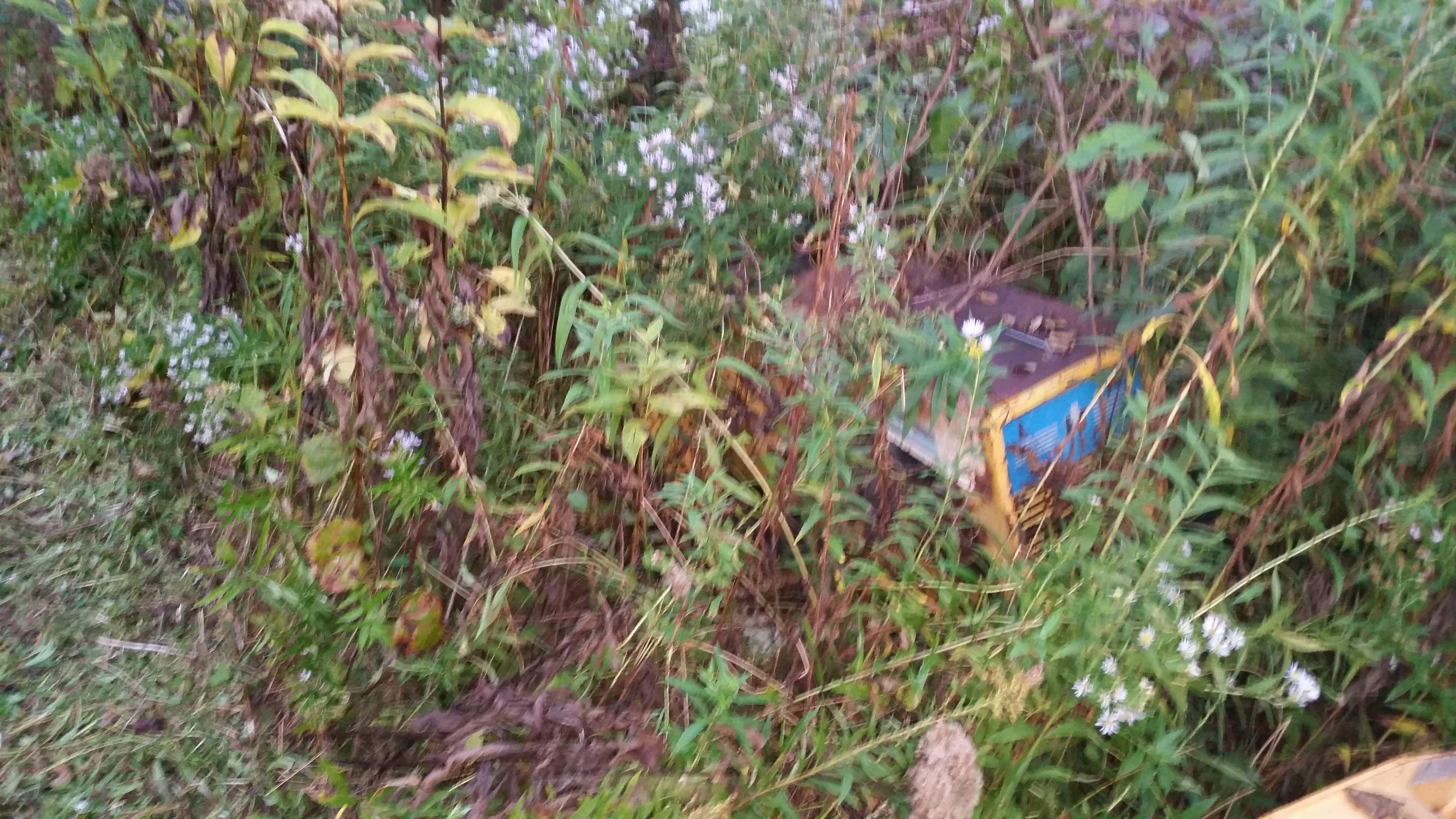

I even found the long-lost Cub Cadet 123, which I failed to locate a few weeks ago (couldn't even get close!) I'm lucky I didn't run right into it!

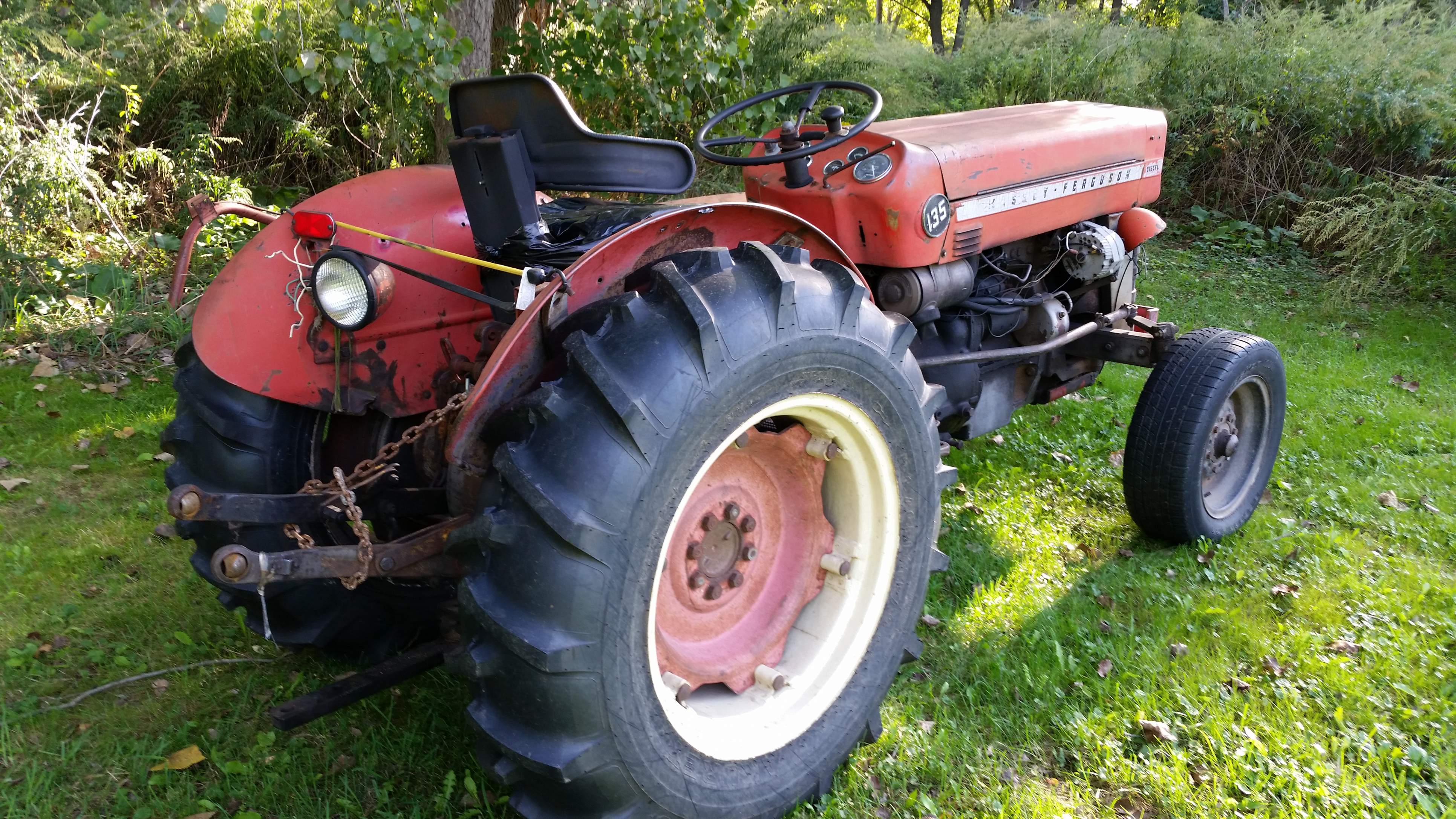

The tractor is awesome, and because the seller needed it for his harvest work longer than he expected, he ended up replacing the rear tire that still had tread, but was REALLY badly cracked and deteriorating on the sidewalls. Major bonus for waiting! This thing won't win any beauty contests, but to me it's gorgeous!
I've got some inexpensive LED lights I got on Amazon that I hope will do well for me (the YouTube video reviews I saw seemed very promising, they looked brighter than halogen car headlights) that draw 27W each, because when I'm working out in a field, I always push it until the very last glimmer of light, and then I still have to get back to the house. Tonight I did that with a pocket flashlight, and when I came upon a tree with low-hanging branches with thorns, AND a steep ditch nearby, with me a very new tractor operator, things got scary very quickly. I can see the wisdom in wearing leather gloves and a sturdy shirt, like denim, so that a sticker tree doesn't distract me right when I need to be most careful.

Scott, I use those 27W LED lights on my tractor, and they are great. I have 2 facing forward and 1 facing rear, and they light up the place like a football game at night. You won't be disappointed.

Looks like it did a GREAT job!!! I am currently looking for a similar Motts/Alamo mower for working around the house and am glad to see it worked so well for you.

That's what I'm talking about! A 135 is a good match for an SHD74. There was company here that had a fleet of SHD74's and MF245's which is basically a newer 135 with about 4 more HP. If you tried that with a 6' bush hog you wouldn't get far. An MF255 would run a SHD88 and a one sided 74 Interstater wing. Now imagine doing that with an Interstater with three 74" flails at the same time. That's similar conditions my dad demo'd the first Interstater in to the city of Edmonton except it was mostly tall grass and weeds. He said give me your worst field. Their jaws dropped! That's how my dad set a sales record for Interstaters. He sold over 40 of the first 100 made. I think it was 46 but not sure on the exact number. The city had no problem recommending them to other municipalities.

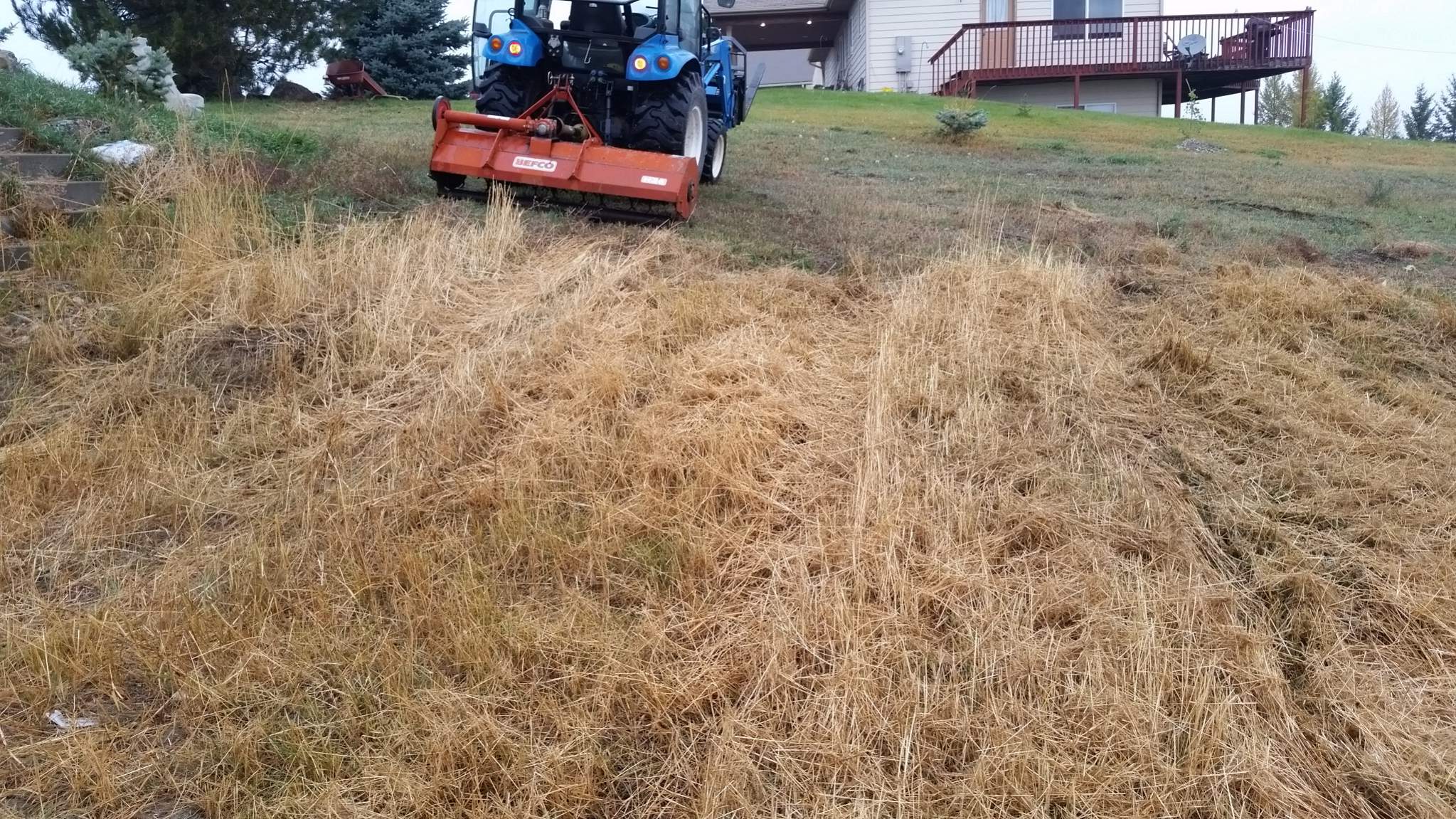

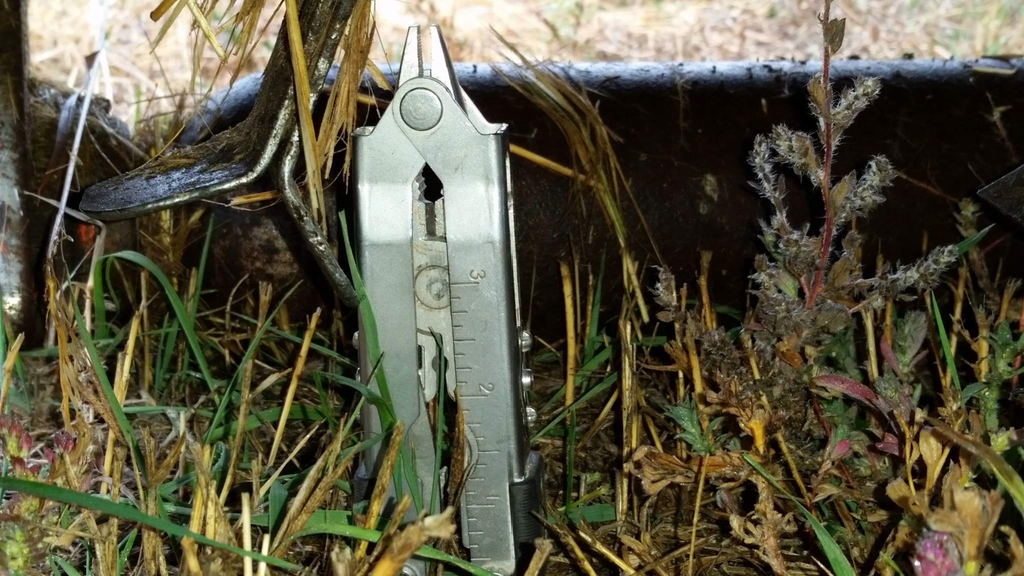

So Leonz, What in the **** am i doing wrong? Running rated speed, Good flails, 3" set height and half the ground speed i would be running with a rotary and the finish looks HORRIBLE!
