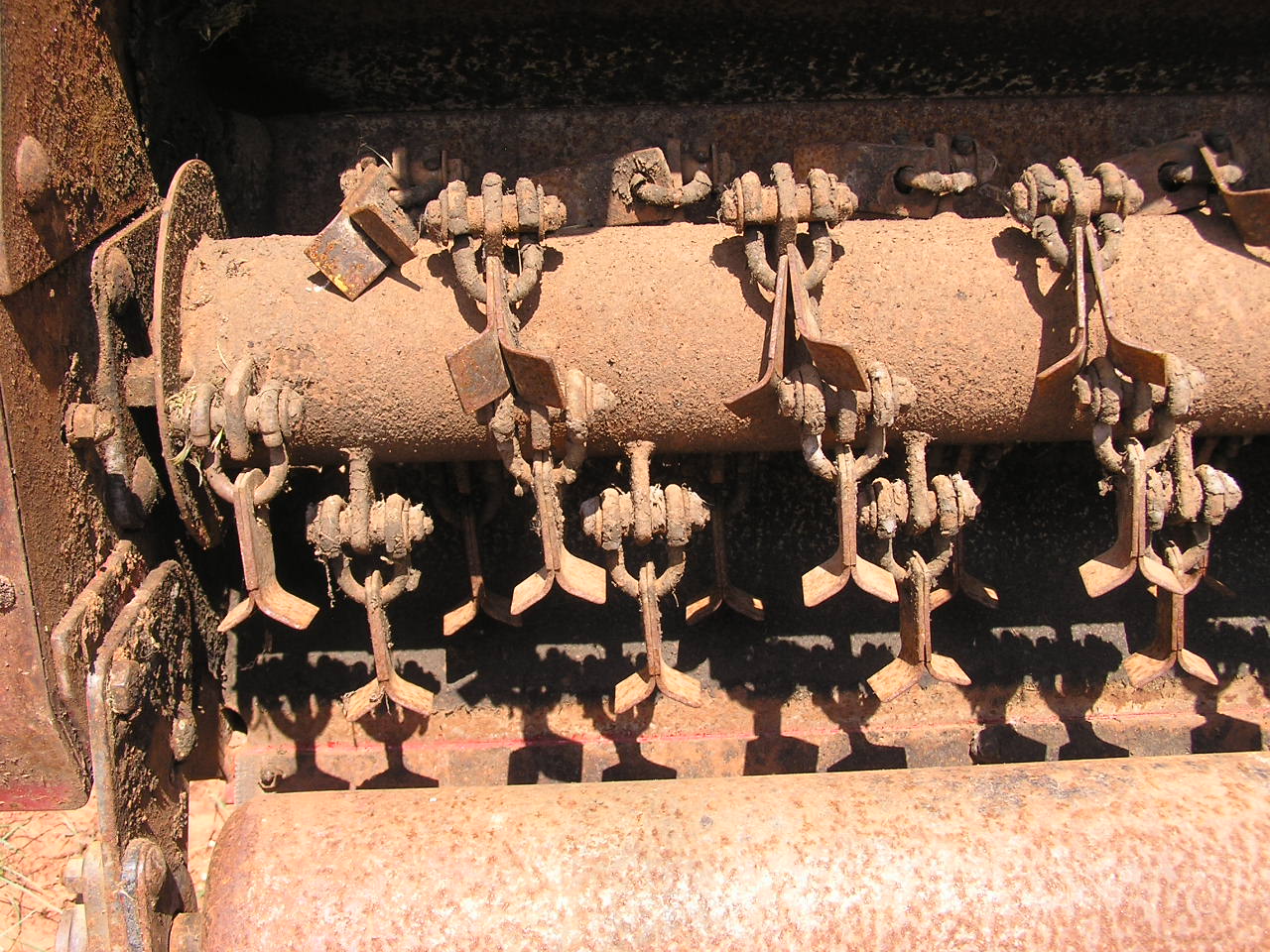

What do people keep on hand for spare parts? When I buy the mower, how many extra shackles and y blades should I buy to replace broken ones when they break.

For spares, that largely depends on where you use the a flail. If you cut all grass areas like me I'll likely go years without needing anything, if you are in areas with branches, stumps, rocks, etc.. you'll want to keep a reasonable amount on hand.

I've had a Caroni TM1900 for ten seasons. My experience is more like what Leonz describes. Roy has been lucky or is just mowing a well cared for pasture I suspect. I mow in a rocky area (Rhode Island, thank you Ice Age) and I go through at least a dozen blades a season. I used to go through the Caroni supplied clevises like popsicles on a summer day but I've had much better luck with US made 3/8" clevises (that require about 5 minutes of modification with a big vise or press and a grinder to fit). Now I still lose an occasional blade (they break) but I don't lose the whole set (clevis plus two blades) that I did when using the Caroni replacement parts. I buy my spares from Flailmaster. Don't recall the product numbers but if you search this thread back a few years you'll find the specifics.

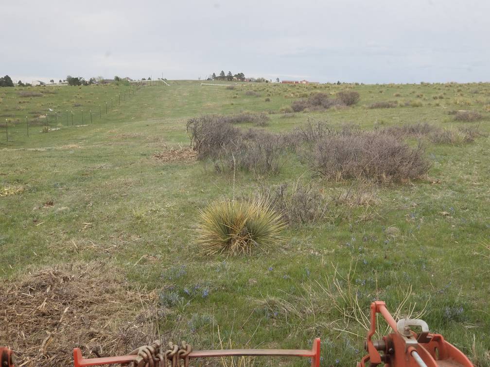

My WoodMaxx FM78 shipped yesterday and I can't wait to try it out. I didn't go with the side shift. I have fences bordering my ten acres but I keep them sprayed where need be and the neighbor's hay burners eat most anything under the remaining fences. Besides, the FM-78 is offset to one side already. My only concern was loading onto my trailer. After some careful measuring and seeing how much I could swing and pin my three point arms to one side, I think I am good there.
