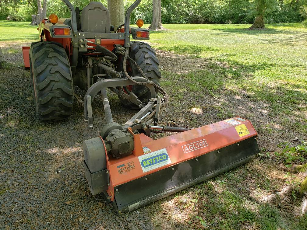

I can open it on my computer and iphone. Try again.
You can also bend up the rear portion of the skid plate, it's functionally useless so it might as well be bent out of the way.

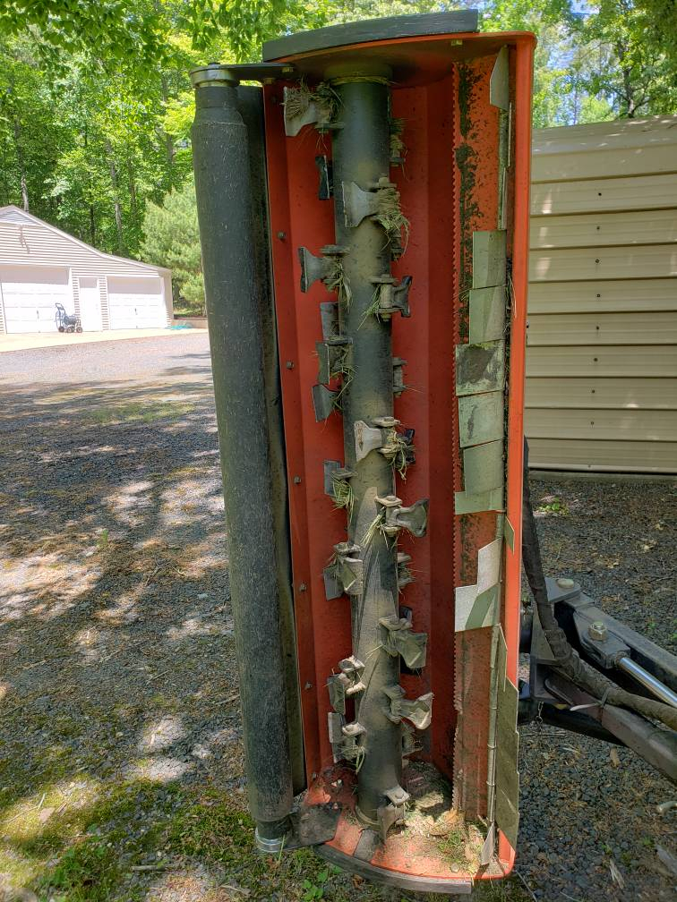

Personally if I were OCD enough to weigh all the hammers, I'd drill a hole on the back to remove material & equalize weight. That way order wouldn't matter & everything would balance as well or better.
Weighing is easy with my wife's digital kitchen scale which measures to the nearest 0.5 gram.
I plan to adjust my new spare set by grinding the tops of the diagonal surface (shoulder?) running from the vertical stem to the scoop part of the blade. I have already done that with some of the spares. It does not take much time to grind off 30 grams. The new spare set ranges from 1,033 to 1,056 grams, so I'll make them around 1,033. I'll adjust the old set when I switch them with the new set. I did not do it this time because I wanted to get the trail mowed for access for firewood.
The weight range for my existing 36 blades (2 sets of 16 plus 4 spares) was 1,003 to 1,072. I don't know what range will cause a problem. I would not even have thought of it where it not for Jack Yuan's comment in the post referenced above. It seems like a good idea, and not a lot of effort, to get them fairly close in weight.
The main cause for bashing up my first set was inexperience in setting the mower for different conditions and in monitoring the cutting height on rough terrain. I've also gone back and removed protruding rocks on the places I mow most frequently. So repair grinding (as opposed to sharpening/touchup) effort should decrease. Even so, I will likely rotate the sets at least once per year.

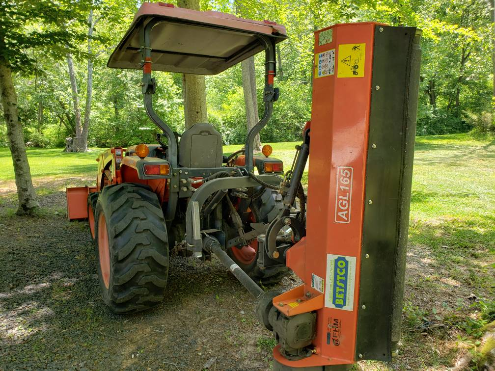

I know i saw this in one of the posts but could not find it. Those of u with caroni flail mowers, in which hole do u run the rear roller? I remeber also it was discussed about lack of access to the grease fittings.
I took a heavy hammer to the skid and bent juuuust enough to allow grease gun access.
It was easier than i expected it to be.
