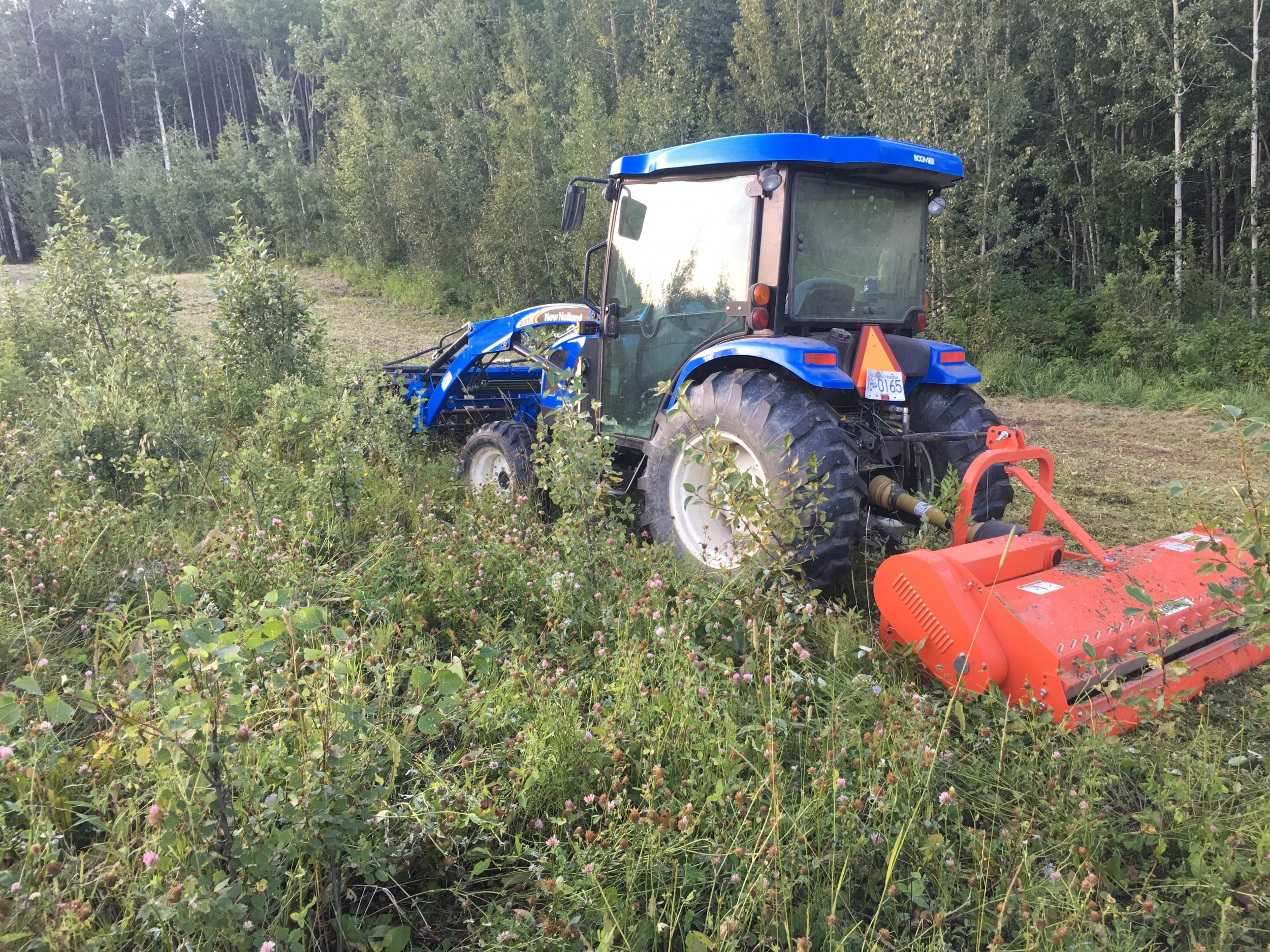

OK I am narrowing my choices. There is the Peruzzo brand Elk Cross Series and Fox Cross series Ditch Bank Flail Mowers and a Maschio Girafetta 160SI . I did find out the difference between the SI and SE The SE the gearbox is outboard of the mower body and the SI is inborad in the traditional spot. Is anyone running the Peruzzo brand units? There is only about $500 between the three of them.
Thanks for any help
