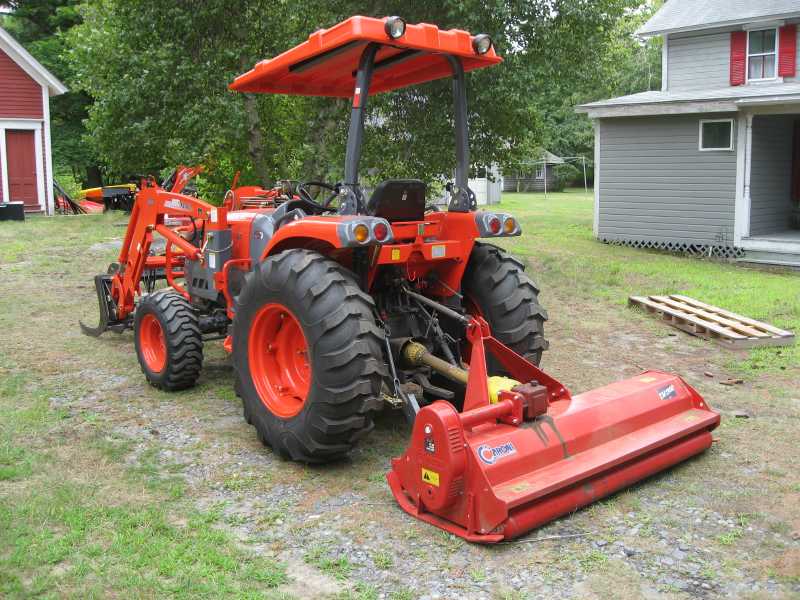

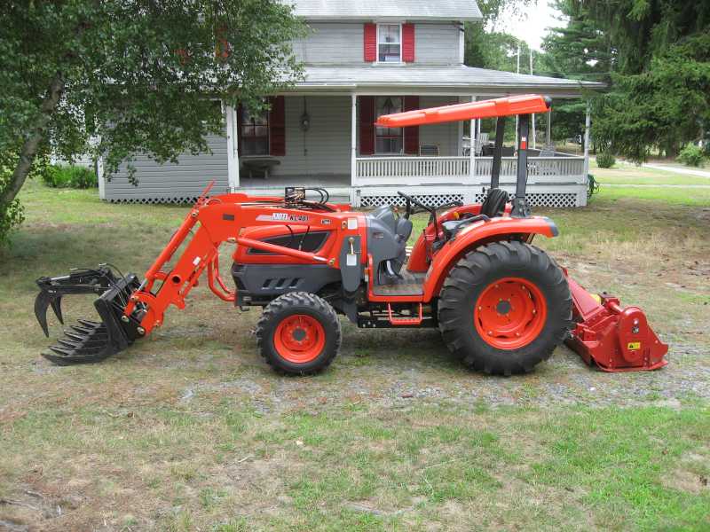

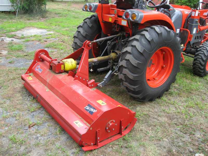

IslandTractor said:
Measurements: Mower itself is 75 inches. Skid to skid is outside measurement is 79 inches. The mower would require 79+ inch wide door way.
I forgot to mention that there is a bulge on the left side caused by the drive belt cover. For shipping purposes the mower is probably about 81 inches but because of the offset and because the left side of the mower is within the wheelbase of the tractor, that is not relevant for getting through doors.
I don't know if you could adjust your 3pt hitch to minimize the overhang on the right. My tractor has outside rear wheel width/track of 70 inches and I'd guess the mower is offset by more than 9", more like 12-13" in my case.
I don't have an issue as my barn doors open pretty wide but I wonder if backing in at an angle to get the mower overhang in first might make garaging possible in a tight squeeze.
Interesting thought...
On a dirt floor, maybe bring it in tight to the right hand side and hit the right brake just before the mower hits the jamb ?
If that works figure a strategy for getting it out again - like back the overhanging mower out on the slant and then hitting a steering brake to spin the tractor ?

Reg said:
On a dirt floor, maybe bring it in tight to the right hand side and hit the right brake just before the mower hits the jamb ? If that works figure a strategy for getting it out again - like back the overhanging mower out on the slant and then hitting a steering brake to spin the tractor ?
Sounds complicated. It be easier just to weld on another set of implement lift pin brackets that would simply center the mower. It's a trade off; the offset tthat mows up close, for the ability to get through a door.
//greg//
Sounds logical but be careful of the gearbox location. It is already set up so that the gearbox normally is off center (look closely at some of the photos I posted). This is so that when you extend the mower further to the right that the PTO can still reach. If you tried to move the mower further to the left than it is already you'd have to insure that the angle between tractor PTO and gearbox is acceptable.
