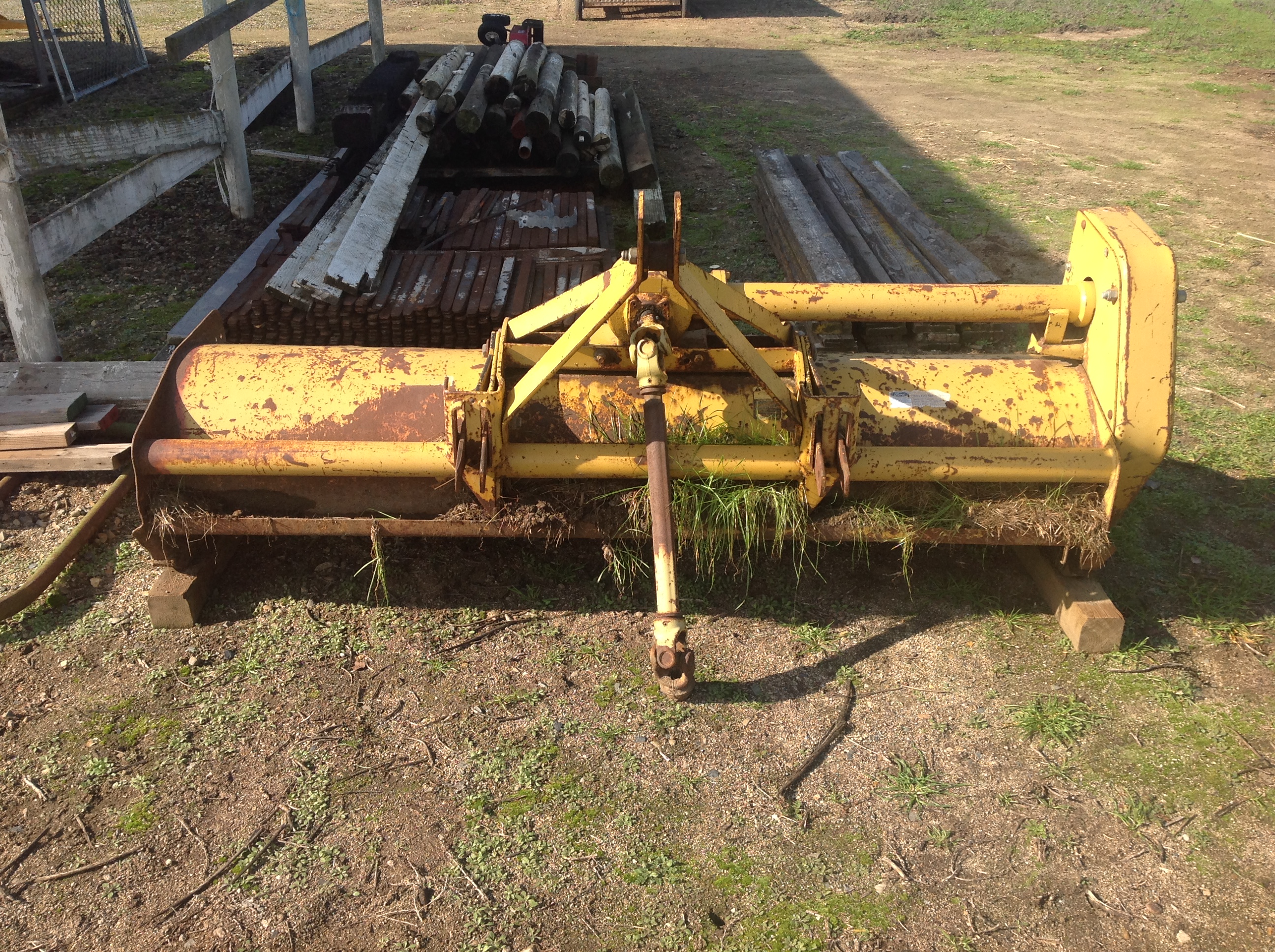

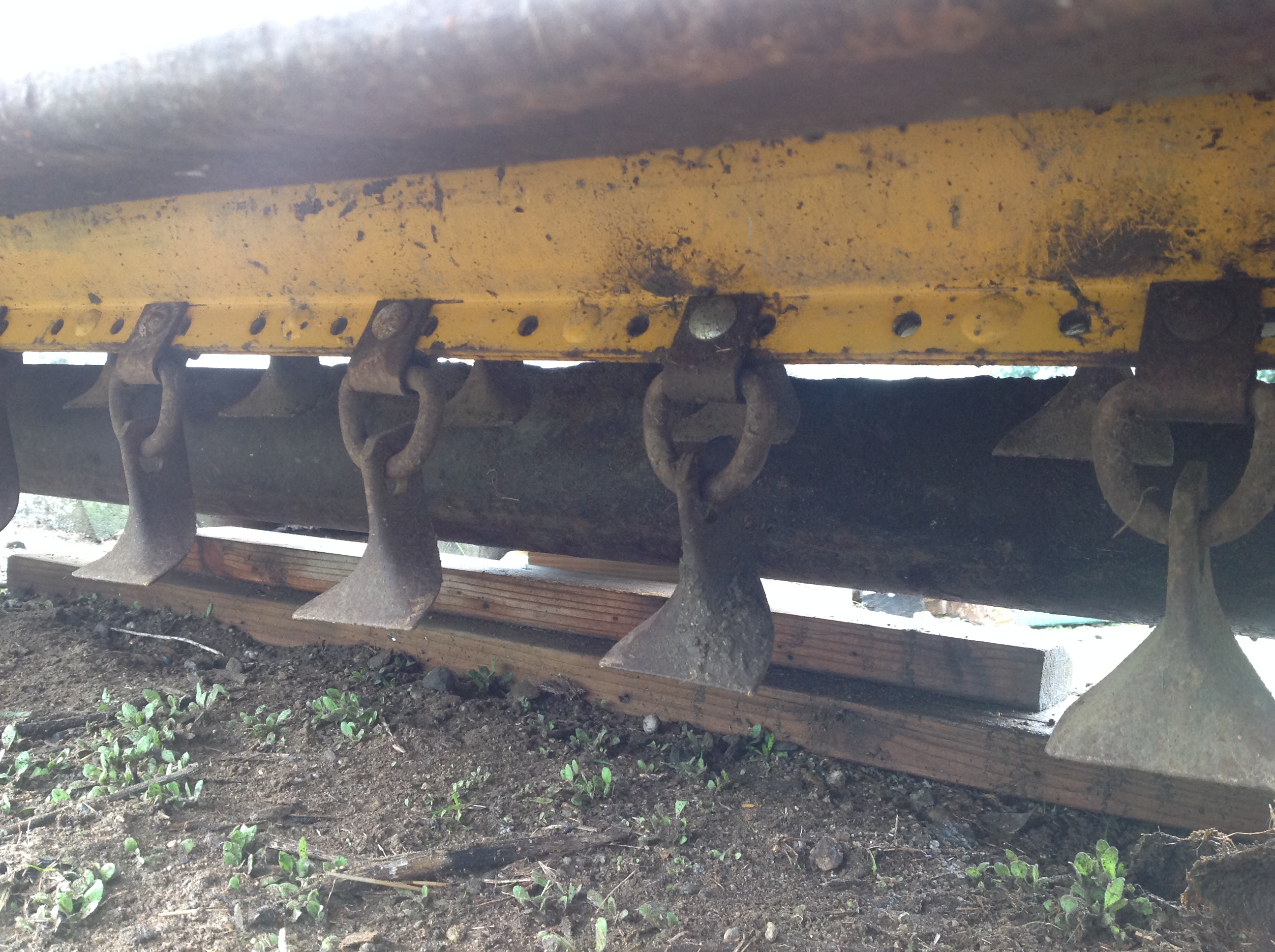

This flail mower was purchased with my Massey Ferguson 30B and I never got a chance to use it bacause the tractor broke down, after servicing the flail mower I just hooked it up to my John Deere a much smaller tractor and the drum is rotating the same direction as my tires, and as you can see by the picture of the blades it won't cut grass in that direction.
Do all tractors have the same PTO rotation or is it as simple as someone installed the blades backwards.
View attachment 500299View attachment 500298
I want to welcome you as the newest resident member of the "Flail Mower Nations".
What you have is a Mott mower that can be converted to a finish flail mower which uses side slicer knives as well.
NOW;
Are you letting the rear roller touch the ground when mowing????
Those knives should be coated with grass dust and green grass stain.
The cutting height is set with the rear roller by positioning the rear roller in the pre drilled holes in the side weldment with the rear roller hangers.
IF your JD2032 is actually an ISEKI brand Mule in green paint it would rotate the PTO stub and PTO shaft clockwise.
The drum is referred to as a "Flail Mower Rotor"
The scoop knives are not backwards. We see this quite often and you can simply rotate the scoop knives and mow IF The tractor PTO is spinning it in the wrong direction.
Rotating the knives 180 degrees will throw the cut brush and grass forward which is fine but your going to get a lot of fine cut grass clippings tossed at the rear of the mule.

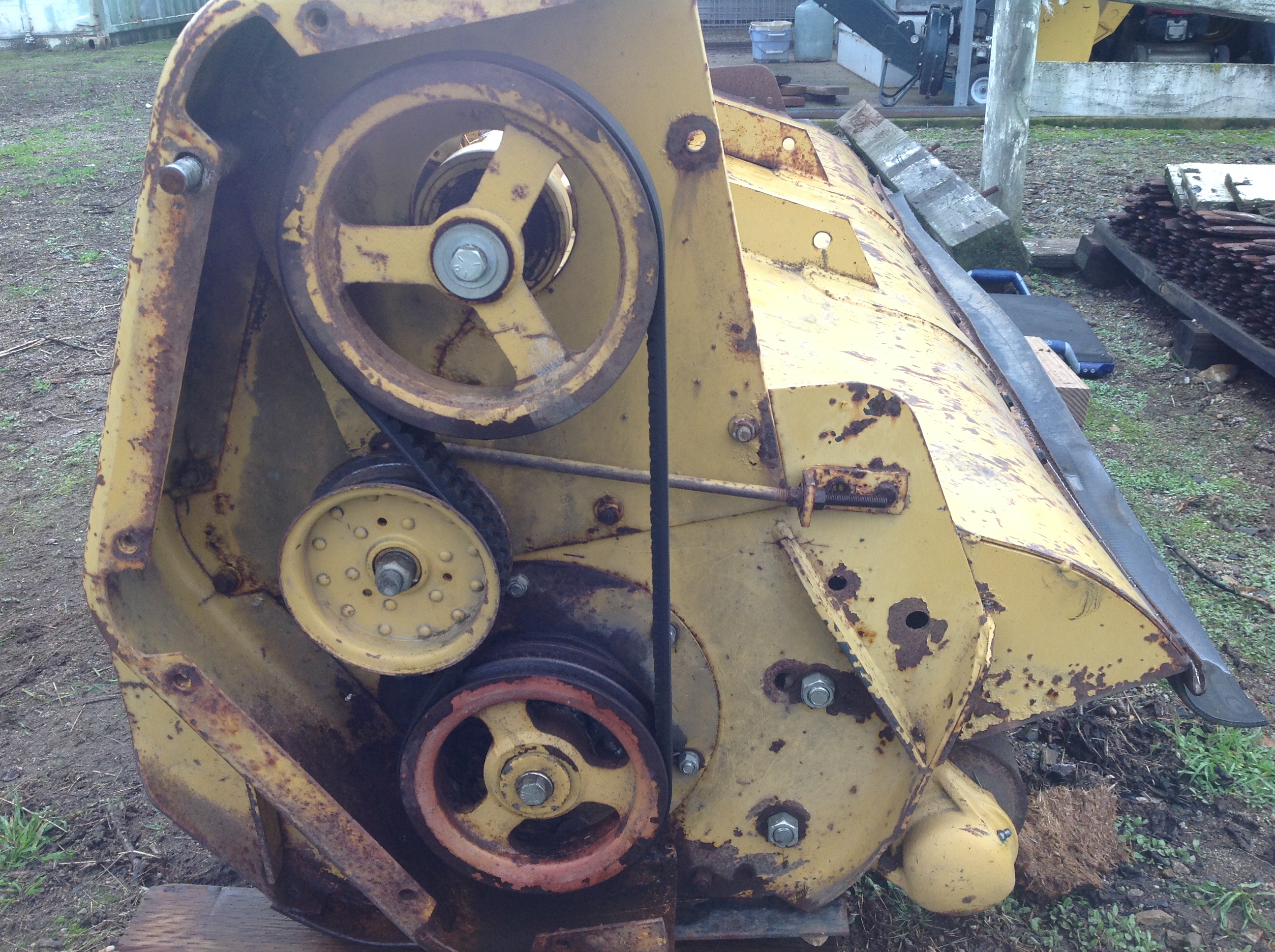

Just humor me and take the V belt cover off and verify the rotor is rotating counter clockwise by putting a dash of paint on either the snubber pulley or the driven pulley and rotating the flail mower rotor with the tractor PTO.
OH and if the V belt is cracked or rubber is peeling off it replace it soon as it wont last long. And remember not to drive fast as you will not cut much.
If the PTO is fine so just flip the scoop knives 180 degrees and happy mowing.
Thank you for your help, yes my PTO does turn clockwise, and with the tractor off I turned the drive shaft clockwise and watched the flail mower rotor turn the same direction as my wheels if I was driving forward, I did have the roller touching the ground and the skids were off the ground, I took one pass through the field and nothing happened, no cut grass. So tomorrow I will flip the blades and see what happens.
I'm still confused how those blades could cut in the direction that they are installed now, did someone install them wrong or am I not understanding something. Are their tractors with PTO's that turn counter clockwise.
What does MOTT stand for?
There are sure a lot of blades to flip, that does not look like fun.
Thanks again :)

As far as I know the Pto on all tractors turn the same way. As far as MOTT goes that was the man's name that invented the flail mower. I have a MOTT simular to yours and yes your blades (scoops) are on backwards. My rotor on the flail turns the same rotation as the tractor tires but my flail has side cutter knives instead of scoop. I enjoy using it because of the smooth finish and around here it's about time to get geared up for some cutting. Everything is greening up and ready to grow.
