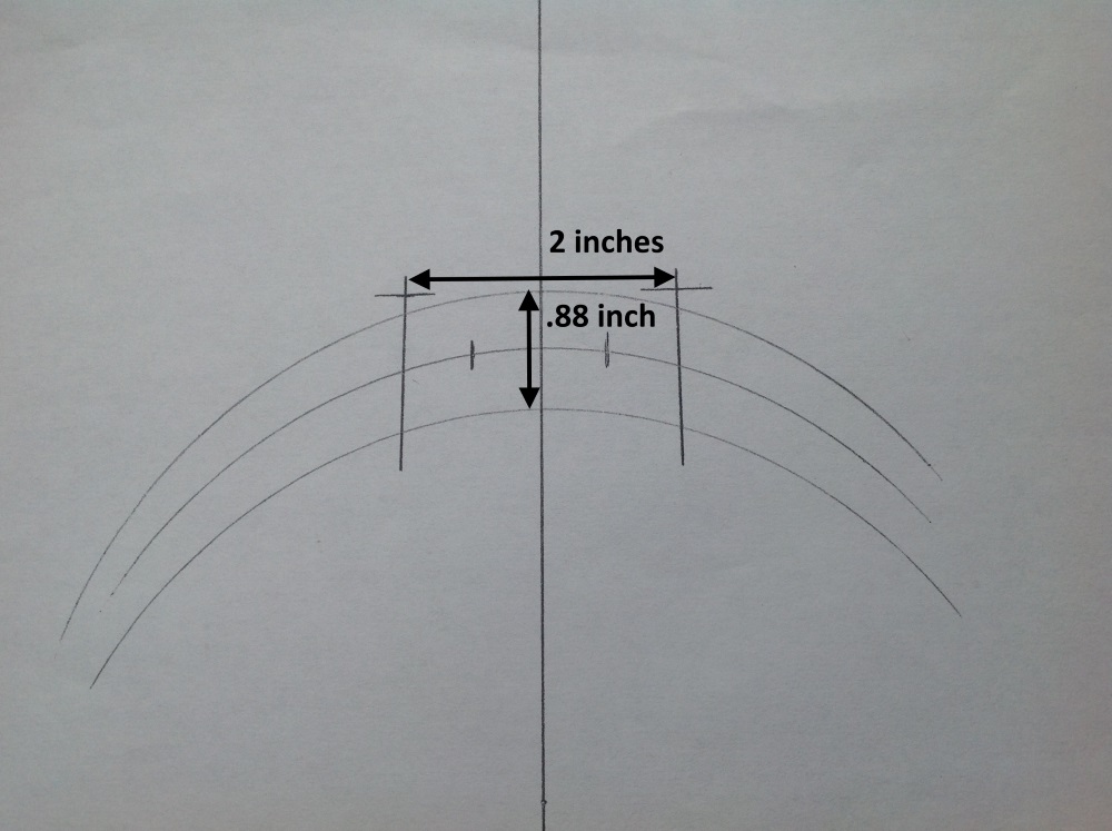

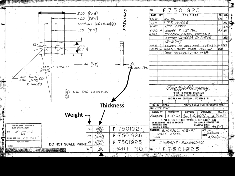

I don't understand, your weights look way too big and heavy. Where did you find the weight of .88? Nevermind, found it:
http://www.tractorbynet.com/forums/...alk-flail-mowers-post4704688.html#post4704688
Correct me if I am wrong. Looking at the print you posted, I see a weight that is 2" x .88" and comes in three thicknesses, .031 weight is .02, .125 weighs .07, and .250 weighs .15.
I would think the weights would be stacked using different thicknesses to balance the rotor, not using all of them shown in the parts list.
   / Let's talk flail mowers #4,343
I would think the weights would be stacked using different thicknesses to balance the rotor.
The manual says if you use fine cut blades the stacked weight should be 7/8" and if your using standard or course cut blades the stacked weights should be 1-15/32". The parts diagram shows 10-.250" thick, 2-.125" thick and 6-.031" thick, so each side should be 5-.250", 1-.125" and 3-.031" and those nine weights equal to 1-15/32" thick and total .88 lbs. The one thing I did not understand is why the weight did not come out as the print called for, and if they only needed two different size weights why did they make so many small weights.

Just did a search on the 1/4" part number: Bush Hog Part# F751925
I called my local tractor wrecking yard and they put a request on their computer system for the weights and I never heard back. The rotor is balanced with welded on weights and the adjustable weights are only used when using different styles of blades, so the owner is never really balancing anything, he is just keeping the rotor balanced when the amount of blades are increased or decreased using a different hole pattern.
