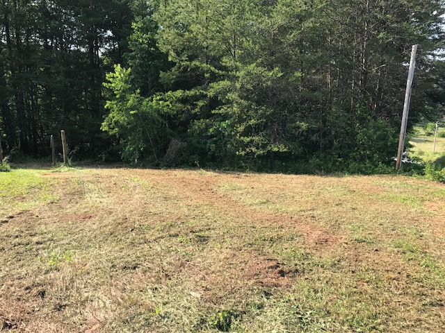

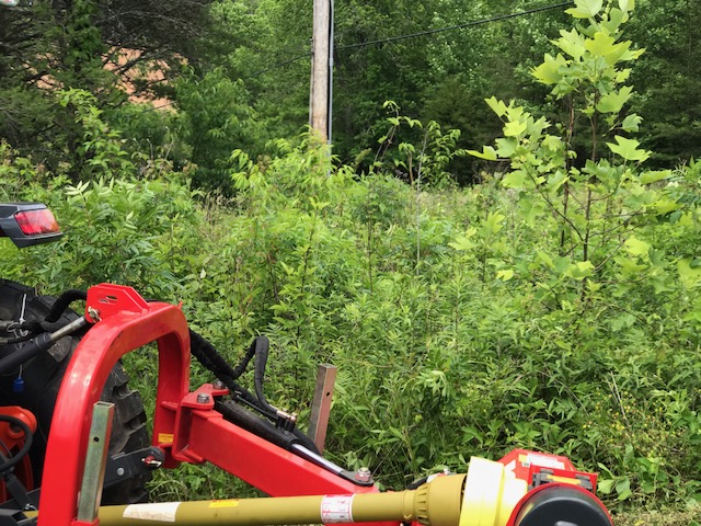

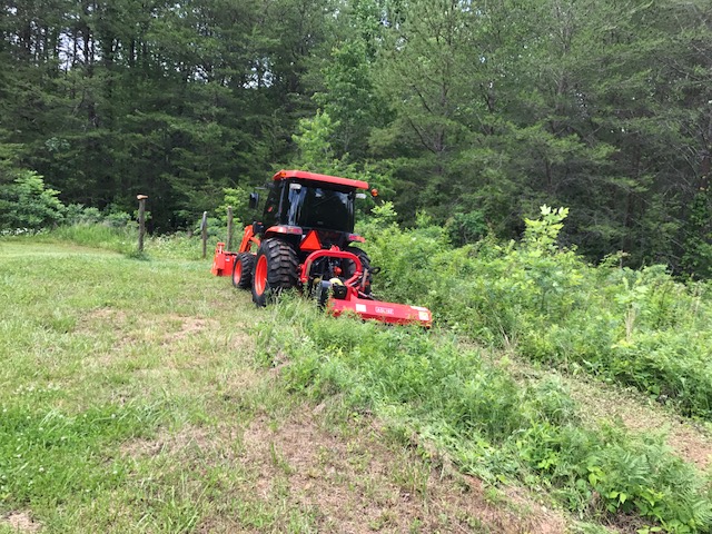

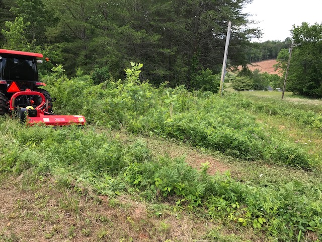

Mowing with my Kubota L4760 and my Chinese FHM 165 flail mower. IMG_1062[1].JPGIMG_1062[1].JPGIMG_1064[1].JPGIMG_1068[1].JPGIMG_1069[1].JPGIMG_1069[1].JPG

So I don't mow as much as IT and some of the others here, bought my Caroni 2-2 1/2 years ago. My first flail. Looking at your video, just tall weeds mostly Id say get the flail! Way nicer cut results, smaller weed pieces that decompose faster, and as long as you know where the big rocks and garbage is your caroni will do great. You ask about yearly cost to run... all I've spent is the cost of greasing. Haven't lost a knife or belt yet.
