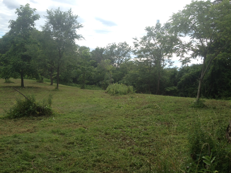

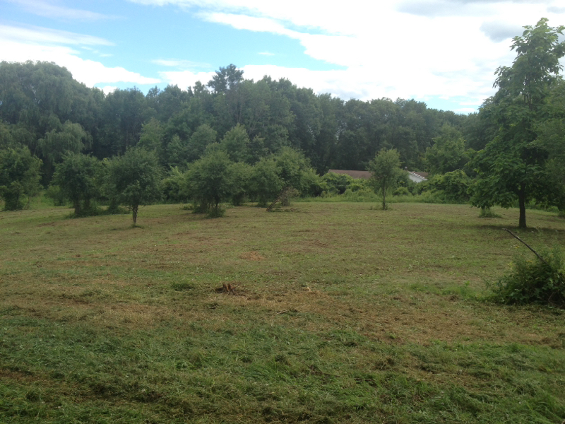

Welcome to the club, Clearsmoker!
I knocked my roughly 2 acre field down five weeks ago, then again a few days ago. Trying to get rid of a lot of the weeds and get it to remain field grass.

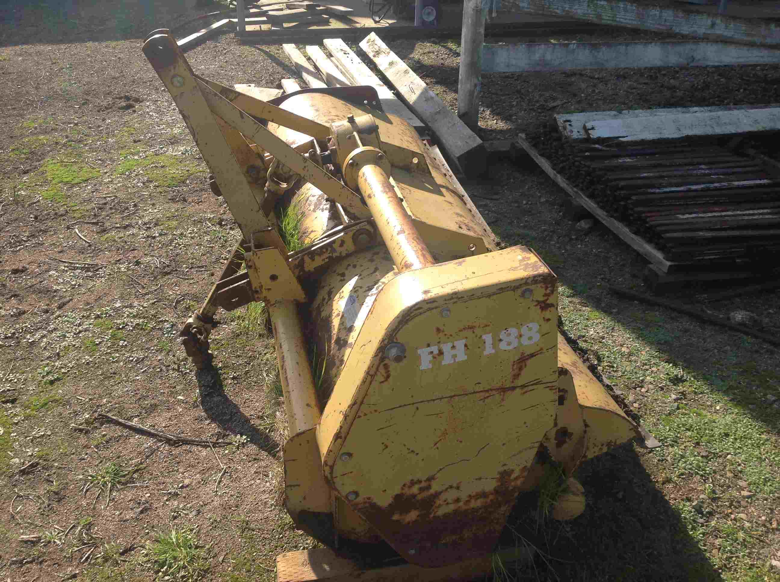

Does your Bush Hog FH174 have the same drive belt arrangement as your Ford 907?
My Bush Hog FH188 looks exactly like this.
And the belt system is the same as below even though I belive I downloaded the pics from a post that said it was a Ford.
Of course mine started out a red color but is now a very shiny blue.

That & maybe all of the older Brush Hog flails are just rebadged Ford flails. Not that it's a problem, I like my Ford 917, other than is 20-30 years past it's prime & beat to **** these days.

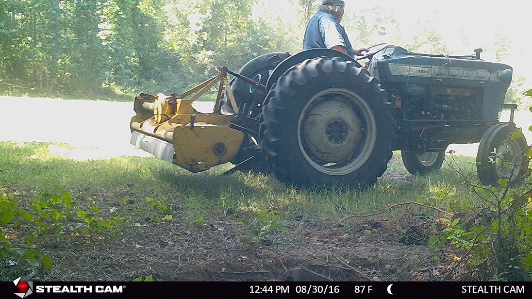

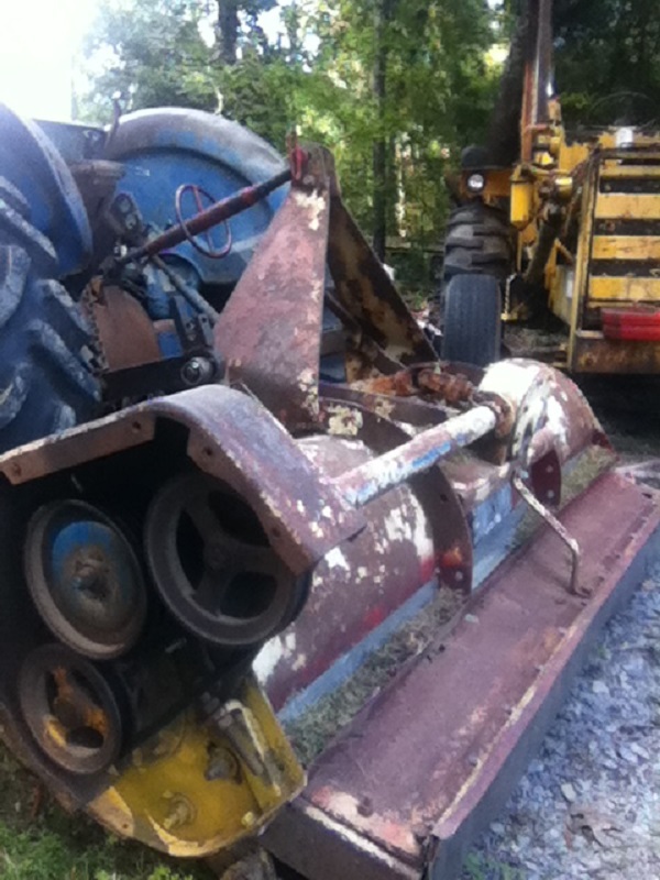

This is the Ford 907 it has 1 "C" size belt.
This is the Mott 72 I use mostly for finish cut. It has 1 "C" size belt and 96 stations = 192 blades.

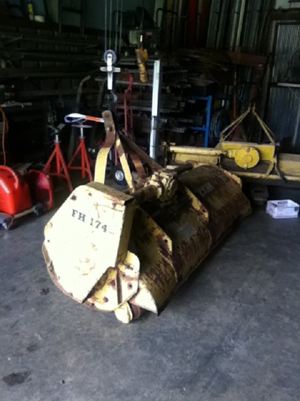

I haven't had time to look at the Bush Hog FH 174 haven't even taken the cover off but it does have the twin belts that are tied together as 1 belt. Don't know what you call them. Here's a picture I took Monday when I picked it up. It was sold as parts only but might be worth repairing. ?? I'll post some pictures of the drive as soon as I can maybe a few days.
