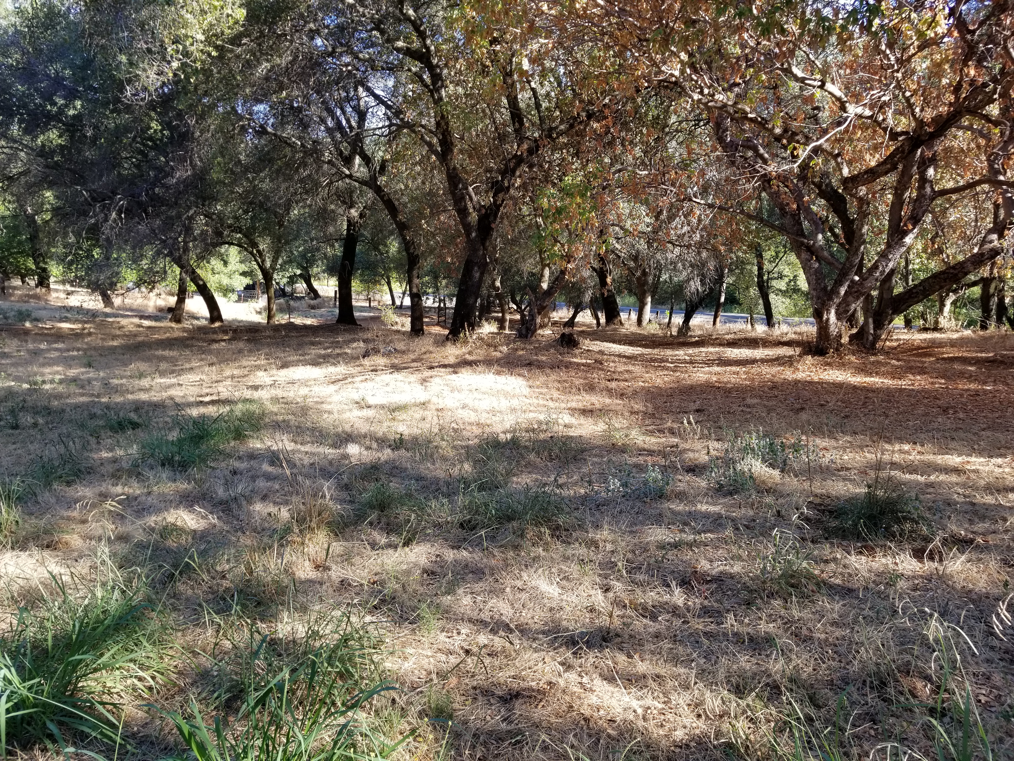

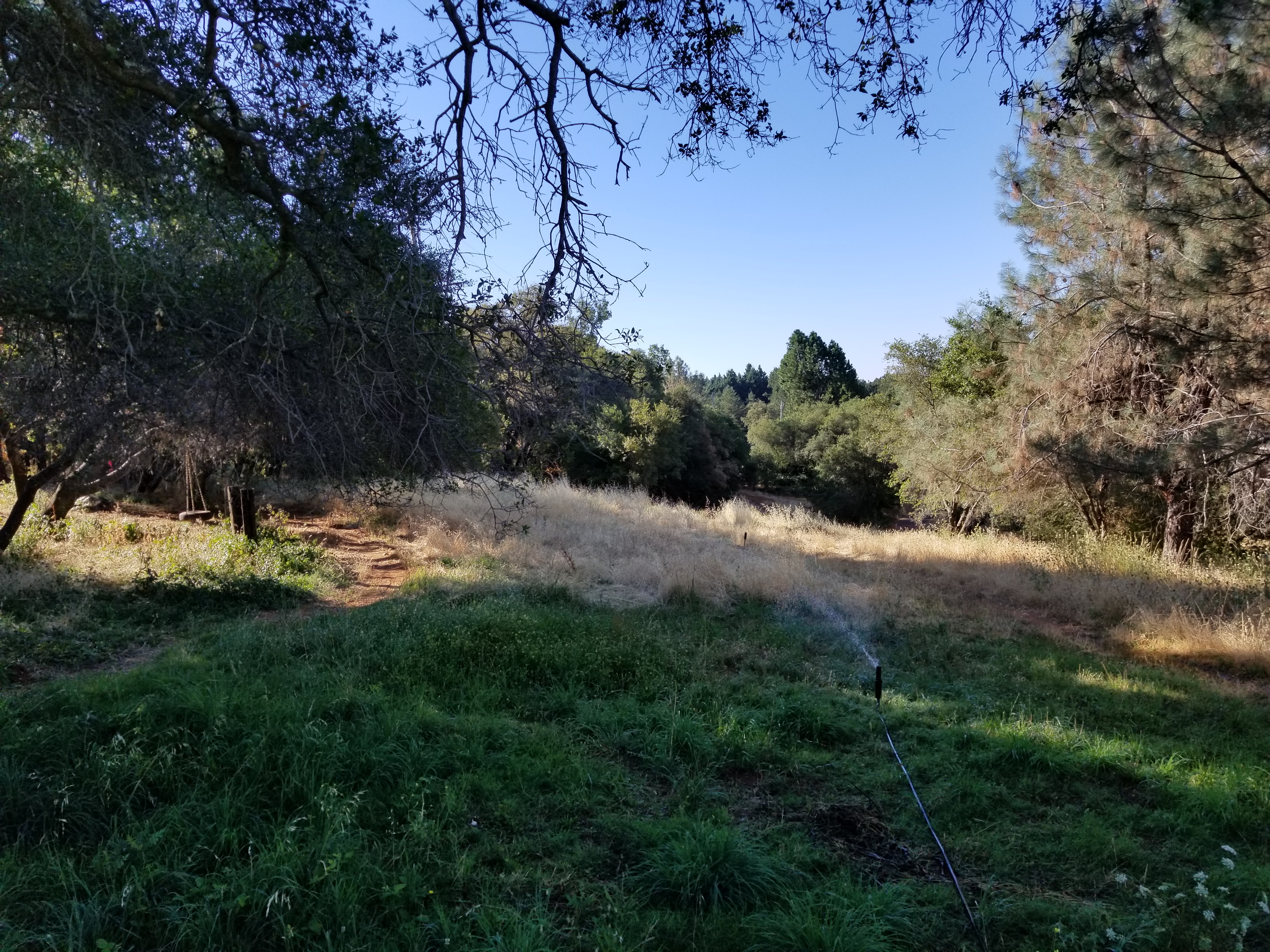

You only have 5 acres and some of it is around the house ... take some pics, post 'em and lets see what kind of ground you really have. It will help us to help you:welcome: to the Flail Nation
This is what most of it looks like. Hard to see the hills in a photo.
This is my most open area as far as having no trees. Again the slope doesn't show well. I can side hill on this but farther down it gets tippy if I don't watch my turns especially if I have a load in the bucket.
In this part of California the grasses all die in summer and grow a ton in spring.
