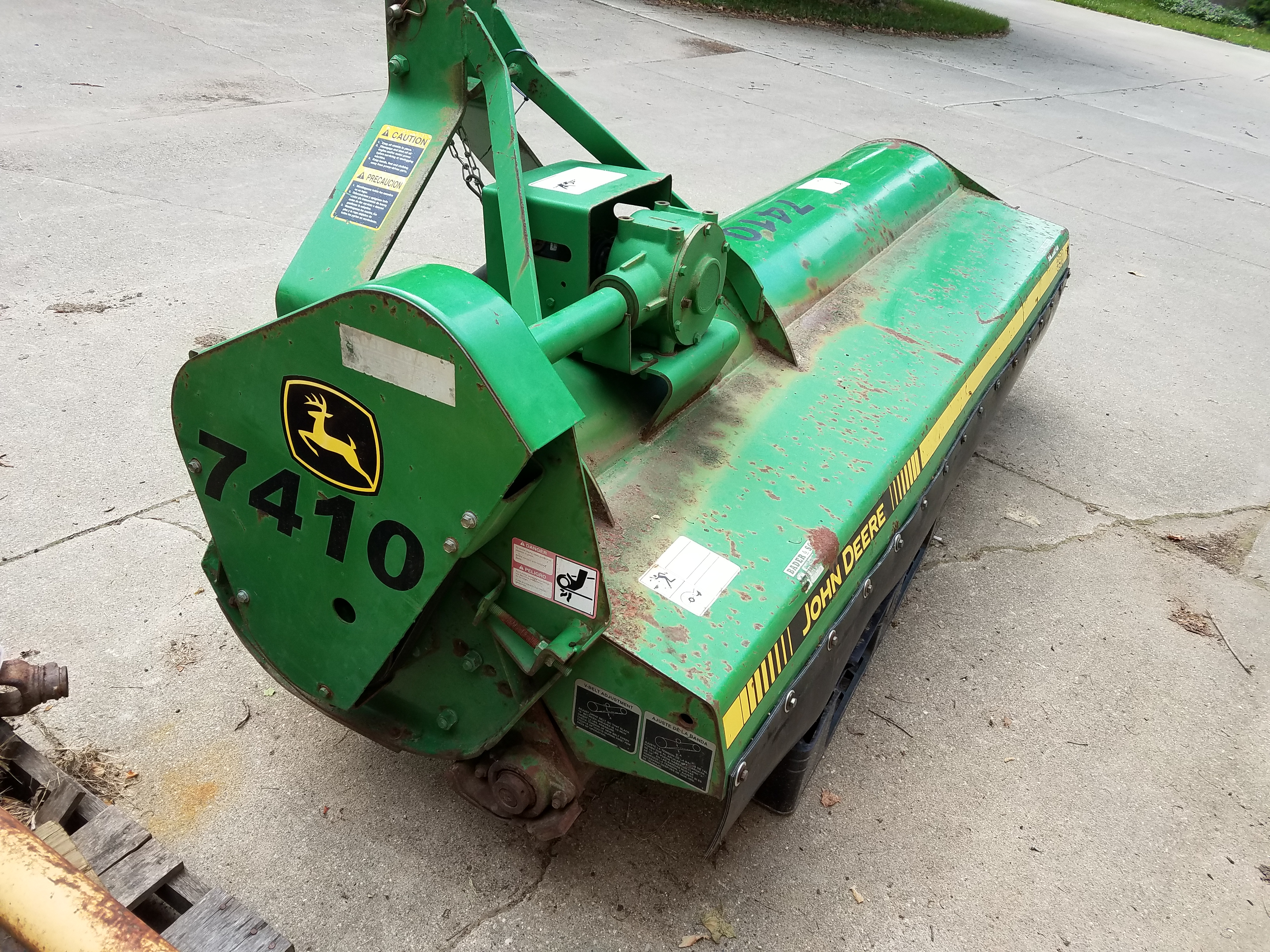

I have a JD 110TLB with 33 pto hp.
I've been using a JD 25A for 4 years with no issues.

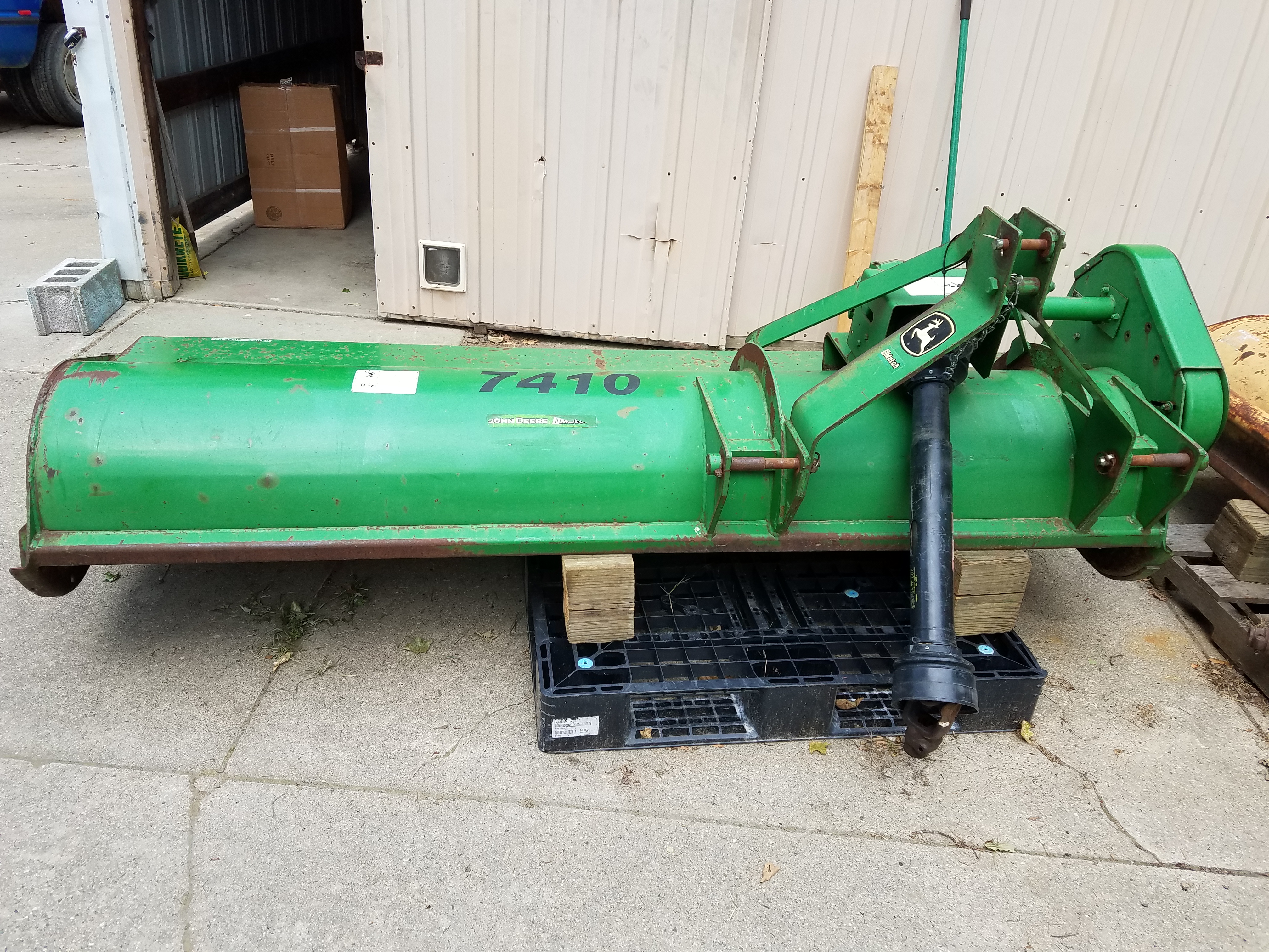

I've always wanted a JD 390 off-set, well I finally bought one from CL.
The JD web site said the Minimum hp is 30, the used manual I bought said Minimum is 40 hp.
It was missing a skid shoe or a Runner as JD calls it

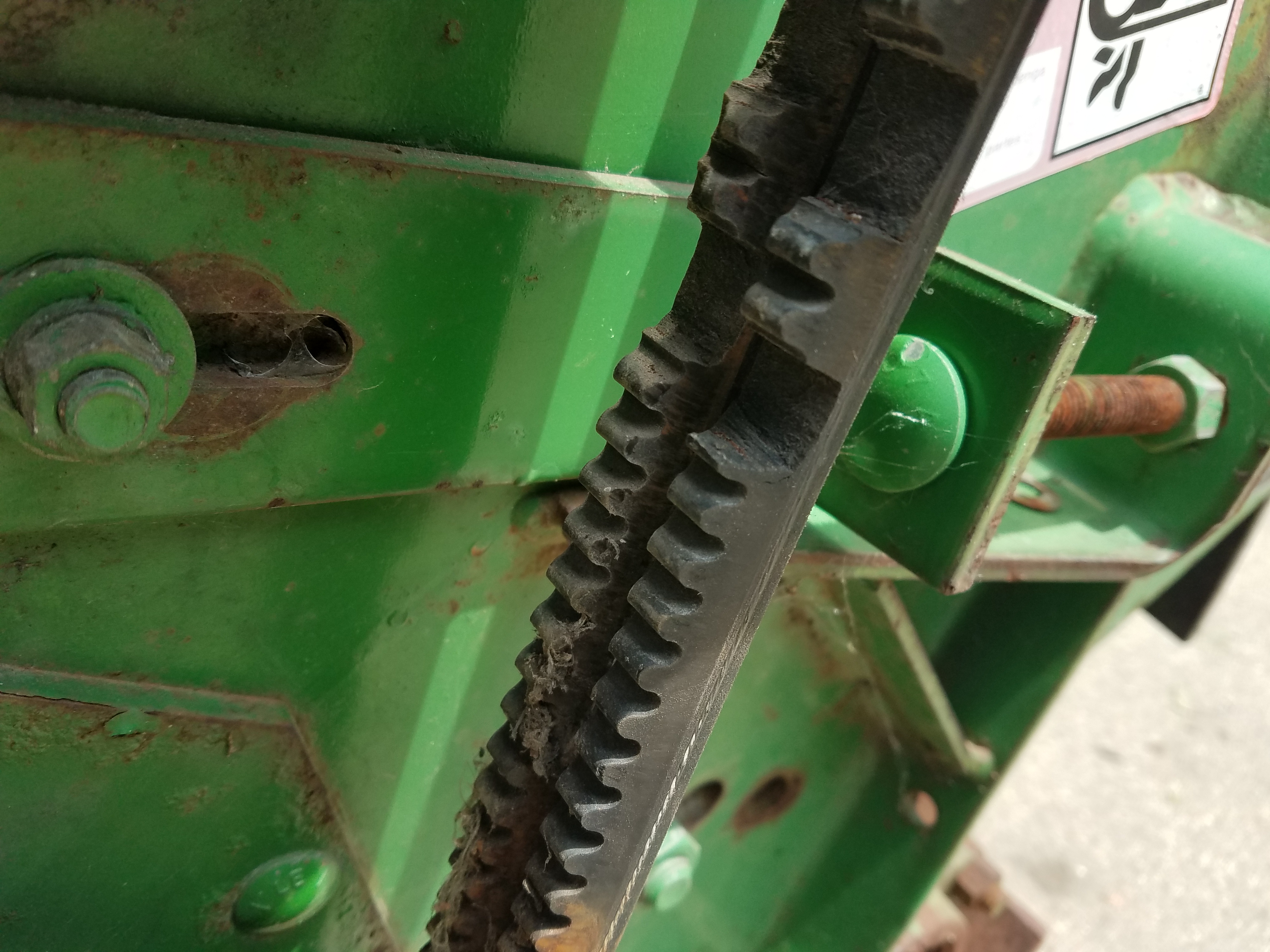

Missing teeth on the v-belt

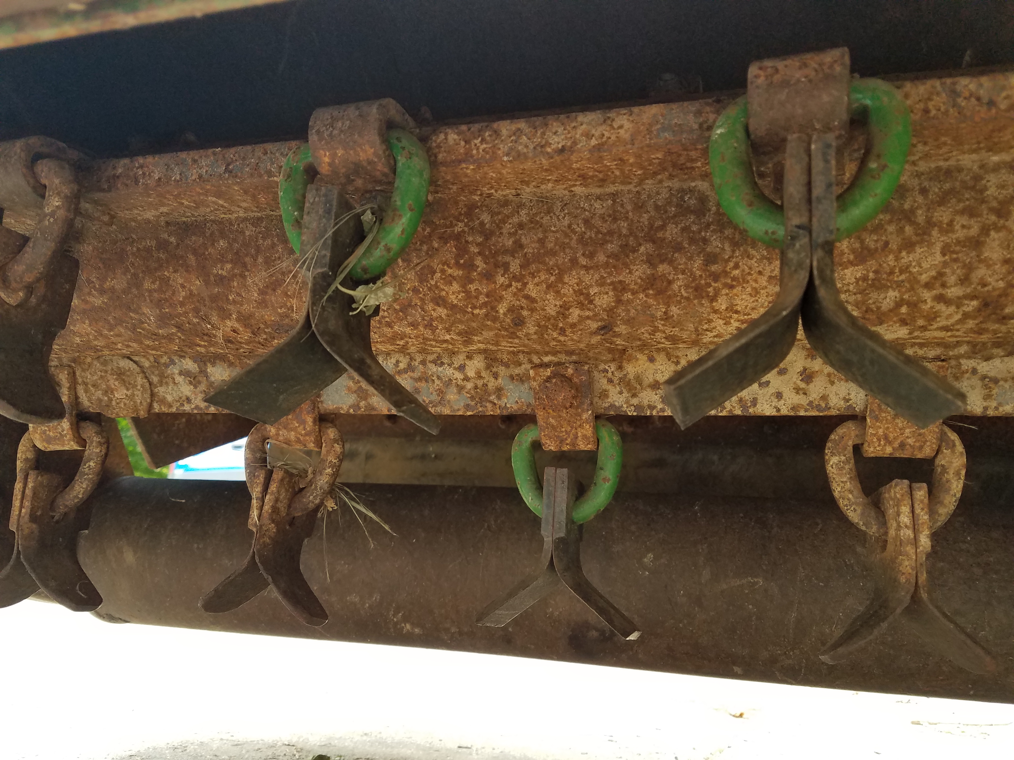

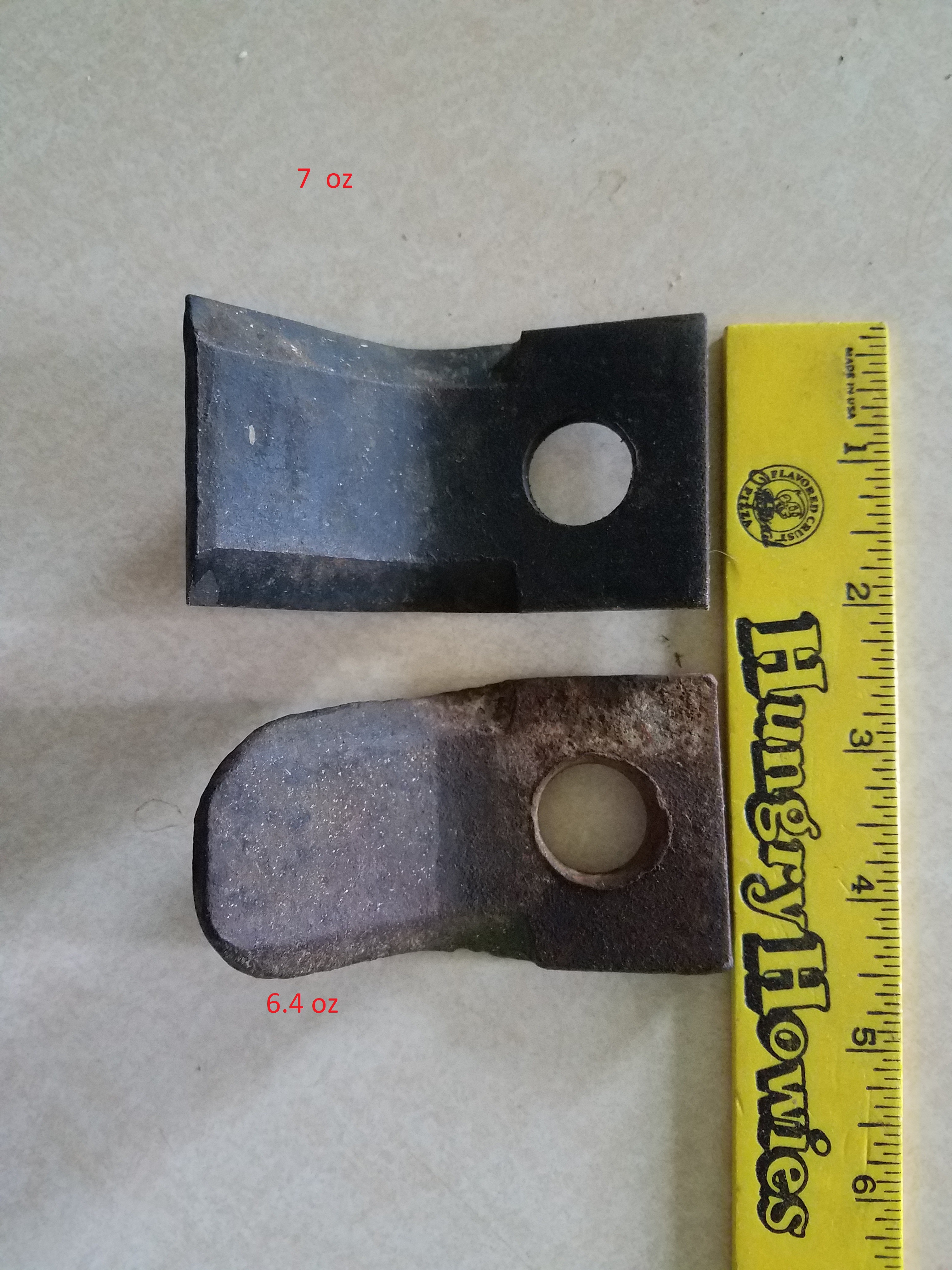

It has 10 new blades mixed in with the old ones, that might be causing it to shake / vibrate.
(new blades 7 oz old blades 6.4 oz)

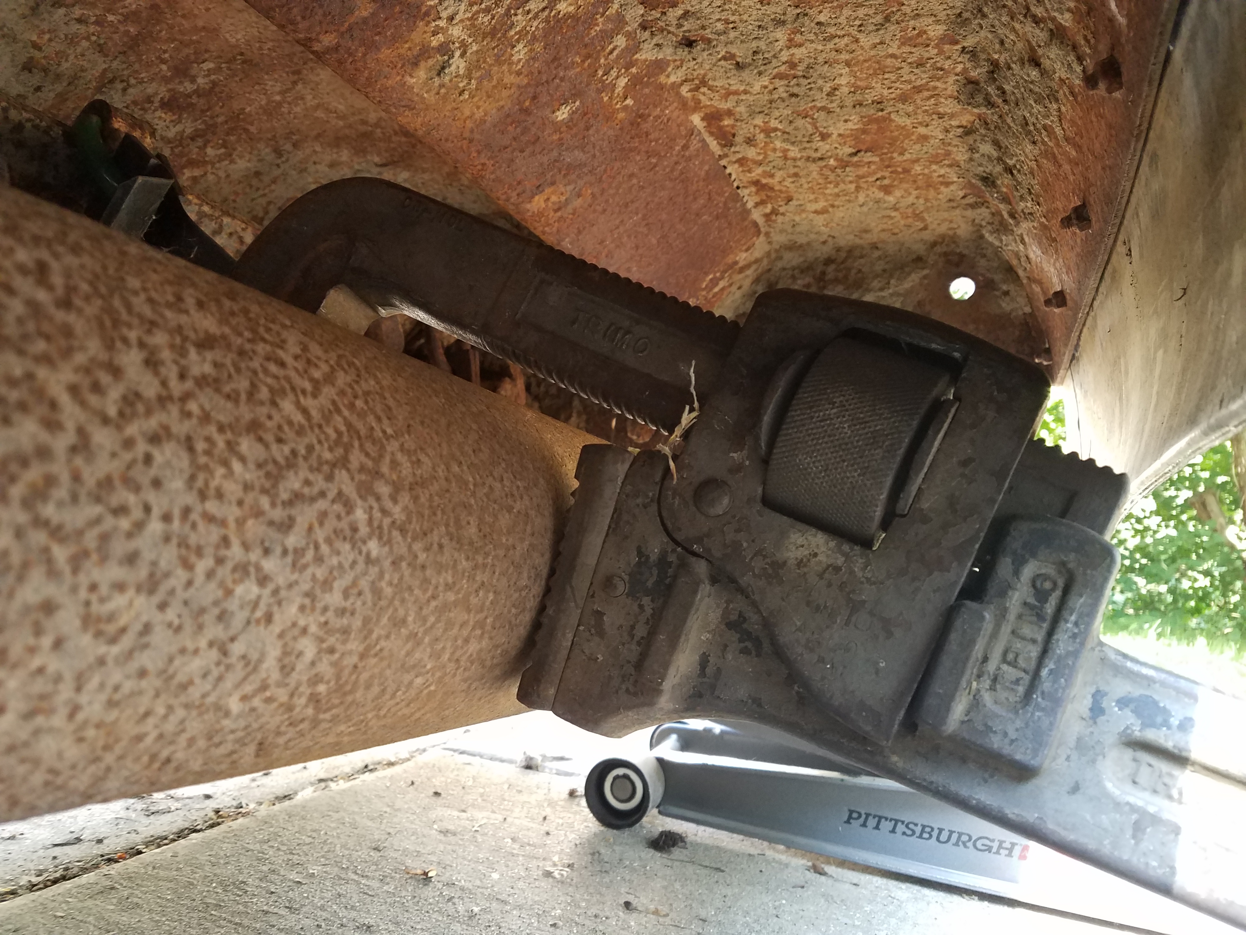

Got it home and found out the roller was locked up. (freed it with a 4ft pipe wrench)

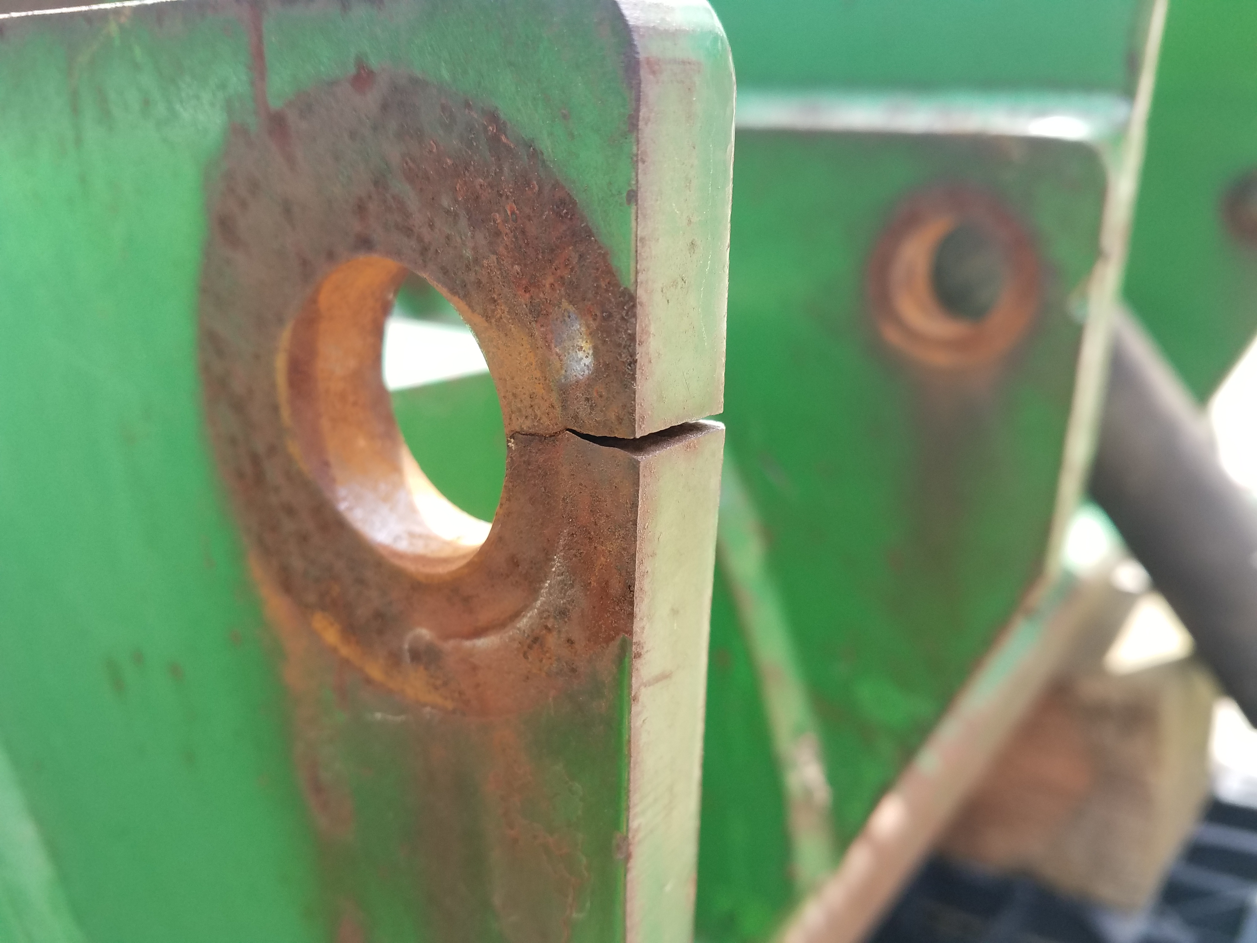

A crack in the 3pt hook-up
Boy do I need a BEER!
