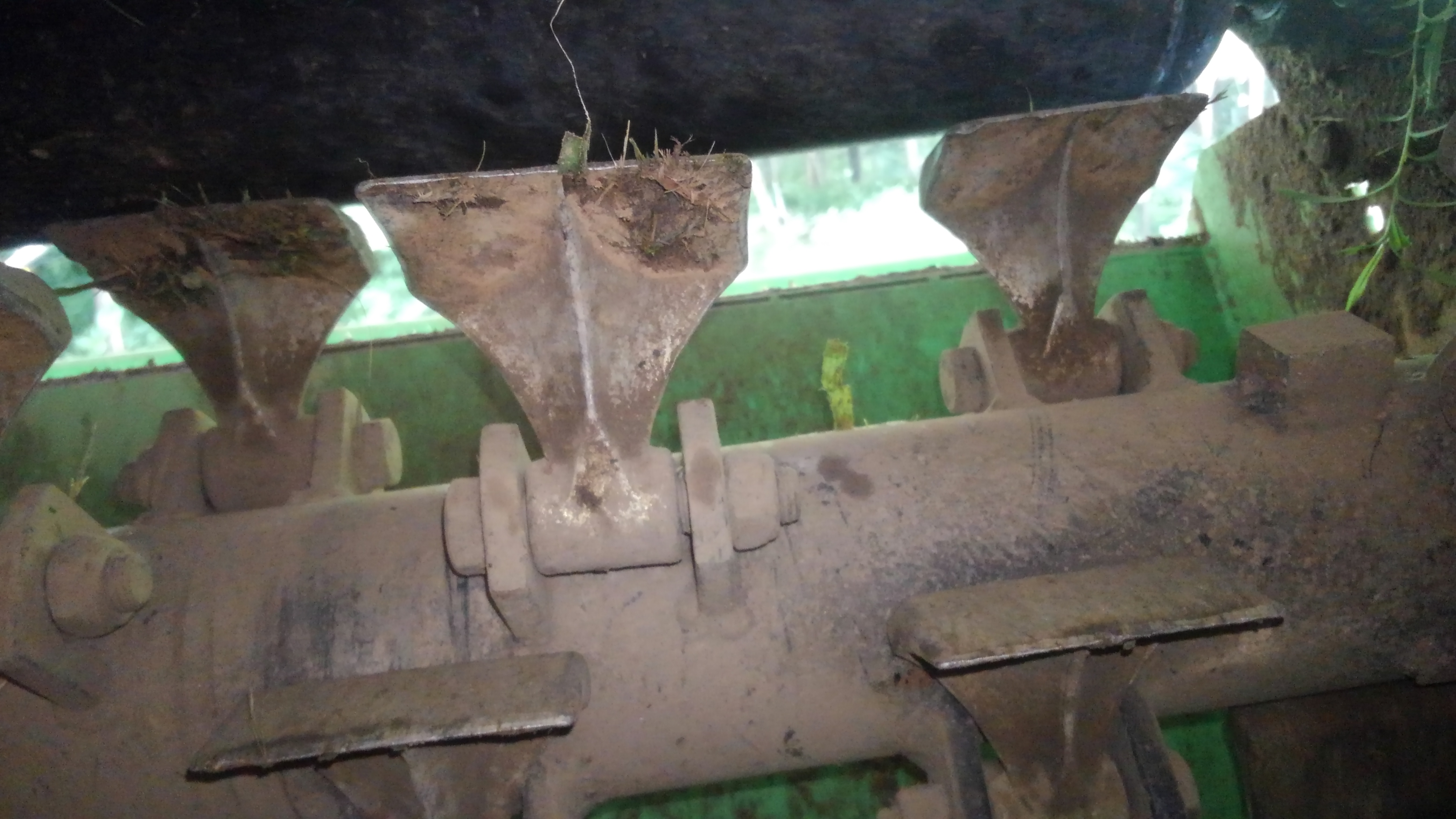

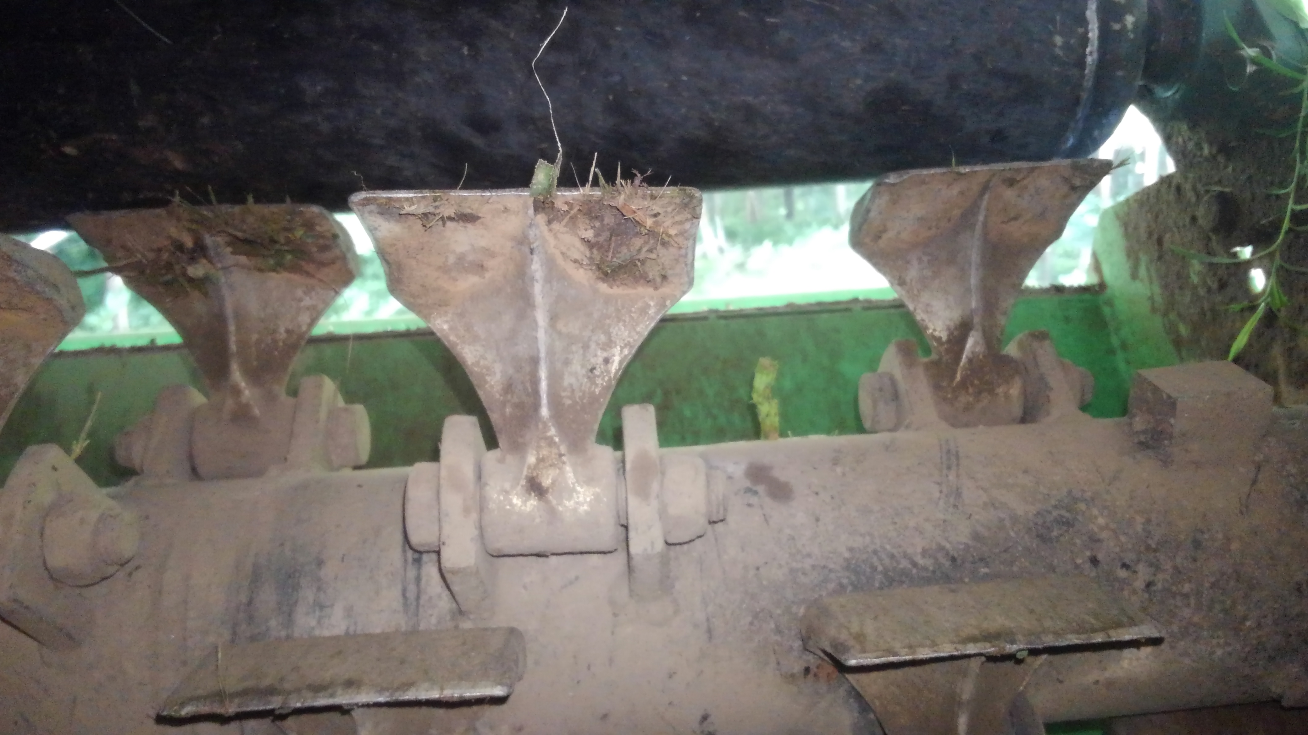

Hey ddbackhoe any chance you can upload a picture of the rotor when you get it together. Also I like how they build that to be front mount or rear mount.
yes, that's mud. I found a new soft spot and a missing chunk of concrete with the new mower. No real damage found after either one.
This rotor has 28 cutters (175 width).
