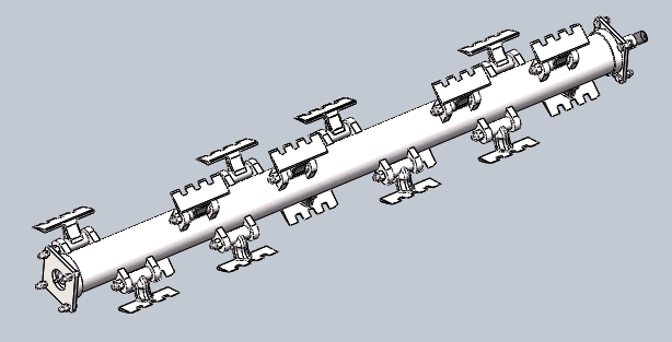

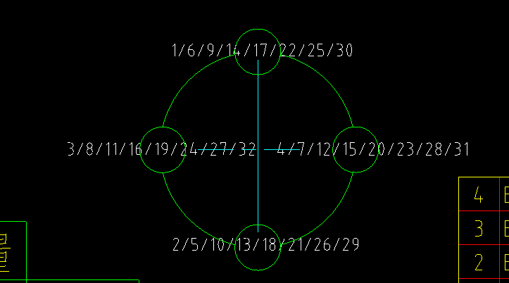

it appears there are only 2 rows of flails on the rotor. Both of my JD have 3 rows of flails.

MFZ has 4 rows of flails on the rotor. MFZ rotor shaft.pngQQ图片20180731133357.png
This is how I define MFZ flail mower, this flail mower is used for grassy terrain, vineyard, brush area, etc. But it is still a flail mower for hobby farmer, not for professional farmer. You cannot use MFZ 5 hours per day like Maschio TIGRE.
I like MFZ type hammer very much, it's good for mow the small branch, and the air pressure it created is still good. I will use this hammer on some of my bigger flail mower which is for tractor more than 80HP.

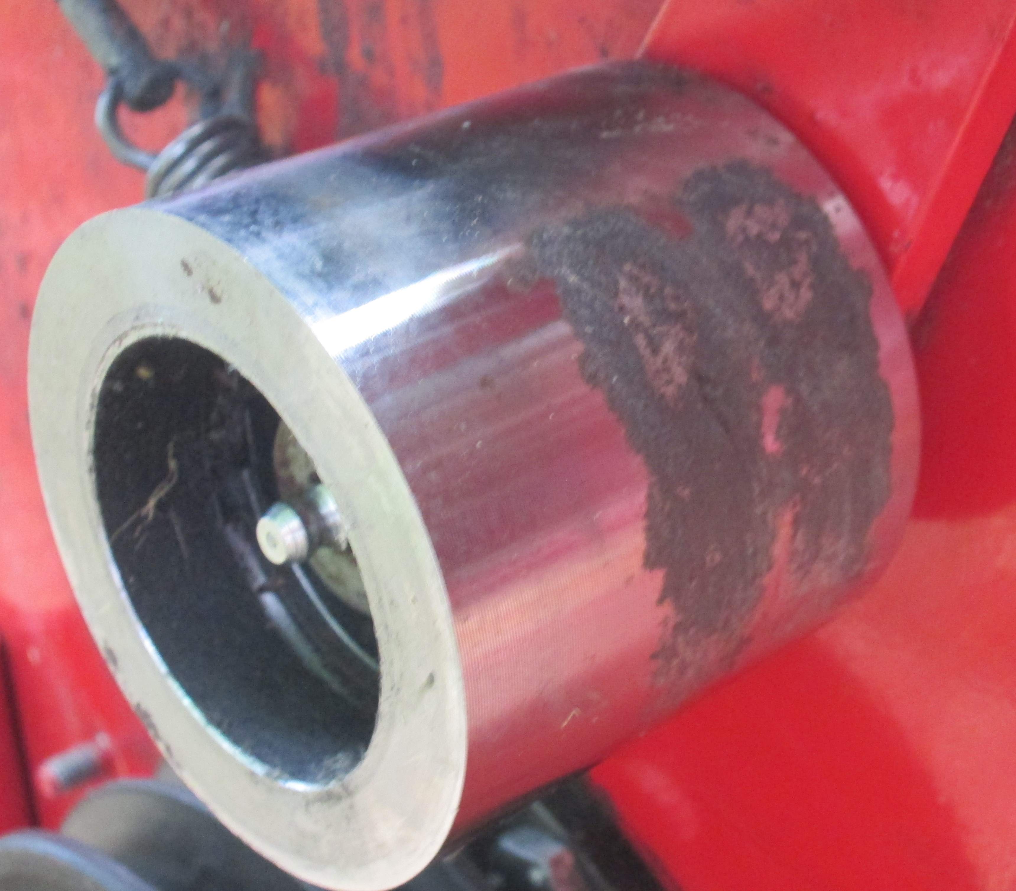

The original belts on my Caroni TL1500 got fried after less than 20 hours. The roller has some black residue on it that I'm trying to clean with acetone, but it's not making much of a difference.
Does anyone have suggestions on how to deal with it?
Razor blade/scraper, or angle grinder with a wire wheel in it (a flap disc might work as well).
