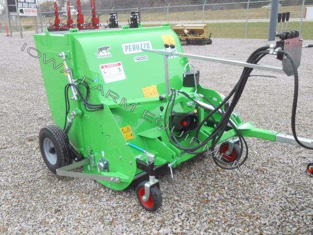

I am trying to help you here, just like I have helped everyone else that wants to invest in a flail mower or has operating problems with them.
They are more worried about scalping when they suggest this method of operation that is all that is about. as it keeps the knife stations that are following the leading pairs of knives elevated and as a result they lose the pressure gradient needed to slice the grass and brush and also reduse the amount of recutting the knife pairs can do by leaving a higher height of cut.
The image of the Peruzzo pick up mower that I have attached to this response shows a pair of caster wheels in the front of the flail pick up mower to prevent scalping and knife damage. If the manufacturers of these things offered front caster wheels as standard equipment in their flail mower builds they would sell many more flail mowers as they would mow better and as a result create better turf as the caster wheels act as an additional aid in maintaining the mowers cutting height along with the rear roller.
The Wessex towed motorized flail mower in the second image can be towed by an ATV/quad bike or an SUV to mow and it has front and rear gauge wheels and does not use a rear roller as it is designed to mow in heavy deep brush.
The Vrisimo flail mowers made in California can be purchased with front and rear casters as an option in just one instance.
The older mott flail mowers had rear casters as an option to aid in protecting the flail mower from suddenly dropping into a depression by nose diving into it if the mower was left in the float position and then causing scalping and knife damage.
