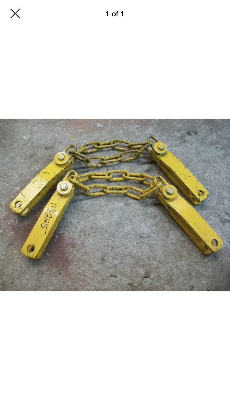

Also interesting was replacing with 3 point connecting arms with chains so they float. I always wondered why some tractors had connecting arms that you could pull a pin to enable them to float float.

What model tractor do you have that the 3 point doesn't float?
Can you post pictures of your chain setup?

It is more that the one arm can float independent of the other so the mower can twist sort of independent of what the tractor rear wheels are doing.
Here is a picture of a pair on ebay.

Ok, now it makes sense :thumbsup:.
