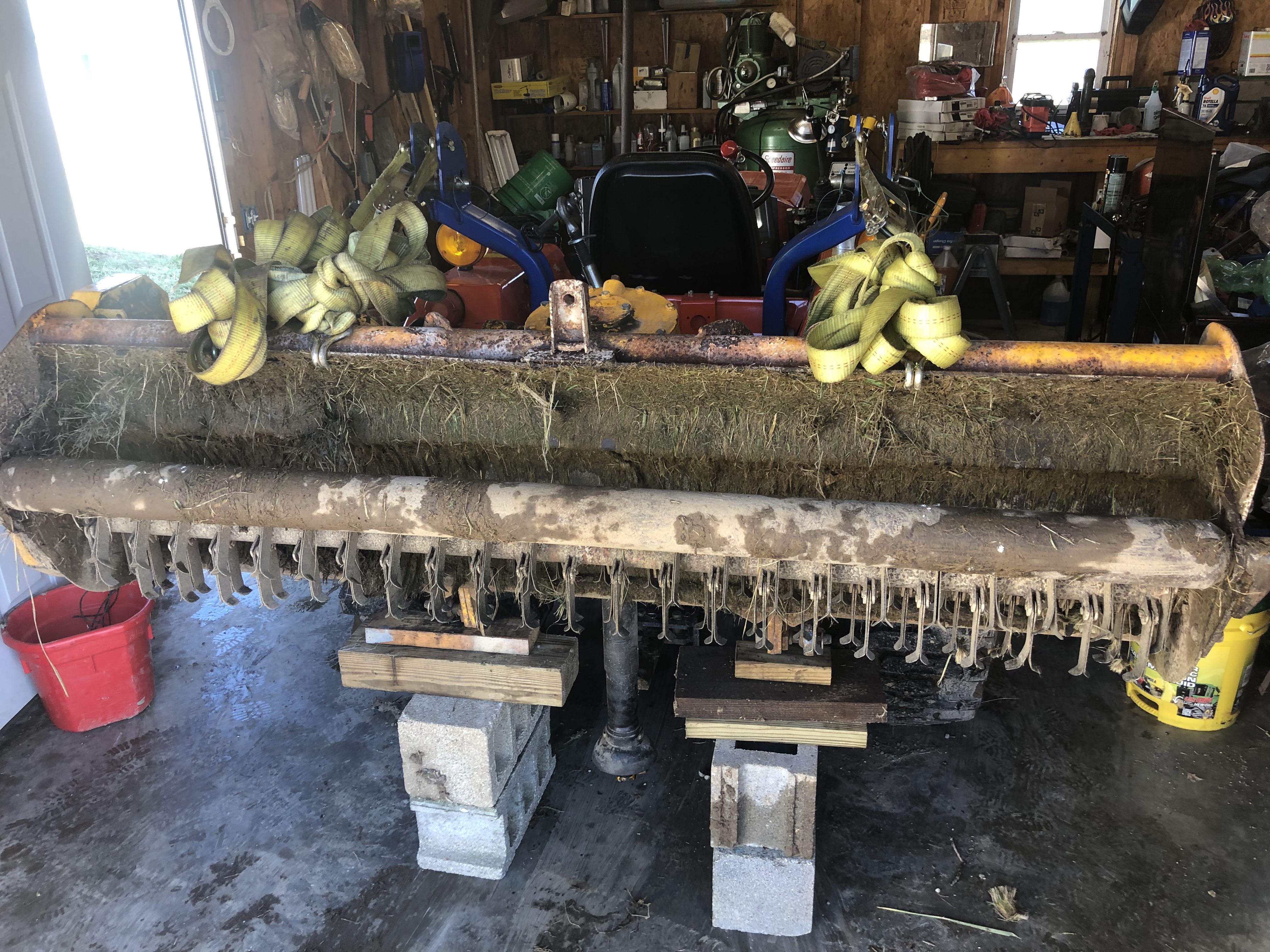

4-1/2 replacement blades and a belt (plus a gearbox fluid change and hit the grease fittings) and I’m looking forward to the grass growing.

I've read about forward and reverse rotation on this thread....
Does anyone that has or has used a Mott fine cut flail have any input if reversing the rotation makes any difference in cut quality. The Chinese Flails for sale online advertise that they run reverse rotation for a better cut.
Apparently you can reverse the cut of the Mott 72 by changing the drive belt to the right side of the mower. This must have been engineered into the design of this mower for some reason or use.

   / Let's talk flail mowers #5,618
The Mott 72 cuts great as is. When you reverse the rotation it will fling the clippings forward toward the driver's seat.

I’m trying to figure out why Mott would bother making it reversible. I know the smaller ones were reversible because they were intended for some of the smaller import tractors that had a counter-rotating PTO shaft, and others were made for 1000 PTO as some of the older Kubota had dual speed PTOs.
   / Let's talk flail mowers #5,620
Hello retiredfarmer,
You may want to back the tractor and mower out and back it in as your going to be working on it for a while and I don't think you want the tractor held captive by the mower.
They reversed for roadside mowing; they did not want any possible objects being ejected and thrown at an incoming car if the mower was elevated/riding over low spots that had debris sticking up in the mower path.
