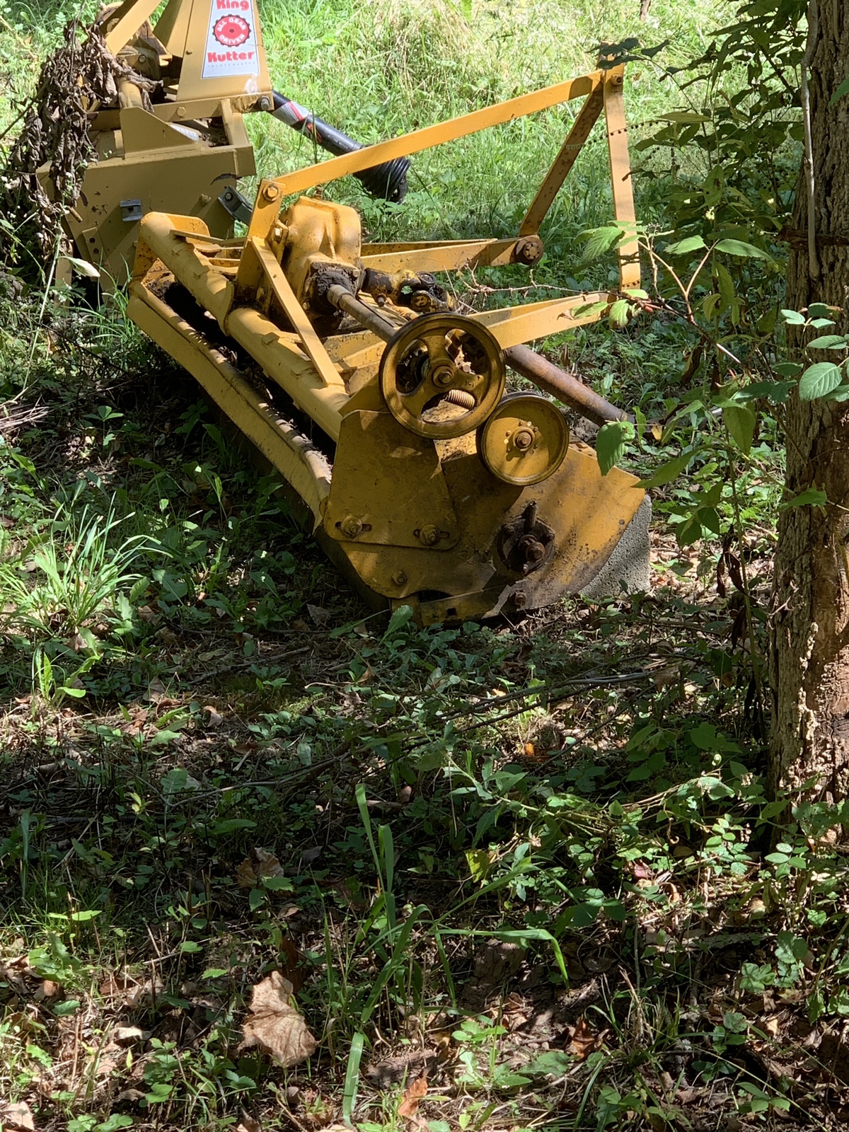

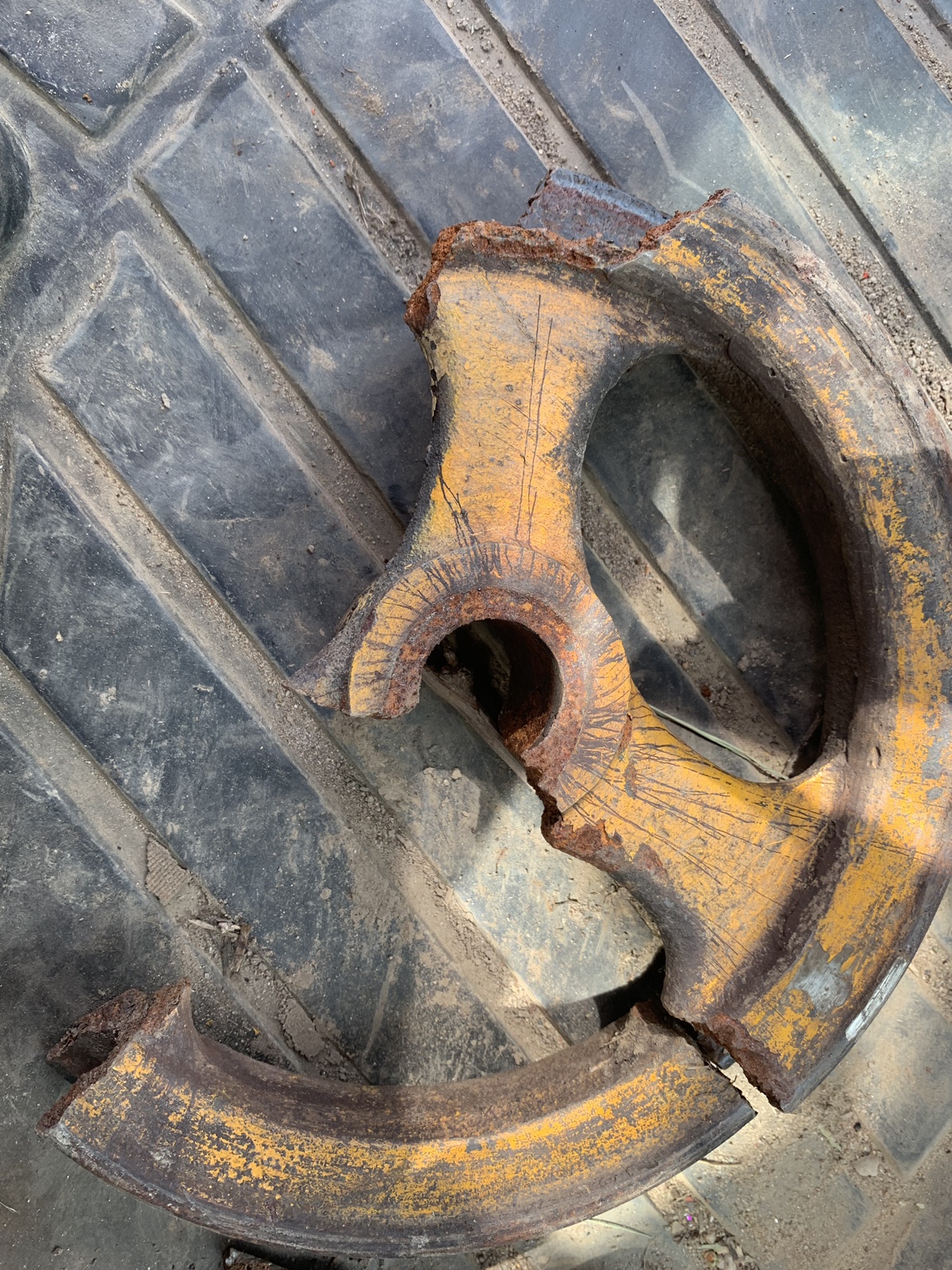

IMG_2728.JPGsomethings wrong with this picture
   / Let's talk flail mowers #6,337
Missing a pulley ... I was using it a month or two ago and it stopped working. As I went to put a new belt in because the old one broke, I realized the cutter shaft pulley was missing. I just found the pulley.....
   / Let's talk flail mowers #6,338
Ouch. You'll find the rest of it when you get the flail running again.
