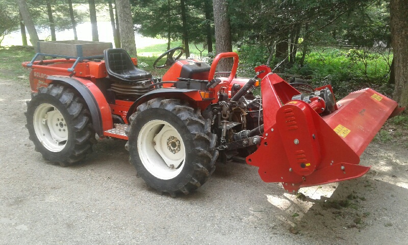

The right way is to have the mower in front of the tractor.
