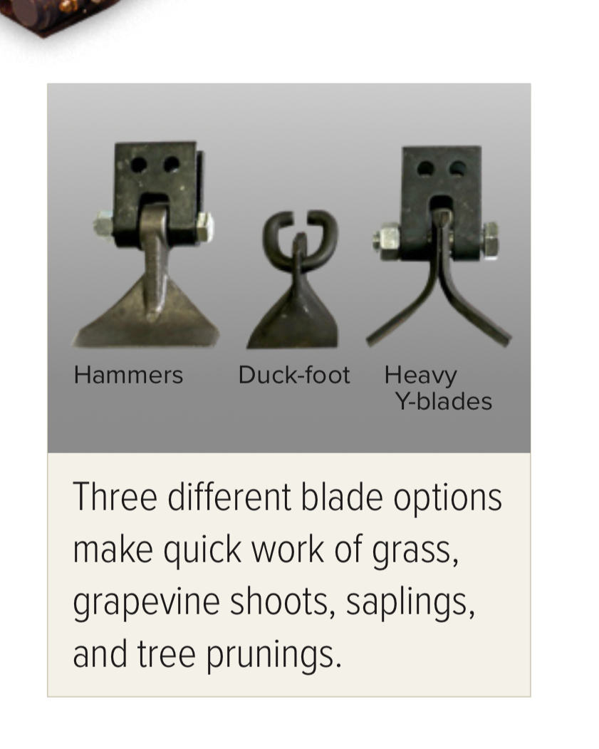

A quick check on the spec's for the Titan 72" for minimum 30 pto HP. I have a 60" WoodMaxx, I could run it very well with my 22 PTO HP when it had Y blades. Switched to Hammer Blades. Takes a lot more HP to run this type of blade. I find tractor will bog down cutting with the hammer blades in area's where the Y blades did not.
Thanks ronjhall! I知 not looking for a finished cut, but did the Y blade cut look decent for grass/lawn? Also, why did you decide switch to the hammer blades?
   / Let's talk flail mowers #6,395
When I used the Titan hammer blades I didn't like the quality of grass cut when compared to a multi blade rotary mower. It did work great on brush
What did the Titan cut look like? Was it just rough or streaky?

It appears I have my blades and their intended purposes mixed up (which I think steams from all the different manufacturing recommendations out there). What would you all say the intended design differences between the Hammer, Duck-foot, and Y-blades?
I'll take a picture after I cut my lawn again. Probably tomorrow evening. Otherwise there is a picture somewhere in this thread showing the "V" shape the Y blades leave.
Not who you are asking, but I'll answer. The Ys on my old 719 cut field & pasture great. You could have probably cut a lawn with it & looked fine. I upgraded to the Peruzzo with hammers for brush. I only do pastures & fields or even less developed areas so handling bigger material, trash & what not was mor important to me than cut quality. The Ys would cut finger sized woody material well, but any bigger than that & the knives would just bounce. It would get noisy & just strip the bark off.
The Peruzzo & hammers will eat trees & branches up to wrist size easy if I have the HP. The hammers do fine on grass too. Again I could probably even do a decent job on a lawn if the whole setup weren't 8,000lbs. I thought my hammers were getting a bit dull & needed spares anyways, so just got them in. The new ones are pretty dull as well, guess I never paid attention to the original ones sharpness when new. They still cut well.
