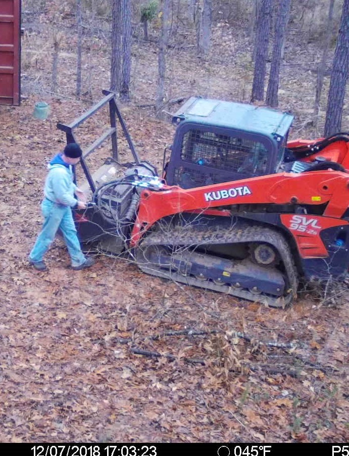

Owner is reclaiming the hill pasture adjacent to me with a forestry chipper mounted to the front of a tracked compact loader. Basically a flail mower on steroids. I had never seen a front mounted flail until today. It might be useful on my hill farm.
   / Let's talk flail mowers #6,414

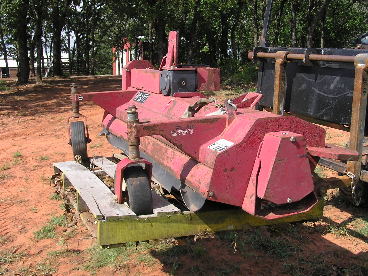

I'm doing the same. I have a JD MH60 mounted on my high flow Kubota SVL-95. Mulcher.jpg
I run the mulcher through everything before the first mowing (new property), before bringing my mower out. We logged some areas (thinned) two years ago, so lots of hidden stumps. Mulcher will grind a 12" two year old pine stump gone in about 5 seconds. Levels everything nicely, and wipes out anything which could be hazardous to my tractor or FM2572 Flail with hammers. But, the hammers on the flail are pretty tough in their own right. If you have lots of trees, a flail with hammers is really nice to have. I really thought hard about the hammer vs. other types of tools. Very happy with the hammers...really nice on mulching up sticks and branches.

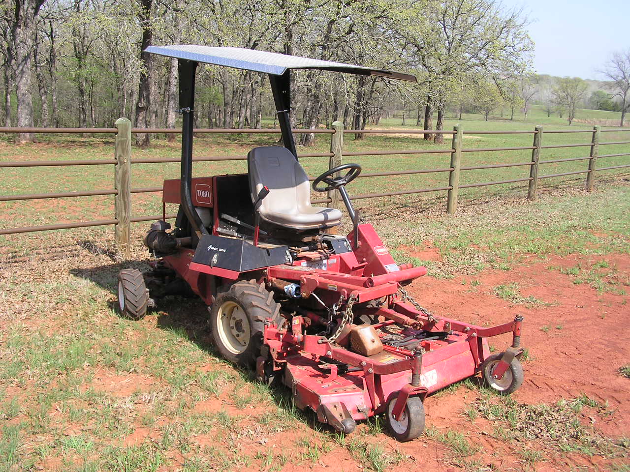

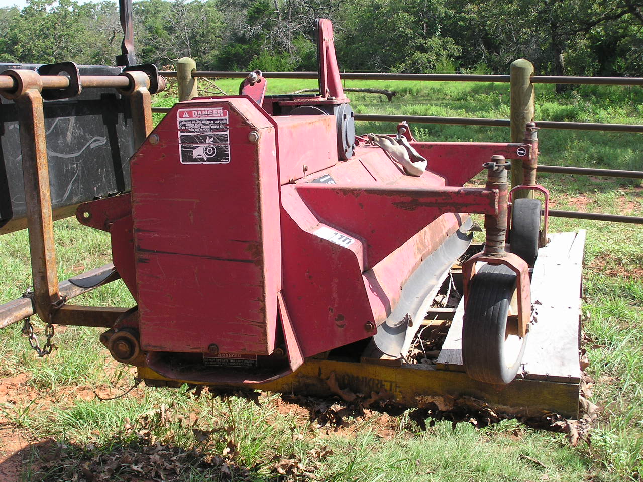

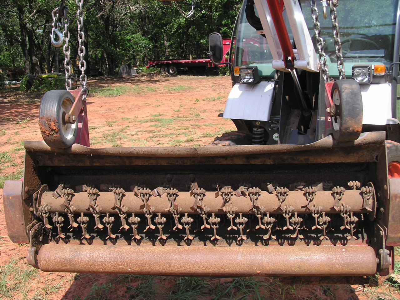

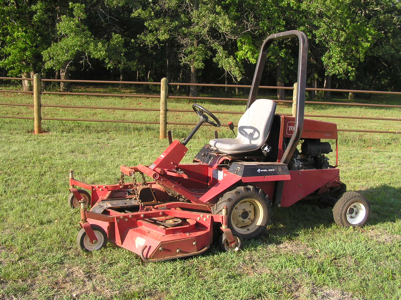

Here is my 5' front mount flail:
It goes on the TORO in place of the 6' rotary deck:
Or the smaller 54" rotary deck:
